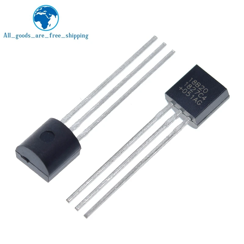

Using DS18B20 would be a great idea but using 28 sensors in pack is a bit overkill.
In my current setup I have 12 banks 14S 42P each. in order for me use those sensors I would need a lot of them
If my calculation is correct I would need 168 sensors / bank , 2016 sensors for all banks. Given that one sensors sell for around 1.5 Euro in my area the total amount would be 3000 euro. Sampling 2016 is a big challenge.

I had just a quick look on alibaba for buying the DS18B20
I just found a very low price: about 10ct/each
So if I would calc with 28 pcs / powerpack it will be a very small amount of money, even if the would be a lot more expensiver than 10ct / each
Here on Aliexpress:
5 pcs for 1.72€ with 1,87€ shipping to germany (above 10€: shipping is free)
That means: 6x5pcs = 30 ds18b20 (6*1,72=10,32€ (free shipping)
That’s a very small amount for much more safety in a powerpack with 100 batteries.
I anyone needs a huge amount of ds18b20 you can buy them on Alibaba as well :slight_smile:

Just be certain that the DS18B20 sensors are genuine parts.
Ds18b20 and emonTX3CM firmware - post 78 in particular.

They are not for me. I did a fire test with the custom enclosures i made and issues. If you want custom enclosures i can help you.
Did you actually test them? If so consider yourself lucky. I have a drawer full of these beasts too, and their accuracy is abysmal, some of them randomly lock up, on others I had to fudge the 1wire timing to get them to run reliably. Now I don’t care whether these things are 0.5K or 5K off when considering batteries, but the other problems are more debilitating.
For “heap of thermometers” applications I’d recommend a simple 10kOhm thermistor, a CMOS multiplexer or two, and an ADC. Put it all on the I²C bus you most likely have anyway, done. Alternately you can use a temperature-to-voltage chip like the MCP9700 (20 cent) or a temperature-to-I²C one (50 cent).
1wire is not nice IMHO because if you bit-bang the protocol you need to block interrupts while you’re talking to the things.
I think, if this will result in including to a project, I would do a sample ordering to check the delivered quality.
