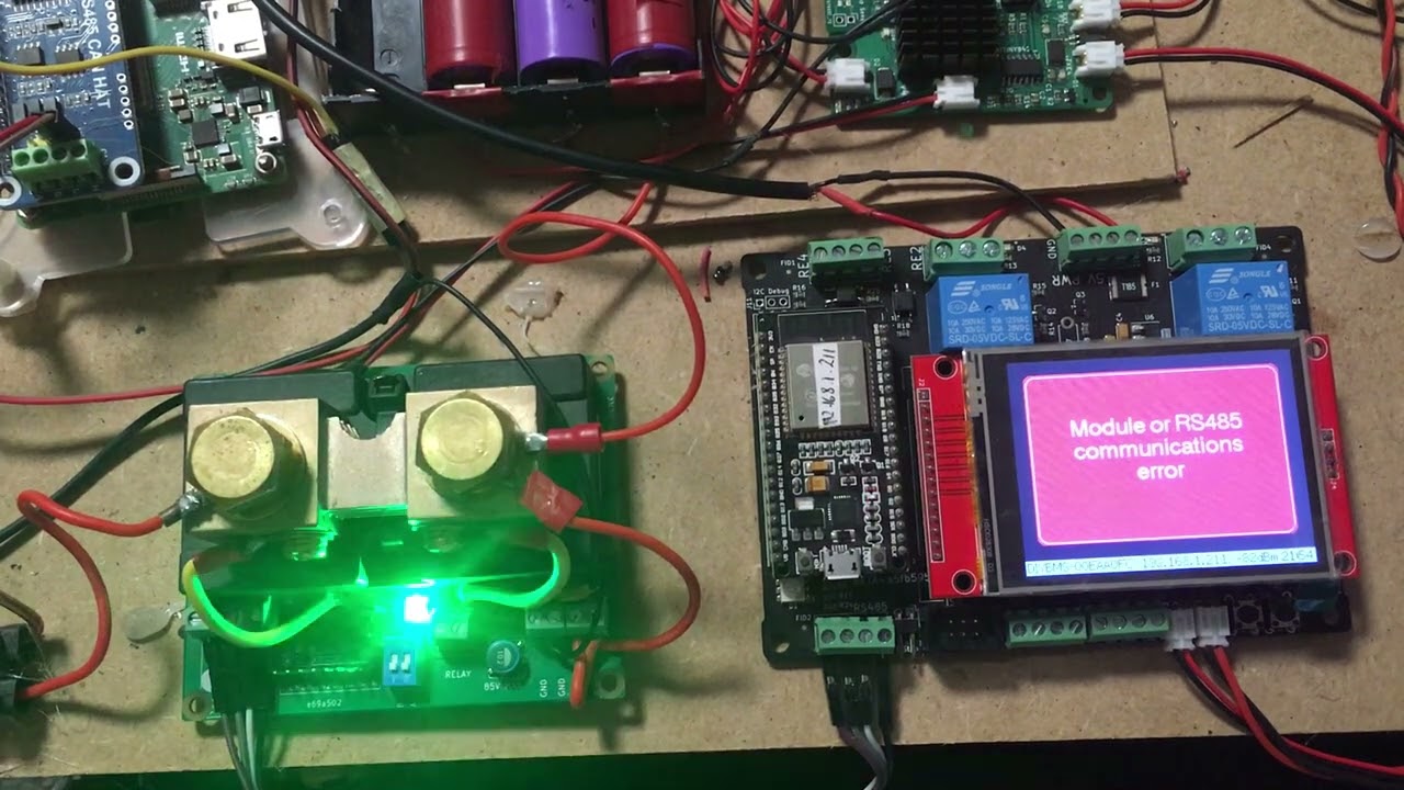

I have a problem with RS485 communication.
I was going to do some test in my test panel and I got this error. Let’s see if someone can help me with the shunt flashing sequence. I put a video
thank you.

The flashing light sequence looks normal for the current monitor.
Are the modules working correctly? The message also relates to bad comms with the modules.
That depends on your router. It should offer a way to assign a fixed address to the ESP32’s MAC.
True, the message could be an error in modules or shunt, but if I remove the shunt or if I simply deactivate RS485 communication in the controller, the error message disappears, so I have ruled out an error in the modules. I’ll try new cables tonight just in case.
