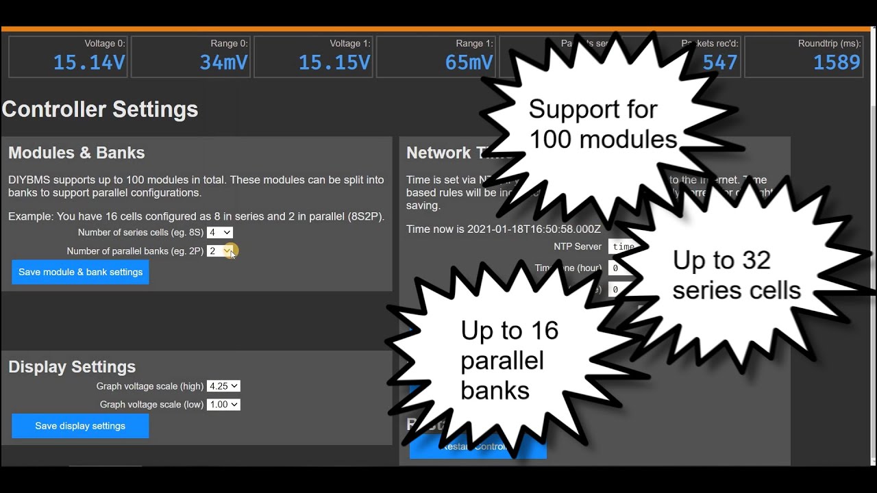

Hi everyone, I’ve just published a new video on the latest changes and updates on the new controller and shunt.

I would love it if when looking at the main screen, clicking on one of the bars in the graph actually took you to the details on that cell on the modules settings page.
