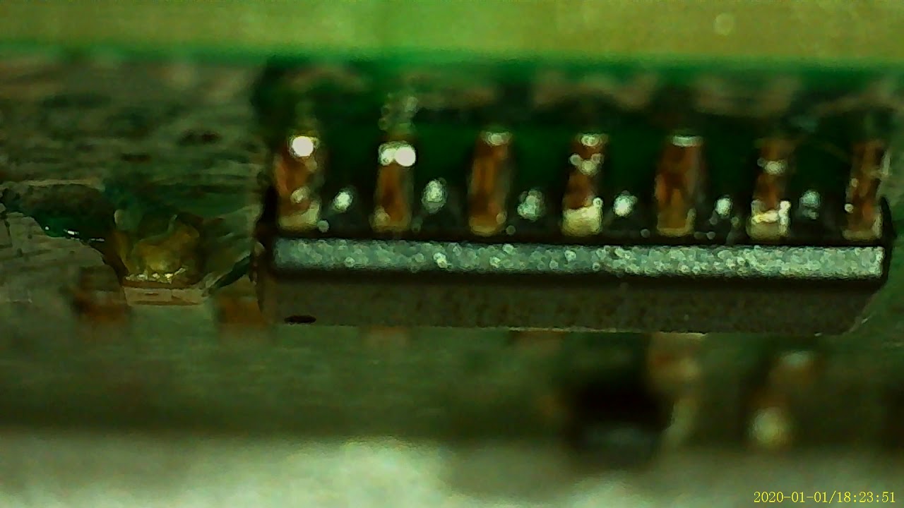

Hi, if you have built 30 modules and 2 are not working as expected then there must be a bad soldering joint, do you have a magnifying glass?
If the voltage is wrong and no temperature reading it suggests that it’s the voltage reference chip.

Thanks Stuart, it didn’t look like it, but there was indeed an Attiny pin on each of the modules with bad contact.

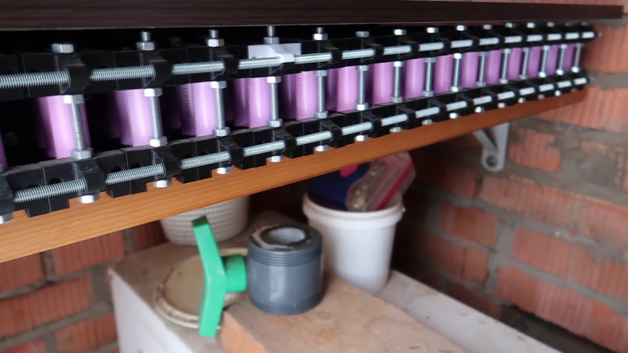

So far I am pretty impressed, I moved my nissan leaf batteries to my shed, and although I am still waiting for a half decent solution to charge my test setup, things look pretty good.

wow! That looks really good. I am planning to make a tree 6p13s packs. If that works well, I’ll make another 3x 6p13s config. As the cabling is a lot of unnecessary work and the stacking looks really good, I’m wondering if we can make a stackable version that automatically connects Data between the stacked modules. Even more helpful would be if one of the battery contacts could also be passed between the stacked modules, so that we’d only need one contact/plug for each cell in series
Just to repeat what’s been mentioned before, the modules are designed to be as near to the cells as possible, using short power wires to keep resistance low.
