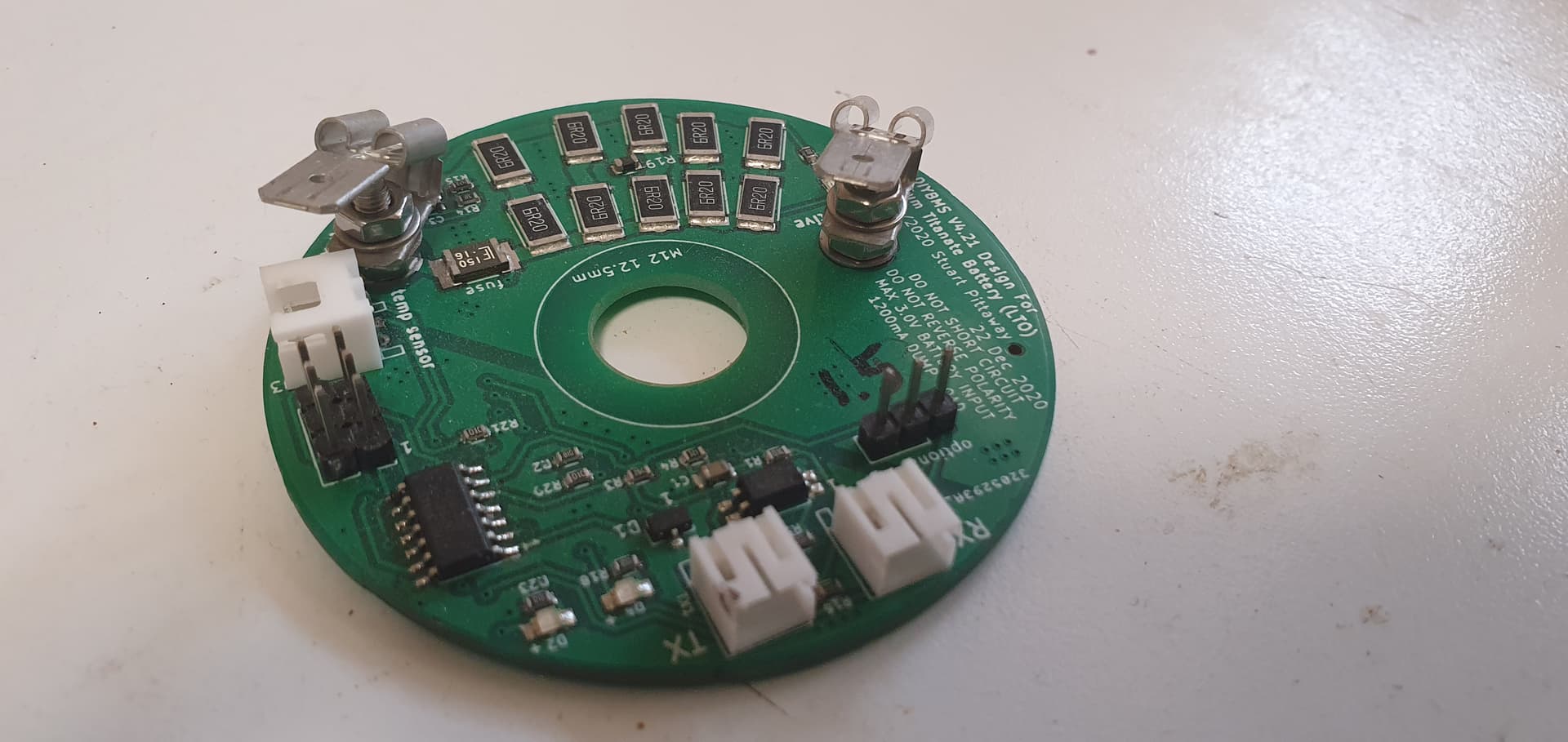

DIYBMS for Lithium titanate battery cells (LTO)
Close up views of round 66160 bms boards, I am running the esp32 controller
Close up views oround 66160 bms
ESP32 running the round LTO 66160 boards

There is no one making these boards ready made, you will have to build them yourself, JLCPCB will build the board with all the components soldered except for any components that are not in stock like Attiny841 and terminals, the order that is in previous post show the details of the soldered components and position of components

Being a DIY BMS I think the only option is make them yourself from the download files on this site as there is little demand for LTO batteries due to cost it then becomes a supply as you need them, these are not for profit under it’s licence making, so making them yourself is the only option.

Mine screw to the battery stud with a nylon washer each side and a M12 nylon washer, the PCB is not electrically connected to the battery stud.
