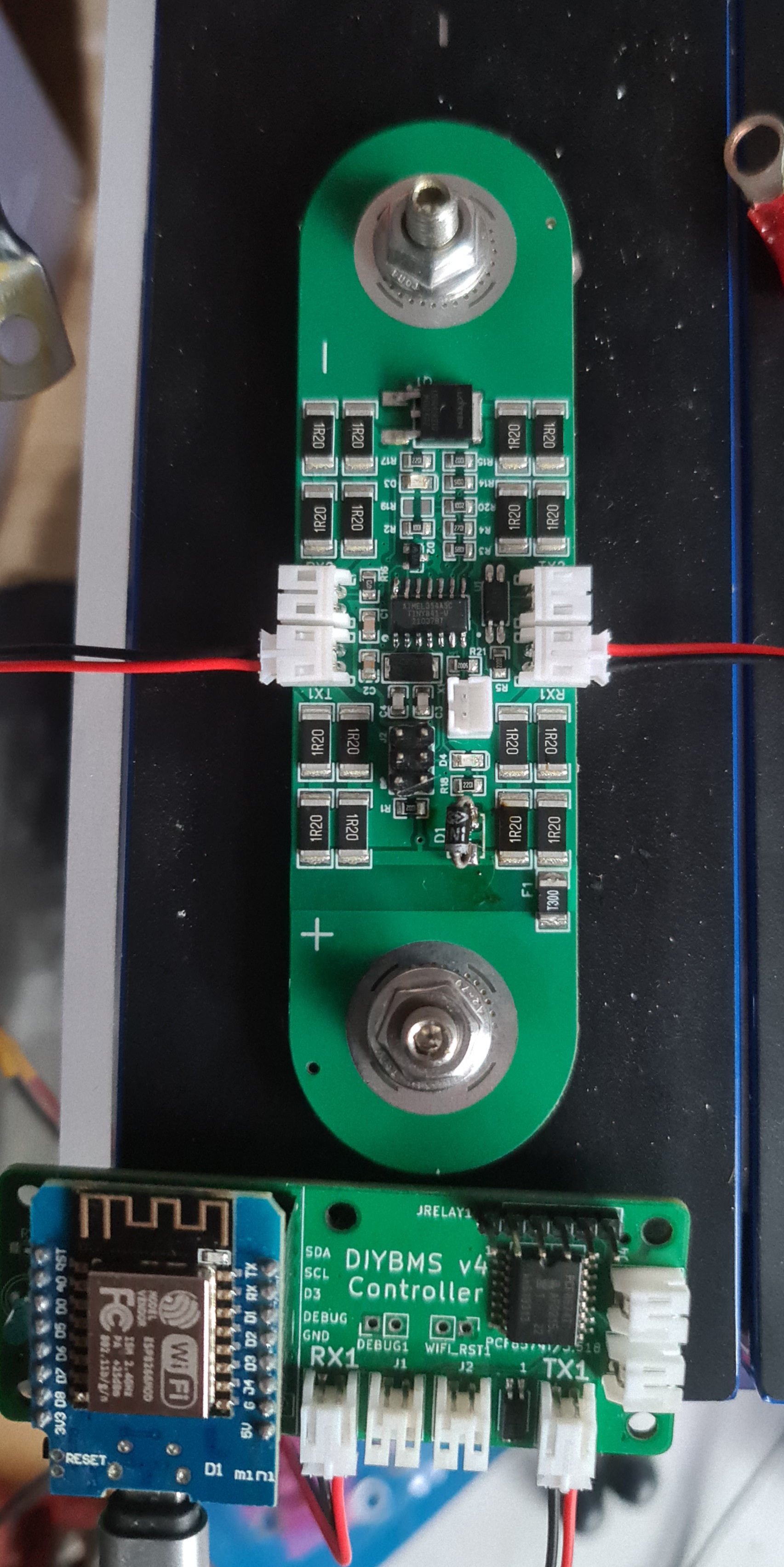

First board passes initial tests…
Still waiting on a few components.
Most of the assembly by JLCPCB.
Which files did you use to order from JLCPCB?
It’s all in this thread including the link to Jau’s work (26 Feb) which has all the files you need for JLCPCB.
Sadly they don’t always have all the components. In my case the diode, the thermistor and attiny were unavailable, the diodes are available at LCSC again now. JLCPCB now install JST connectors! For the shunt and new controller I just bought the bare boards and used Stuart’s new interactive BOM. The test shows the 4.4 board does work with the old controller with new software.
The boards are working well and are able to keep cells well balanced.

Hi @Jau ,
Today I have found this topic and decided to place an order of your stile modules for my 280Ah cells. Your design for these type of cells is great, thanks!
However, during order process I saw something strange.
Instead of seeing a picture like this (from EasyEDA 3D):
… I see something this (in JLCPCB order page):
Screenshot_2
Is it ok to go on with the order like this, or should the parts placement file (CPL) be somehow adjusted?
@Andrew_Congdon , it looks like you are already using these boards. Was it exactly the same by you during ordering?
Many thanks in advance for your help!
I recently ordered some boards and they were assembled ok.
Mine also looked like yours in the preview
Struggling to find the parts for the controller though :frowning:
The parts placement from my order looks normal:
