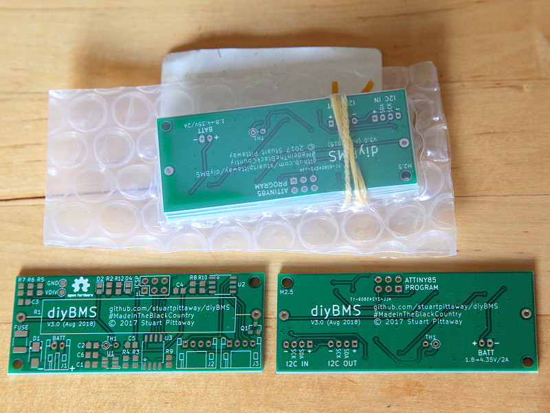

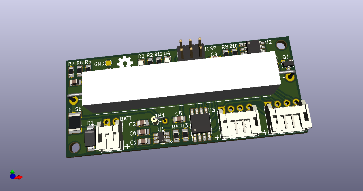

For those who have sat through my YouTube video (and stayed awake!) I’ve released the smaller PCB design over to GITHUB - its in a separate branch for now.
A couple of the resistors have been changed to 4.7K simply to reduce the number of different components required - this will also make the LED not as bright as some people have reported issues with this.
I like smaller design much better. First of all boards will be cheaper. With panelizing hints from Colin you can get around 30 of them at about $12 dollars shipped. Also 0805 SMD is not much harder to hand solder compared to 1206 but the board is way more compact. Still have to try Stuart’s frying pan trick :slight_smile:
Great to see such progress.
what size is the new board
65mm x 28mm (approx) - (2.5" x 1.35")
thanks for that stuart
Just one last question is the file ready to download and also board requiremants like myself is the first time ordering a pcb make like copper weight, finish pcb thickness
I just used the defaults for the pcb tickness and weight etc. Use the GERBER.ZIP file - I ordered some boards using that last night.
found it all good orderd 30units now to find all the parts

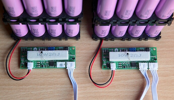

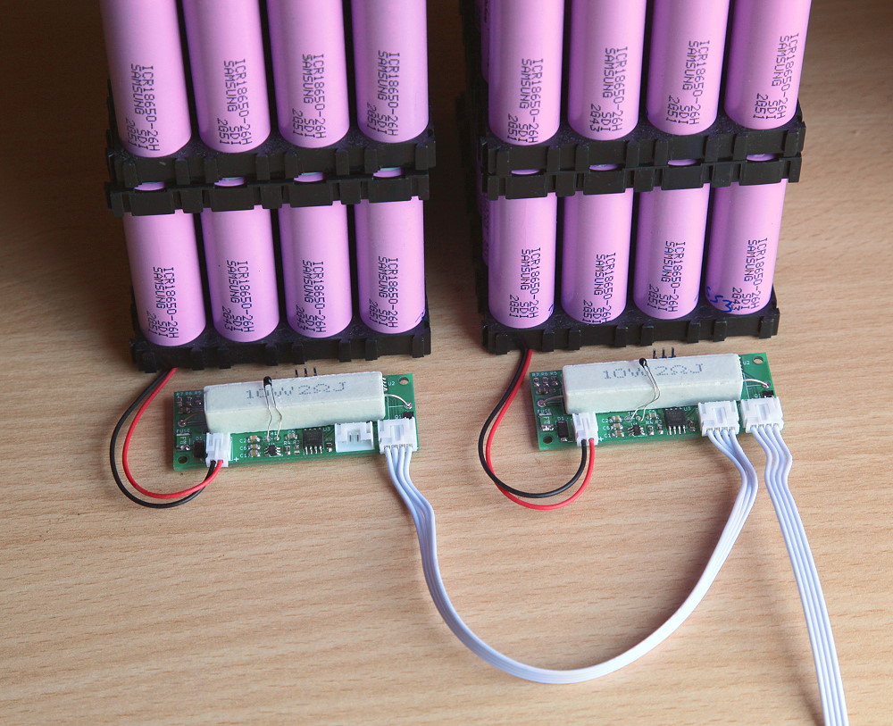

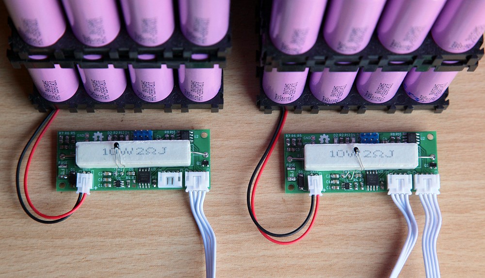

I thought people might like to see some photos of my v3 PCB “in action” ? Since v2.1 of Stuart’s diyBMS board (March 2018), this v3.0 is my complete redesign with the following improvements:
  • Smaller 0805-size SMD components instead of 1206-size (slightly cheaper and more readily available)
  • Far more documentation on the board silkscreen, including labelling all inputs/outputs, consistent orientation of components & labels for easier hand assembly, and marking pin 1 on all ICs
  • Thermistor labelled as fitting to front of board (for measuring power resistor) or back of board (for measuring battery pack)
  • BOM optimised with fewer components, and re-uses standard resistor values where possible
  • Supports a choice of data & power socket sizes: JST PH 2.0mm, JST XH 2.5mm, or generic DuPont 2.54mm
  • More reliable I2C communication with reversed ADUM I2C chip
  • 2-pin power socket is now the standard way around (positive on right), so commercial red/black cables work without modification
  • Much smaller board, just over half the size of v2.1 at exactly 65x28mm
  • Via-stitched copper ground planes for better heat-dissipation
  • Standardised M2.5-size NPTH mounting holes (non-conductive pads)
  • Shorter PCB traces, especially for high current signals
  • Does not support the larger/more expensive aluminium-housed power resistors (e.g. Arcol HS50)
the photos below show my prototype board, which only supported JST PH 2.0mm sockets. The v3 files that Stuart uploaded work with all 3 socket sizes.

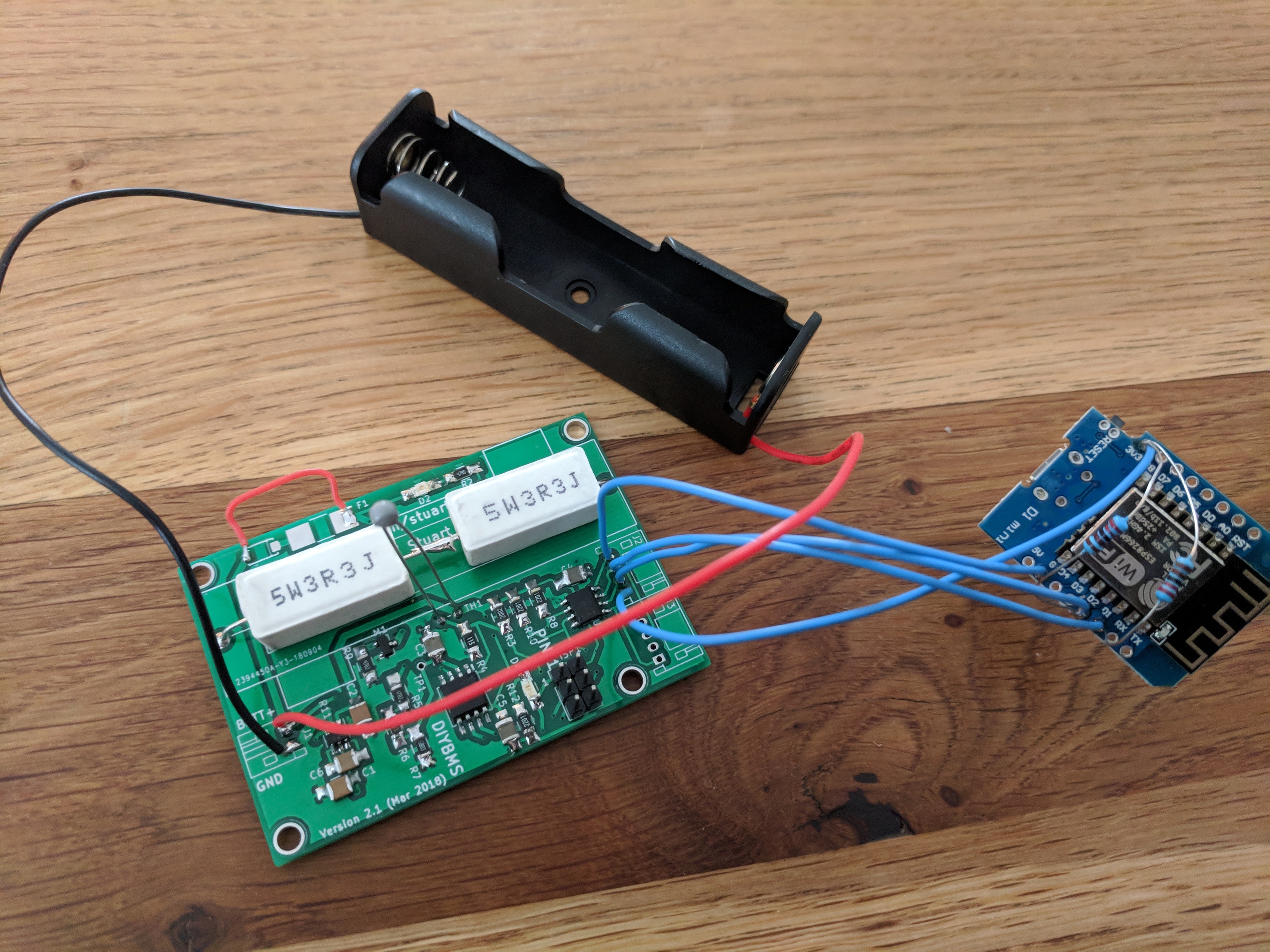

Another diyBMS in the wild, thanks everyone who contributed to this project so far!
Couldn’t wait for new solderpaste to arrive and had to hand solder the first board :slight_smile:
