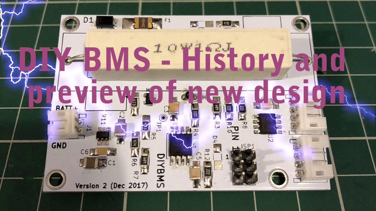

I’ve just published a Youtube video on the history of the DIY BMS and also a new design

The design is opensource so you can download the board design and submit that to a PCB factory (JLCPCB is a common one).
Might be worth another video showing how to do that.
this is the first i have heard of download ing the disgn. im new to this site.
To get the pcb files if you download the zip from github then there shall be a folder called gerber under the BMS-Cell-Module-Circuit folder, if you zip the gerber folder up you can then upload that zip file to the the jlcpcb website. I’d recommend jlcpcb as well and using their panalise option then you can get your boards for $2 as they have an offer on and if you choose slow delivery it’s around $8 or so. By doing the options below you’d get 20 boards.
If i were you though i’d wait for the new board design as it’s even smaller though so you could fit even more in the order so have plenty spares or share with someone if you know someone else working on the project.
Although if you have a 4p configuration the “old” boards fit well on a cell so going smaller is only a good option if it has different functions aswell. And per my understanding its only smaller right?
Correct - although does have different spacing for other types of connectors if that’s important for you
