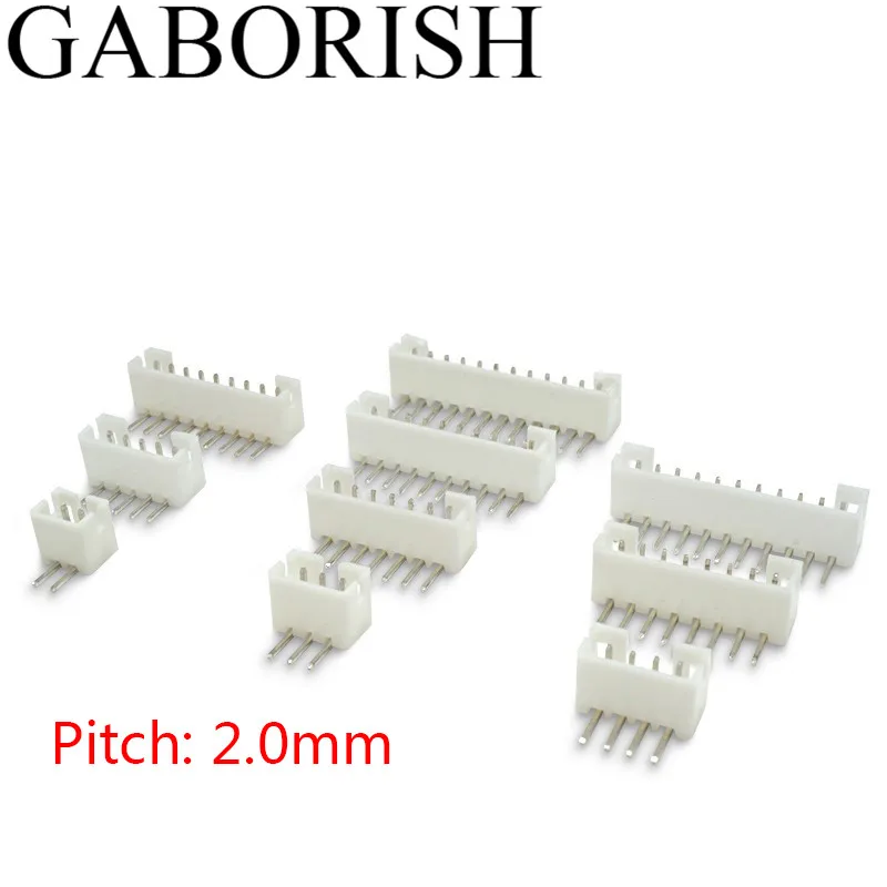

I can’t find bend jst connectors on alie, i have normal ones already so i’ll be useing that i guess :smile:

I’ve used straight ones as well although the right angle ones are available.
Those are the ones i bought and they came with cables with female connectors also. I got my attiny85’s from ebay but as stuart mentions for UK sellers farnell is just as reasonable and far quicker delivery.
I meant not in the link in Jman’s wishlist :wink:
