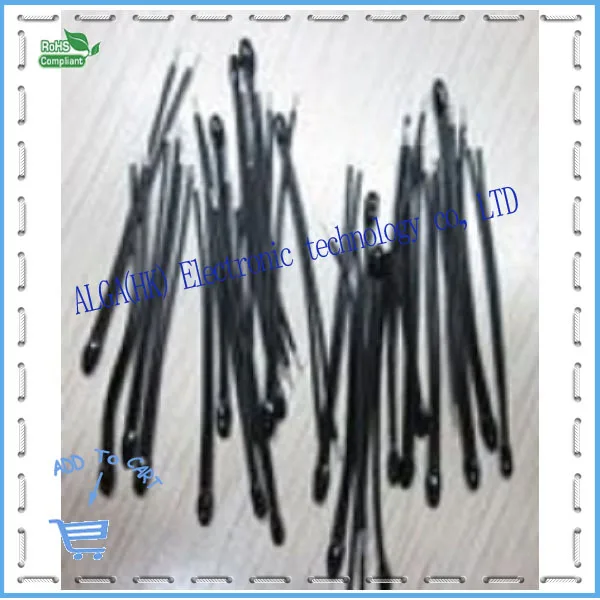

Ok so i got a new wishlist, and i think everything is on Alie, can anyone check that i have the right components? Especially the SI2312, there is no info on that sale.
https://my.aliexpress.com/wishlist/shared.htm?groupId=100000001079545
EDIT: Is this thermistor good enough you guys think?
I ordered mine though there too. Thanks for the recommendation!
