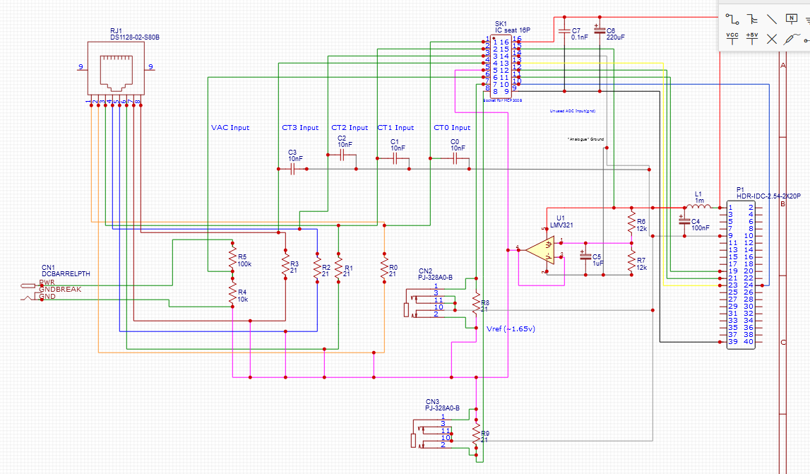

I would like to keep it code compliant, so thank you for sharing. Plus, the noise I am picking up from CT leads that are disconnected from a conductor is in fact 60Hz. Do think this is a clear indicator of EMI?
Robert - is the inductor L1 in my schematic intended to filter out 60Hz noise on the 3.3V input? I am asking so I can determine the inductance and capacitance values needed. If it is in fact 60Hz, I’ve determined that a 70H inductor and 100nF capacitor should block 60Hz. I want to submit my order on LCSC for the missing components I’ll use on the custom PCB.
On a p.c.b? You’re kidding. That component would be HUGE.
No, they’re intended to take out r.f.i. If you’ve got mains ripple, on the 3.3 V, it’s more likely to be 120 Hz (from a rectifier), so if it’s genuine 60 Hz, it’s straightforward pick-up from adjacent cables or radiated from a transformer (not one in a switched-mode p.s.u, they don’t work at 60 Hz).

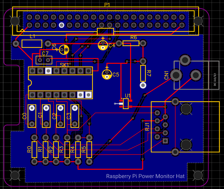

I’m beginning to review my PCB layout and I have a question.

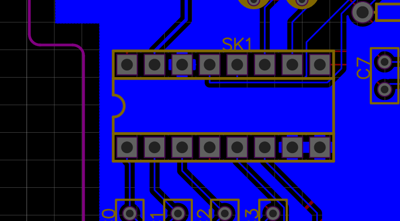

Since I’m using a ground plane, can I/should I get rid of the traces that were previously the ground connections? For example, the red trace underneath the ADC socket in the image below is the ground. The solid blue region is the ground plane, which if you look closely, is connected to the same pins that have the red traces going it. Can I remove the red traces and rely on the ground plane for grounds? If yes, I would assume that the same logic applies throughout the board. Is there anywhere I should leave both the connection to the ground plane and the ground trace?
I know the ground plane is hard to see in the picture above, so here it is with a direct view:
I’d leave a wire link there, as it’s a 1-off. That way, the option is still open should you find it necessary.
Yes, you can do that. A ground plane will have much lower resistance than a trace. Look at it this way: if you’ve got a current that gives you 1 mV of noise between the “ground” for the op.amp and the “ground” for the ADC, you’ve got ½ - 1 mV of noise on the input. If the resistance of the ground plane between those points is ⅛th of that of the trace, you’ve got more like 100 µV of noise on the input.
After I removed the unnecessary ground traces, I have been focusing on making the ground plane as large as possible and trying to avoid having both “islands” and choke-points in the ground plane. This has lead me to another question for you - is using a lot of vias considered a bad thing?
For example, I added these two vias (on the ends of the diagonal red trace) because it was previously a long trace that was kind of isolating the ground plane.
I’ve employed the same design technique in several other areas of the board too - where the only purpose of the via is to add some continuity to the ground plane.
If the ground plane is in separate pieces that aren’t connected, it’s not a ground plane - or not an effective one. An ungrounded patch of copper on one side of the board will be one plate of a capacitor, with the board substrate as the dielectric, with traces on the other side as the other plate, capacitively linking then together. From what I can see, unless there’s another route to connect the top left copper to the bottom right copper, then what you have is necessary.
I did have one “island” piece of the ground plane which I fixed by rearranging some components and adding vias.

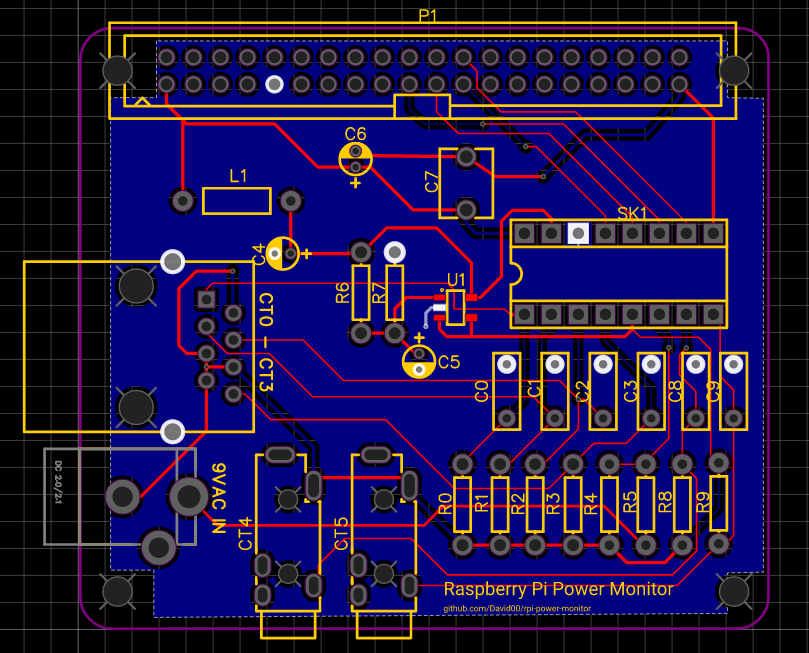

Here’s the full board - the link I shared a couple posts ago should take you to the live version if you are available to take a look.

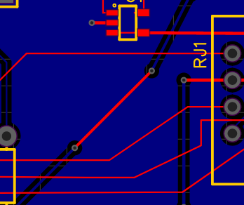

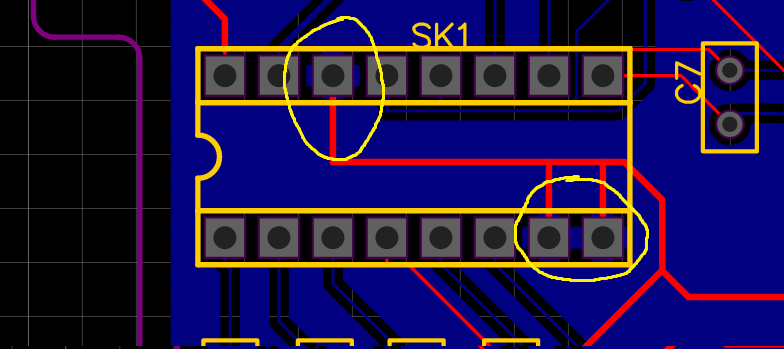

There are a few immediately obvious places where I think you can remove links and vias by rerouting traces, it’ll take a bit of studying to identify them all.
Here are a few to give you a flavour of what I’m noticing.
You don’t need the top link between the screening can legs of RJ1, check the dimensions though of those legs.
If the screening can of RJ1 doesn’t touch the board, the mid-rail common to R0 - R4 could go round under RJ1 and meet up with pins 6 & 7 there.
The trace from U1 to R6 could go under R7 and round the top of R6, removing another 2 vias and a link.
The current in R5 is a 1-turn coil around the c.t. input traces from RJ1 - rotate R5 90°
Also, check with your board manufacturer about 90° corners - they are usually a bad idea.
Thanks Robert, that is extremely helpful.
I’m not sure why the link between the RJ1 metal screen was there - I’ve removed it. I think it came about when I was trying to attach the RJ1 screen to the ground. This is the female jack that will be placed in RJ1’s position. I am planning on grounding the two pins coming off the shell of the jack to the ground plane - which, if you recall, I was questioning their purpose in the rough draft of my schematic. I checked the hole size and they were a bit small - by about 0.5mm. Good eye!
Why would it matter if the screening can touches the board or not? From the picture of the jack at the link above, it looks like the bottom side of the jack only has the metal screen around the perimeter. But aren’t traces in the top layer still insulated under the PCB coating?
I’ve moved the trace from U1 to R6 and will continue to look for other traces that can be improved in the same manner.
Rotating R5 was a good improvement. I was too focused on the aesthetics that I did not see that easy optimization.
The fact that you can say they’re usually a bad idea means you know way more about this than I do! I’ve eliminated all 90° trace corners, but out of curiosity I will still check to see if I can find anything about it with the manufacturer. 90 degree corners that meet at a via should be fine though?

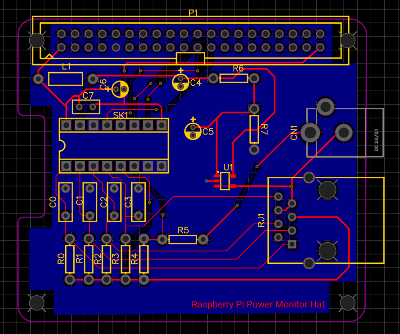

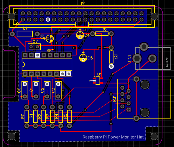

Here is the board with the latest changes:
I wouldn’t trust it.
yes, or at a component pin. I was taught (about 50 years ago) to avoid sharp corners, I can’t even remember the exact reason now. As it’s so long ago and production methods have changed, that’s why I wrote “check with the manufacturer”. It might not be the problem it was then.
Thanks!

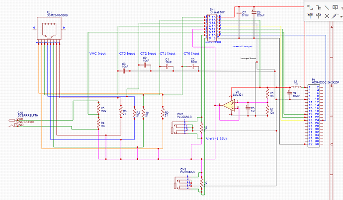

It turns out I need one more CT sensor in my project, for a total of 5. I did not realize that my subpanel was also fed with two 120V legs like my main panel is. To summarize, my CT needs are 2x for the main panel, 2x for the subpanel, and 1x for the solar input. My solar input is 240V also but I am simply doubling the single CT measurement based on the assumption that the PV inverter distributes the power equally between both legs.
Since I have two unused ADC inputs, I figured I might as well include two additional CT inputs. I am thinking of using a 3.5mm plug for the additional 2 inputs, but I can’t seem to find a simple 3-pin female jack that is horizontally mounted. Most of them have 5+ pins, like this one. It took a bit of research to uncover what each of the pins does, but I believe I have it figured out. I’ve added two of these to the schematic - they are below the ADC and to the left of the op amp.
Pin 1 is the sleeve and pin 2 is the tip. Pin 3 is the ring, which is not needed for the CT sensor input. Pins 10 & 11 are mechanical switches that are normally closed if the socket is empty. When the jack is inserted, the switches open.
Would you recommend that I wire the unused pins (3, 10, 11) to the analog ground, or leave them open/un-grounded? Here is my schematic with the two additional CT circuits - I’ve grounded the unused pins to the analog ground to start out.
That’s most probably reasonable. Even if there is a neutral connection, it’s likely it’s only for the control circuitry, and a few watts.
They are called “break” contacts to tip and ring, which are closed when there’s no plug inserted and the contacts break when a plug is inserted. Think a loudspeaker that’s cut off when headphones are plugged in. Leave them all disconnected. If you ground it, you’ll short the mid-rail to ground, disable all the other inputs and damage the bias op.amp when there’s no plug inserted. You won’t get much pick-up on that input with the burden resistor in place.
Thank you! I had to completely redesign the PCB. I realized I had pointed the ethernet jack and the DC barrel jack right at the Raspberry Pi’s onboard USB ports, which would have rendered my ports inaccessible. Here is the new design with the two additional 3.5mm jacks for the 5th and 6th CT inputs.
The pins that are highlighted white are all the ground plane connections.
I have a bit more optimization to do (and some 90° bends to remove), but this is pretty much what I’m ready to submit for manufacture. I am super excited! Do you see any obvious pitfalls?

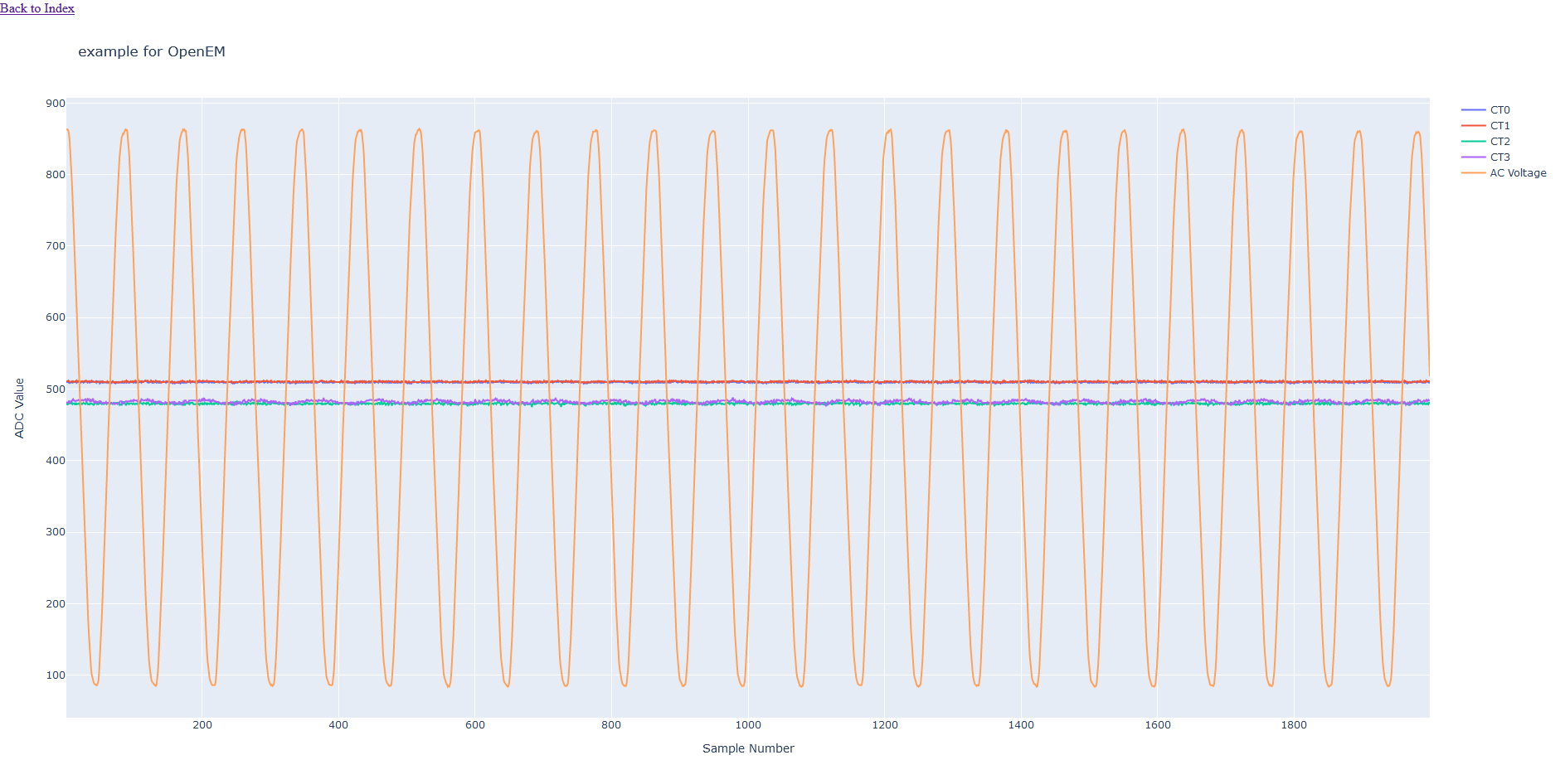

For a bit of miscellaneous stuff… Yesterday I invested the time in adding a debug mode to my software. Previously, in order to visualize the raw data (like for all the screenshots of graphs I shared thus far)…
I would have to set the filename for the CSV data dump in the code, run the program, terminate it, copy the CSV out to my computer, upload it to Plotly, build the chart, name the traces, etc. Now, with my new debug mode, I simply run my program, pass the debug keyword in, followed by a filename, and it dumps an interactive chart with a fresh set of 2000 samples to a local webserver on the Pi that I can view within seconds. Example:
$ python3 power-monitor.py debug "example for OpenEM"
Web server root now has “example for OpenEM.html”:
Clicking on the above filename gives me the chart itself, which I can pan and zoom any which way, or turn off individual data series.
Well worth the time!!
