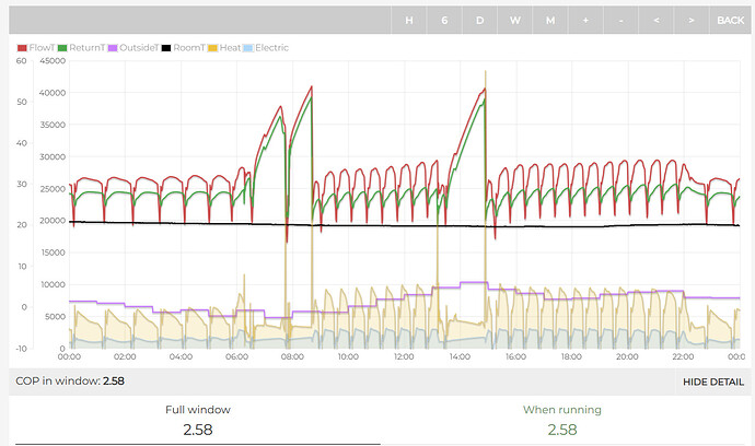

Towards the end of November, we had 2 days then 1 day where the outside temperature hovered around 0deg, and this is where I’ve found the fatal flaw in my setup. Up until this point, I foolishly thought I understood my setup quite well.
At around about 3deg outside, the HP starts doing defrosts with varying frequency. However, as the temp drops to 2 or 1 deg, the power consumption goes up exponentially and it gets into a cycle of defrosting every 30mins any using max power in-between for little or no benefit, very much like this (apologies to the person whose data I’ve borrowed)…
The only means of escape appears to be to hope the external temp goes up, or possibly down, and hope the defrost frequency declines.

Based on the real word testing we’ve done, a 7kW Vaillant should be about to output about 7kW even under the worst conditions. So it should be able to cover your 6.8kW calculated heat loss, your actual heat loss is probably lower.
If your heat pump is struggling to maintain the indoor temperature then you probably need to increase your WC setting, 0.3 is very low. As a test when it’s around 0C outside try setting to WC to max i.e 4.0 and the room set point to 30C, this will make the HP work as hard as it can, if this still fails to heat your house then the heat pump is undersized.
If after increasing the WC curve, the HP is able to provide sufficient heat, then the defrosts are nothing to worry about. Overall, the amount of heat lost via a defrost cycle is relatively low.
Would you mind removing the screenshot from your post? It’s quite very confusing for other forum users to see a screenshot of data which has nothing to do with your system! With a WC of 0.3 your flow temperature will only be reaching a maximum of 30C at 0C outside, the screenshot above shows a flow tempo of 45C at 10C outside.

The temp does drop away a little, maybe half a degree or so over 12hrs, but the defrosts of doom have been relatively short lived thus far as the OT has risen and they’ve ceased, after which the inside temp has eventually recovered.

As I said in reply to Trystan, we’re not struggling to maintain the temp, rather the vagueness of real world (UK) performance data available from Vaillant.
The huge increase in power consumption, whilst the unit is running in this defrost zone is staggering. In November, 3 days at around 0deg accounted for 1/4 of the entire months consumption, which just seems disproportionate.
I’ve changed to a more appropriate screenshot, which uses the same parameters, although it looks like they’re set to 21deg and active.

Well, yes and no. The energy consumption is comparatively large because of the step change in power required once the rapid fire defrosts start.
There doesn’t appear to be any smooth transition between no defrosts and all defrosts and the power requirement suddenly changes from dawdling along at 1KW at 3deg OT to 2.5KW at 2deg OT.
I appreciate why the energy consumption is so high for so few days. However, it’s adversely affected by the half hourly defrost whereas, if the defrosts were only at 45-60 min intervals, which had been suggested to me as being “normal”, I believe the resulting increase in consumption on colder days would be far less significant.
