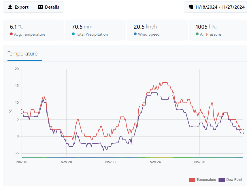

Thought I would add a postscript to this Topic on defrost hell. In the ASHP sizing for Freezing conditions Topic I calculated the impact of humidity on heat pump maximum output to explain why I could not get anything like the 10.6kw out of my Daikin heat pump. This explanation I think works for any make of heat pump unless it has a massively oversized evaporator. I just found a handy ‘Defrost Hell’ prediction tool that should, at least, let you know why your HP goes to Hell on some days and not others.
Odiham | Weather History & Climate | Meteostat
This is my local weather station and from this simple dew point and temp chart you can predict that Dewpoint Hell happened when all of the following were true;
a) Temp was 3c or below and
b) there was less than 1c difference between temp and dewpoint
c) The controller was calling for maximum heat from the heat pump
I do not have any real data below -2c but suspect that by -4c you can play the ‘get out of Hell’ card as there is much less water vapour in the air to start with.

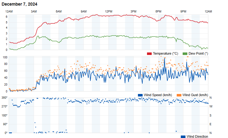

I sympathise with your concerns about the impacts of frequent de-icing.
I have an aroTherm Plus 13.2kw and yesterday, there were 3 de-icing events:
00:12 Air Temperature 1.3C, RH 92%, wind speed 3 km/h
01:51 Air Temperature 1.6C, RH 92%, wind speed 0km/h
15:19 Air Temperature 6.2C, RH 76%, wind speed 73km/h
The first two events are expected for the RH and temperature but the 15:19 event is odd.
The wind was from the north and my heat pump faces north. Would a strong wind affect the air flow in the heat pump and could this be related to the unusual de-icing event?
Any thoughts on this from anyone?
Ringi
(Ringi)
29
What was the air temperature etc between the 2nd and 3rd defrost? It possible most of the ice built up sometime before 3rd defrost.
PjH
(Peter Heyes)
30
The temperature had risen above 5C at 04:00 and remained above 5C for the 11 hours until the unusual de-icing. See weather chart.

It does sound somewhat reasonable. If the wind is strong and opposed to the normal air flow direction of the heat pump fans, the evaporator could freeze up because there’s just not sufficient fresh (warm) air coming in.

We had 2 rather unexpected defrosts yesterday at 07:00 and 14:45, both at about 6deg OT and 4deg difference to the dew point.
Previously, I’m not aware of us having a defrost at anything above 3deg.
We’re quite exposed to the wind, so I can only put it down to the constant 40kph wind chill across the back of the evaporator.
