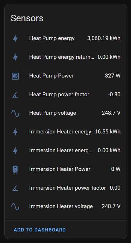

Massive thanks to Stephen and this thread. Think I finally have it working with an M5StickC Plus2 and Shelly energy monitor!
This thread is brilliant - I’ve got my M5StickC Plus2 setup, code built and downloaded, but I don’t see anything on the screen at all - is that normal?
I’m planning to buy the Shelly Pro EM - I assume that’s the right one, and put the CT clamp around the HP’s live feed. Do I need to do anything with the other CT clamp as it’s a dual channel monitor?
Thanks to all - this thread has been incredibly helpful! :slight_smile:
The Shelly Pro EM is good, One CT for the HP and the other for the immersion heater
Shelly EM (SHEM)
by Shelly
Firmware: 20230913-114150/v1.14.0-gcb84623
Hardware: gen1

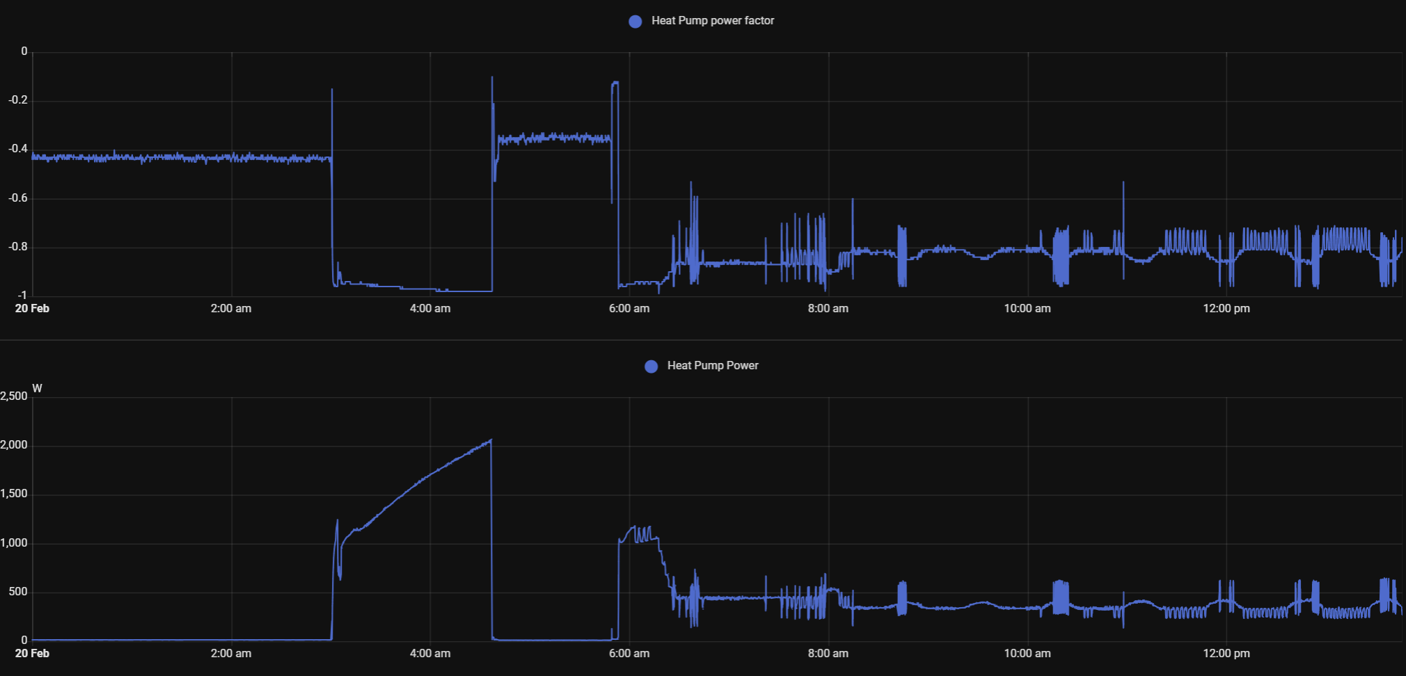

Hi Neil
Out of curiosity what is Heat Pump power factor -0.80?
Where does this device get the voltage from?
maybe this will help?
https://community.shelly.cloud/topic/1174-power-factor-a-good-explainer/
and the Voltage is from the devices input itself, PS I am running from Battery and Solar at the moment
Thanks Neil,
So the power factor is an adjustment made to the power drawn from the grid to take account of the fact that not all that power actually goes to running the device due to inefficiencies?
So for example, the heat pump circuit is drawing 1,000W from the grid but the circuit is only 81% efficient so 810W is reported as being consumed by the device rather than 1,000W
Have I understood that correctly?
