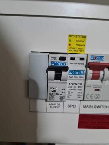

Regarding the Shelly EM; there’s no space in the outdoor distribution board (there’s one RCD it that for the HP and another for the BUH), but inside the house there is space - see photo. Is it OK to use this instead - it would mean I can’t monitor the BUH use - only the entire power draw - but is that really an issue?! Does the UK ever get cold enough to use a BUH?!
I shouldn’t worry, ESPAltherma tells you when the BUH is running, and you’d see the extra load immediately.

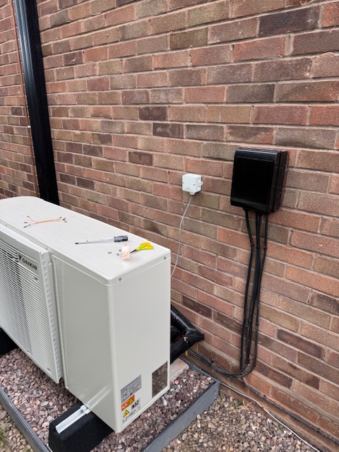

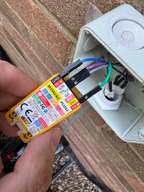

If you can get the M5 outside the HP case in a waterproof box, it could work very well. The cable can be a few metres long especially if it’s shielded. The M5 won’t take an external antenna.
I’ve lurked for a long time but thought I would sign up to try and help you with this. I also struggled to get my M5 stick to get a WiFi signal inside the heat pump case, and in the end I ran an Ethernet cable into an outdoor rated enclosure where it’s happily lived ever since.
Now I was fortunate enough to have the cable professionally soldered at each end, but in hindsight this was a waste of time - it’s quite straight forward to strip a little insulation off each end of the Ethernet cable then use wago connectors to make the connections to some jumper cables.

Hi Brendan, I think you’re 90% of the way there in your understanding :slight_smile:
Step by step, the process would be something along these lines:
  • Get Ethernet cable, cut an appropriate length. I used approximately 1.5m - this was a little excessive but it’s not a big deal since any extra can be hidden inside the heat pump.
  • Pick 4 colours, strip back the insulation and install a wago connector at each end. I’ll leave suggesting an appropriate connector to others, since I didn’t use one myself and I wouldn’t want to get it wrong. Note you can use a single strand from each twisted pair, no need to use both.
  • At the other side of the wago connectors you want to install jumper cables. You’ll have to cut off and strip the insulation on one side for each, giving you female connections for the X10/HP side and male connections for the M5 side. I used these: Amazon.co.uk
  • Optional, but at this stage I would get a multimeter and test continuity for each wire before going any further.
  • Now you can open up the heat pump and plug your cable into the X10 connector and thread it through the grommet above the circuit board, then down and out of the grommet at the bottom of the unit next to the return/flow pipes.
  • You’ll need an outdoor enclosure to store the M5 stick in. I used this: https://www.screwfix.com/p/ced-ip65-24a-5-terminal-weatherproof-outdoor-adaptable-box-80mm-x-52mm-x-80mm/14556 plus https://www.screwfix.com/p/vimark-nylon-male-comp-glands-20mm-white-2-pack/556vt note that the gland was much too big for the size of the Ethernet cable, so you may want a better sized one!
  • Thread your wire through the gland (you might need to unclip then reclip the wago on Ethernet side for this step) and plug it into the M5 stick
  • Stick the enclosure onto a surface. Number of options here, the most professional is probably screwing it onto a wall, or using magnets to stick it onto the back of the heat pump case. I’m not professional nor was I smart enough to think of the magnet idea, so I used double sided gorilla tape to stick it on my wall.
Here is my bodge in all its glory:
