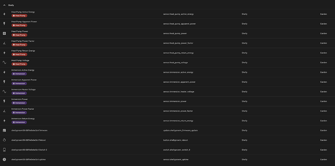

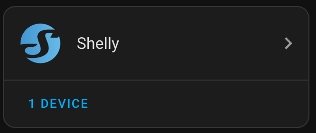

I assume you have the Shelly in Home Assistant. I use the sensor.heat_pump_power entity. You should see it in the YAML list.
These are the Shelly entities I see.
I installed the Shelly Integration

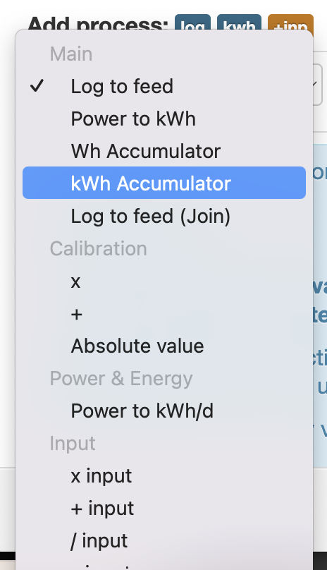

Hi, I cannot edit the feed (no option for variable), so had to delete the input and feed and start over.
I did log to feed variable, -input, x input, and x, all ok.
The 2nd log to feed (heatpump_heat_buh) wouldn’t allow create new, as it was already in the drop down list, but as soon as I clicked that option, the variable option disappeared.
The last Power to kWh only has a drop down list (Create New has disappeared) with no option for heatpump_heat_buh_kWh.
So I’m obviously doing something wrong but cannot see where.
Any advice please?

I vaguely remember having similar issue. I would make a new feed with a new name until I got it sorted out. I used the old name with _2 on the end. I then went back, delete everything and started again until it was neat. I hope that helps.

I managed to get through it by adding the heatpump_heat_buh_kWh first, adding the others then using the side arrows, dropping heatpump_heat_buh_kWh down to last place.
All gone through and set up my heatpump and seems to be running ok.
Thank you for all your help as I really was clueless in all this.

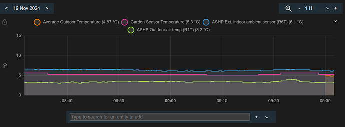

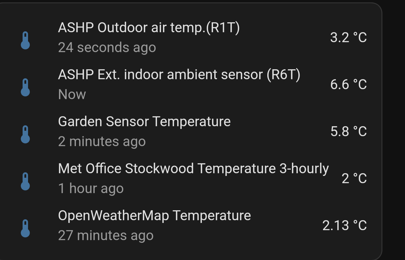

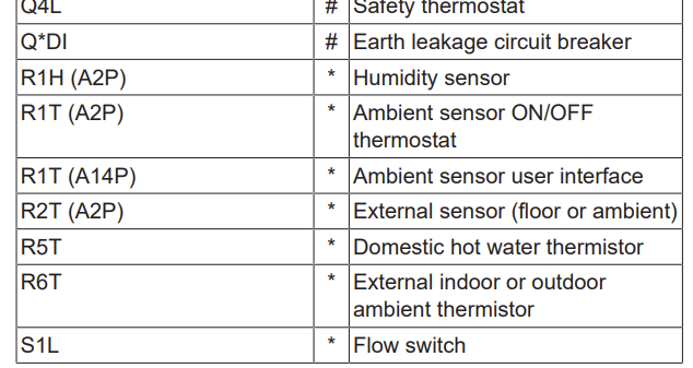

I was just about to ask what the difference between
R1T-Outdoor air temp & Ext. indoor ambient sensor (R6T).
Not sure which to believe.
RT6 is the correct outdoor sensor and the one i use, it looks similar to your ‘local’ garden sensor also.
depending on wiring -

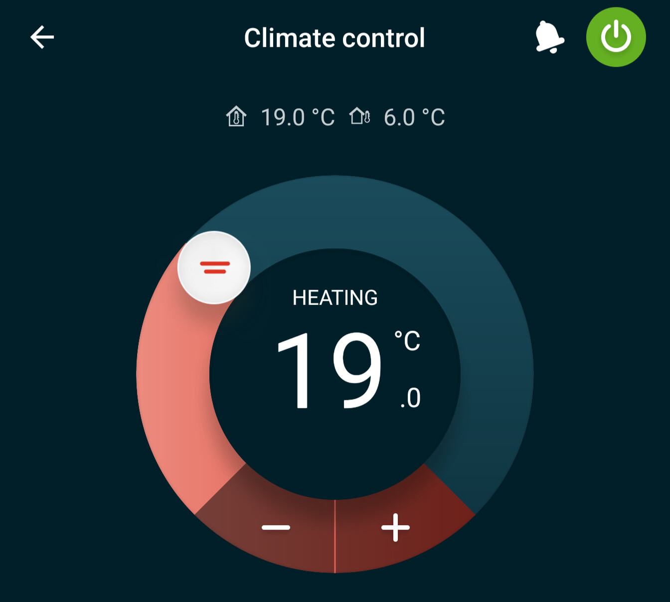

Thanks.
The R6T is also the one reported by the app and MMI as being the outdoor temp.

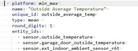

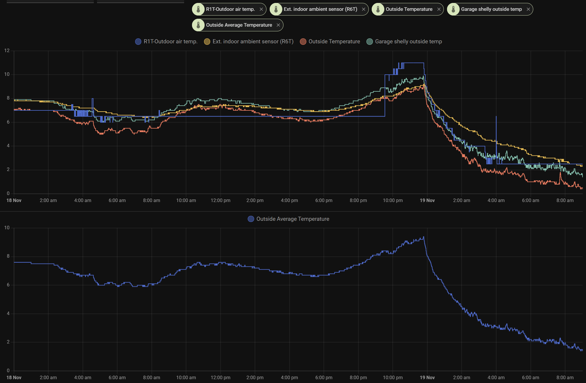

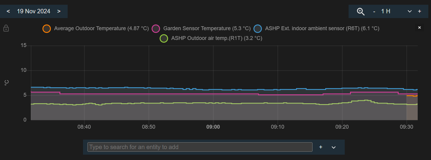

also i average out 3 sensors with a template -

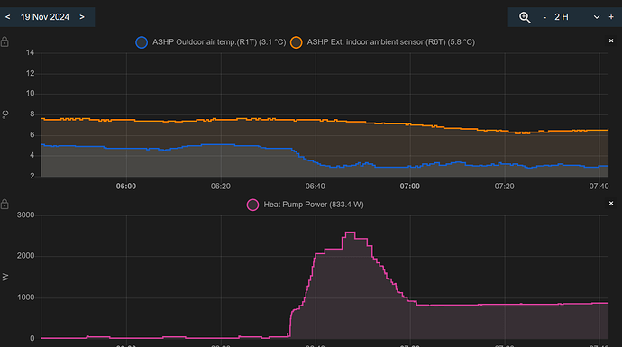

My outdoor temperature always dips when the heat pump is on. You can see it (purple) rising when the heat pump is off. Not very reliable
Think I’m using R1T, wonder what R6T looks like!
my heating started last night about ~9:30 note the bump/increase on RT1, i would use RT6 (or an average if you have multiple sensors) IMHO as its more accurate
