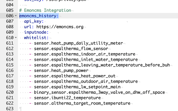

I’m obviously doing something wrong here…
I copy your emoncms file code code into Yaml config, input api and node, click save and get an error
“please provide a filename”.
Google doesnt come up with anything so i’m at a loss.
Any assistance please?

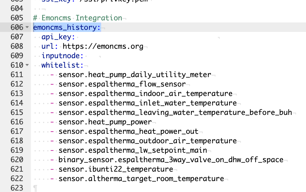

I am not sure why it needs a filename. You are putting in the configuration.yaml file right? Do you have rights to edit the file. I assume so. I see now reason why it would need a filename. I assume it is Home Assistant that is complaining?
This is what mine looks like.
Ah, I can see your input starts at line 605, I was starting a new one at line 1.
After adding them to the end of the others (line 160 for me) allows me to save.
I’ve no idea what i was supposed to put in input node so just put 1.
Over at Emoncms inputs, I’m only getting the one “binary_sensor.espaltherma_3way_valve_on_dhw_off_space”
Tried different node numbers but it just adds the 3way valve again.
But at least thats another small step
Thank you
