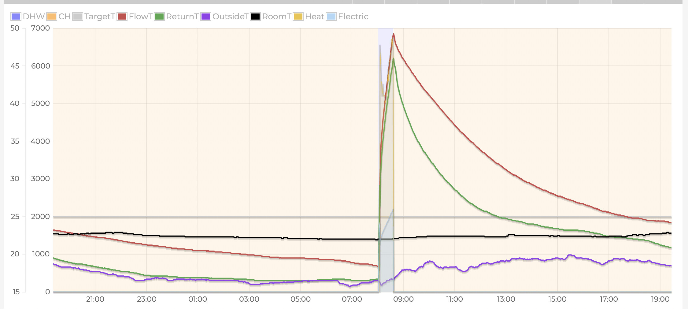

I believe the Outdoor air temp only updates when the heat pump is running. That’s what happens with mine anyway
FWIW, my HP is currently off for heating, on for DHW, and it’s tracking outside temp continuously, using the built-in thermometer at the rear.
Hopefully the attached pic shows this:
Edit - changed “attachment” method. Moderator, BT
Do you have the external temperature sensor installed - I do and that only updates ambient when the pump’s running
“using the built-in thermometer at the rear” - nope, the standard one on the box. To some extent, a separate one would be better, because the box one fluctuates quite wildly with the airflow, which messes with the weather compensation, but probably not significantly.

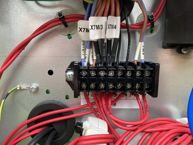

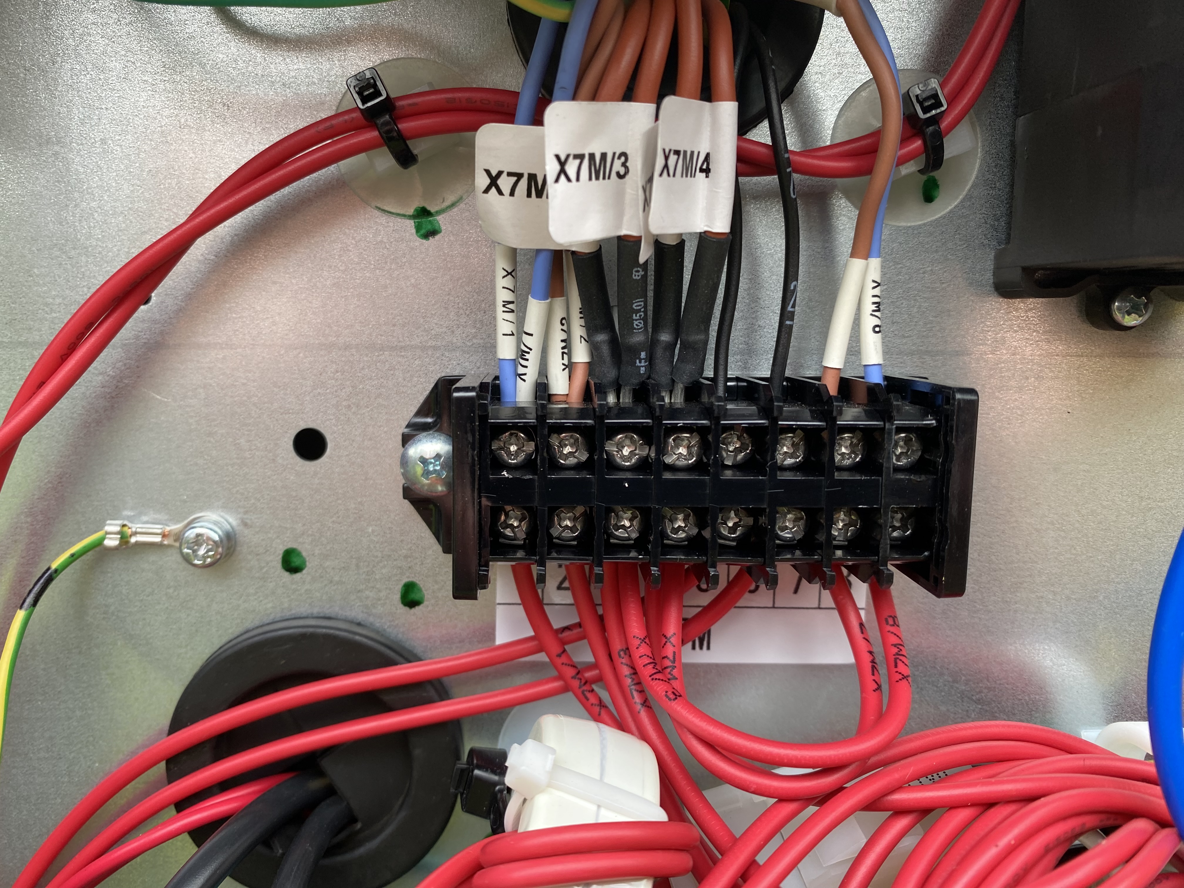

Where on the 9kW board is block X7M ? I’ve got one being installed as I write, and took a photo while the cover’s off, but can’t immediately see a connector labelled X7M - perhaps it’s behind some cables ?
I’m told I have a backup heater - is that the same as the heating tape, or something else? I was assured the backup heater only runs when it’s very cold, but got the impression it’s quite powerful whereas reading this it sounds like the tape heater is quite low power ?
I can see a red ribbon matching the one in your photo.
X7M is on the front, near the top IIRC
It looks like this.
The tape heater is different to the backup heater. The backup heater is a 3kW heater used in cold weather.
And a Tape Heater is attached to or wrapped around pipes to prevent freezing - so usually thermostatically controlled or ‘self-regulating’, and a few watts per metre of length.
I think mine looks like the same as that - links from 3 to 8 and 4 to 7 (a little hard to follow the links on my photo - I’ll take another one when I get a chance). Wires from 5 and 6 head off down-left.

The service manual for both of them shows tape heaters, in the same locations, which are the sources of extra heat that throw off the temp sensors and skew the ESPAltherma-provided LWT numbers. The service manuals say they are engaged in specific temperature conditions only, but on the EDLA09-16 which I have, these tape heaters are on whenever the circulation pump is running, so the temperature data is incorrect. I had a Daikin maintenance engineer come round to investigate and after a conversation with his manager, we determined
  • They were on all the time the pump was running
  • Daikin had set it up like this as a “belt and braces” arrangement for conditions that were not going to happen to me
  • Other (presumably ESPAltherma) users had had this situation
  • There is a field service fix to restore them to the manual’s described function (removing a wire link on X7M)
    He removed the link, and they’ve been fine since. I also save power!!
My ASHP has yet to melt down or freeze up. YMMV.
