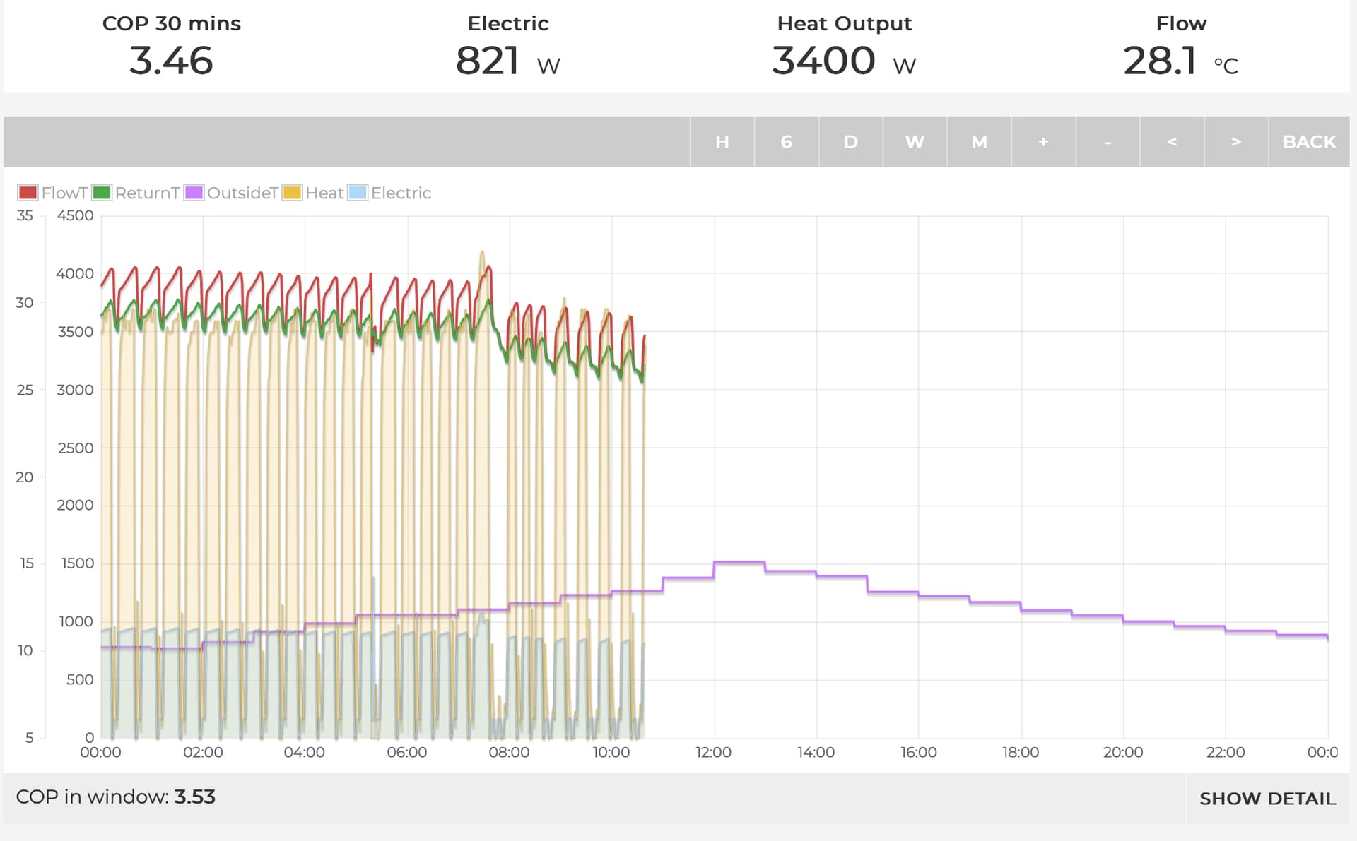

Your system looks to have been running well at 30°C with a rated emitter output of 20kW.
However, today it’s been cycling like mad, as you show. My guess is that some TRVs or something have shut off parts of the circuit, and it can’t emit the heat. Keep all valves open, and maybe raise the target flow temperature.
How much water is in the system? System volume should be sized so that the system can run at least 15-20 minutes at lowest output to avoid these situations.
Again, I thought that I had my system set to run continuous at a good temperature, however with the increase in outside temperature it has got haywire again.
This is my current chart:
I am running LWT, have a WC of 39°C @ -3 and 25°C @ +21, on the Madoka I have set to -2.
Considering what I need to do now, do I change back to Internal Thermostat (Madoka control) when the temperature increases and back to LWT when the outside temperature decreases?
Increase the WC? Increase or decrease the overshoot on the madoka?
These are the only things I have recently changed so have to assume one of them is not working as it should.

I sometimes see the same behaviour after hot water cycles where the water temp in the volumiser is high compared to the required flow temp for heating but that settles down once the flow temps return to normal.
The Diakin (and many other) start each cycle on maximum output regardless of the reason the last cycle ended. The return water from the radiators will be cool until the complete water content have pass var the heatpump, the heatpump have no visibly of average water temperature in the system.
The thermal mass of the UFH will be helping as the average floor temperature will change slower than the water temperature, also likely the return water temperature will increase before all the water have been past the heatpump.
The volumizer should not be in the circuit when in DHW mode. Normal connect in the return on central heating circuit before it joins the return from DHW circuit.
Yes, most heat pumps start higher and then throttle down.
Between runs it seems the pump keeps running, so it is not that it does not know the correct radiator/return temperature. The return is just immediately rising, which seems to indicate to me there is not enough system volume.
Some of these runs are only 4-5 minutes with average output of about 3000w. Every system should be able to buffer a lot more than that. Adding a volumiser should help.
