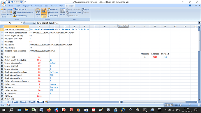

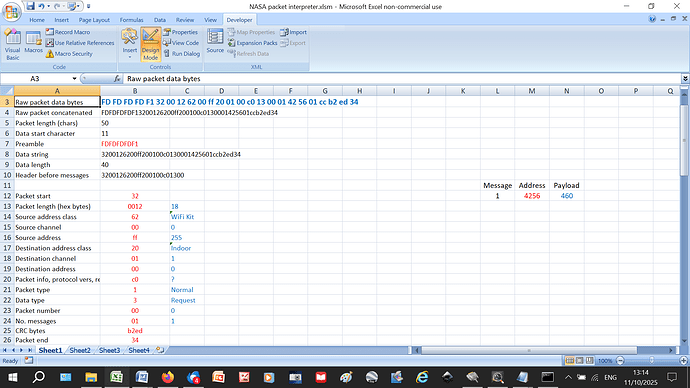

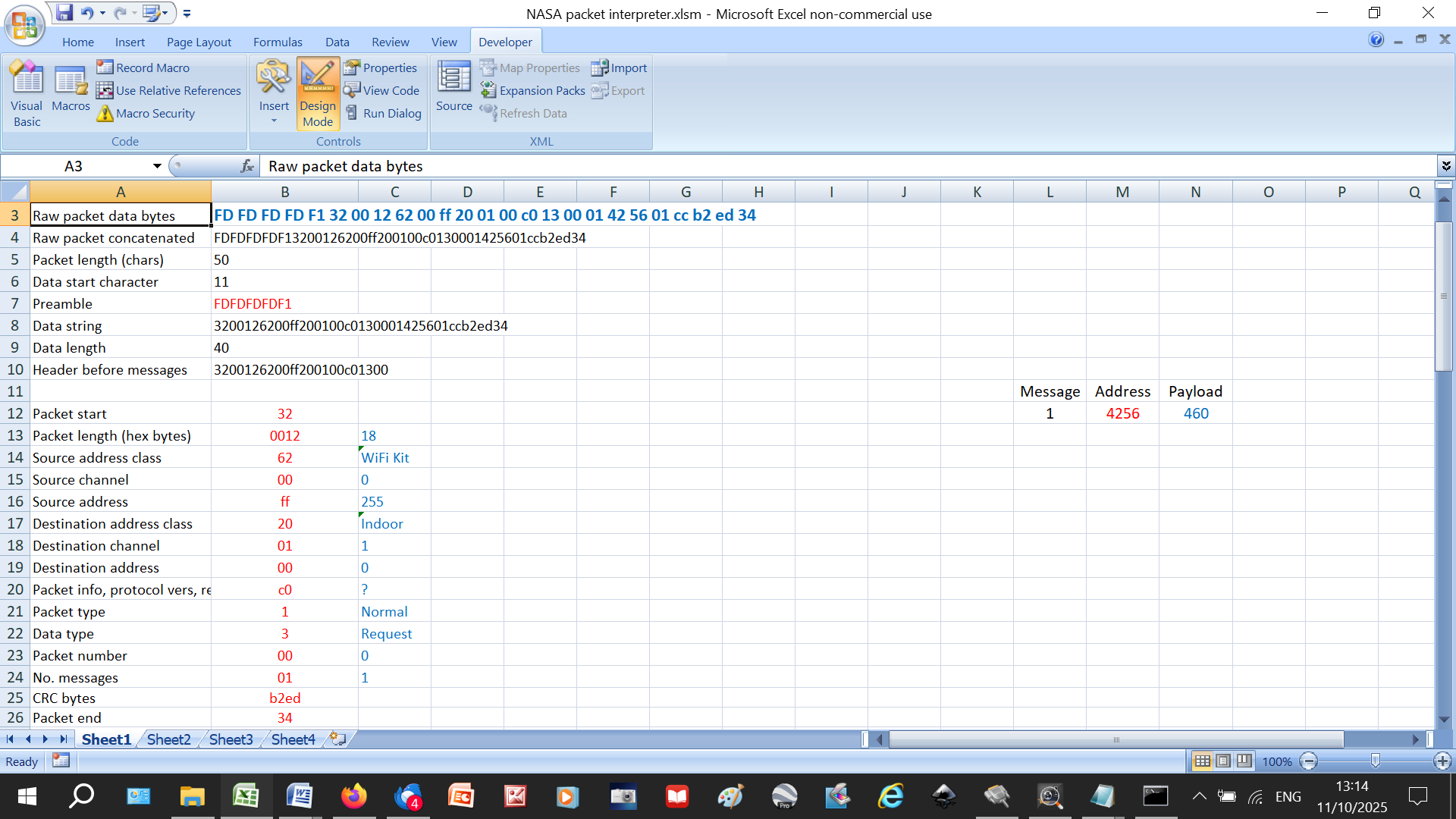

I had a quick look at your NASA traffic disassembly – your code to produce that output must be VERY impressive.

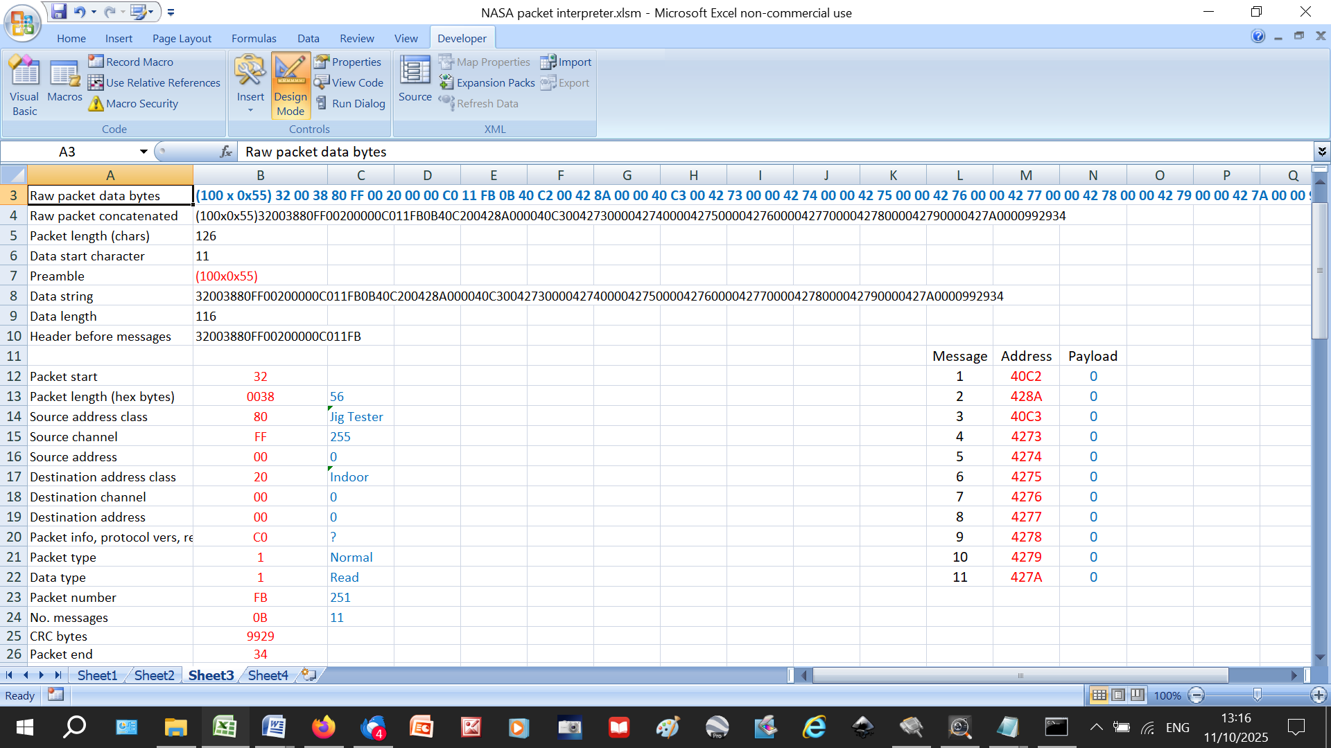

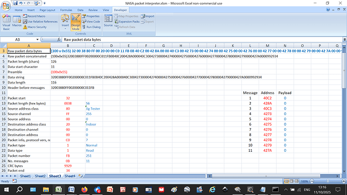

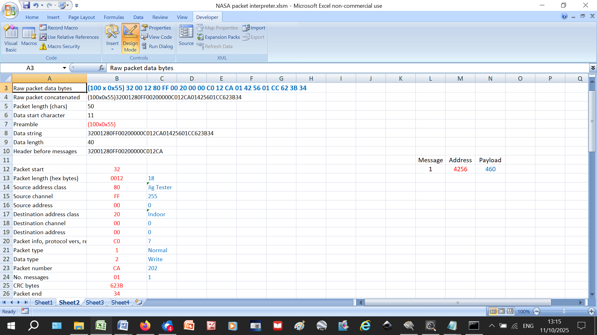

Out of academic interest, I compared your #2021 change request instruction (setting it to 46degC) with the one that SNET-Pro2 produces. Here is yours, as I interpret your log:

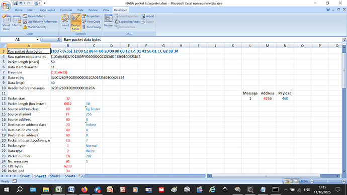

And here is SNET’s:
There are some obvious differences:
· Your preamble is short (FD FD FD FD F1) whereas SNET sends (exactly) 100 0x55 bytes. This seems to be the standard SNET output protocol. For example, when I first switch on my proxy it transmits dozens of packets like this:
(100 x 0x55) 32 00 38 80 FF 00 20 00 00 C0 11 FB 0B 40 C2 00 42 8A 00 00 40 C3 00 42 73 00 00 42 74 00 00 42 75 00 00 42 76 00 00 42 77 00 00 42 78 00 00 42 79 00 00 42 7A 00 00 99 29 34
A glance at the payloads suggests that it is zeroing all its registers, presumably part of its setup process:
· SNET declares itself to be a “JigTester”, whereas your code is “Wi-fi Kit”, and the Source and Destination Channels and Addresses differ
· Your Data Type is Request, whereas SNET’s is Write.
Yet they both produce the same result – #2021 gets changed to 46degC.

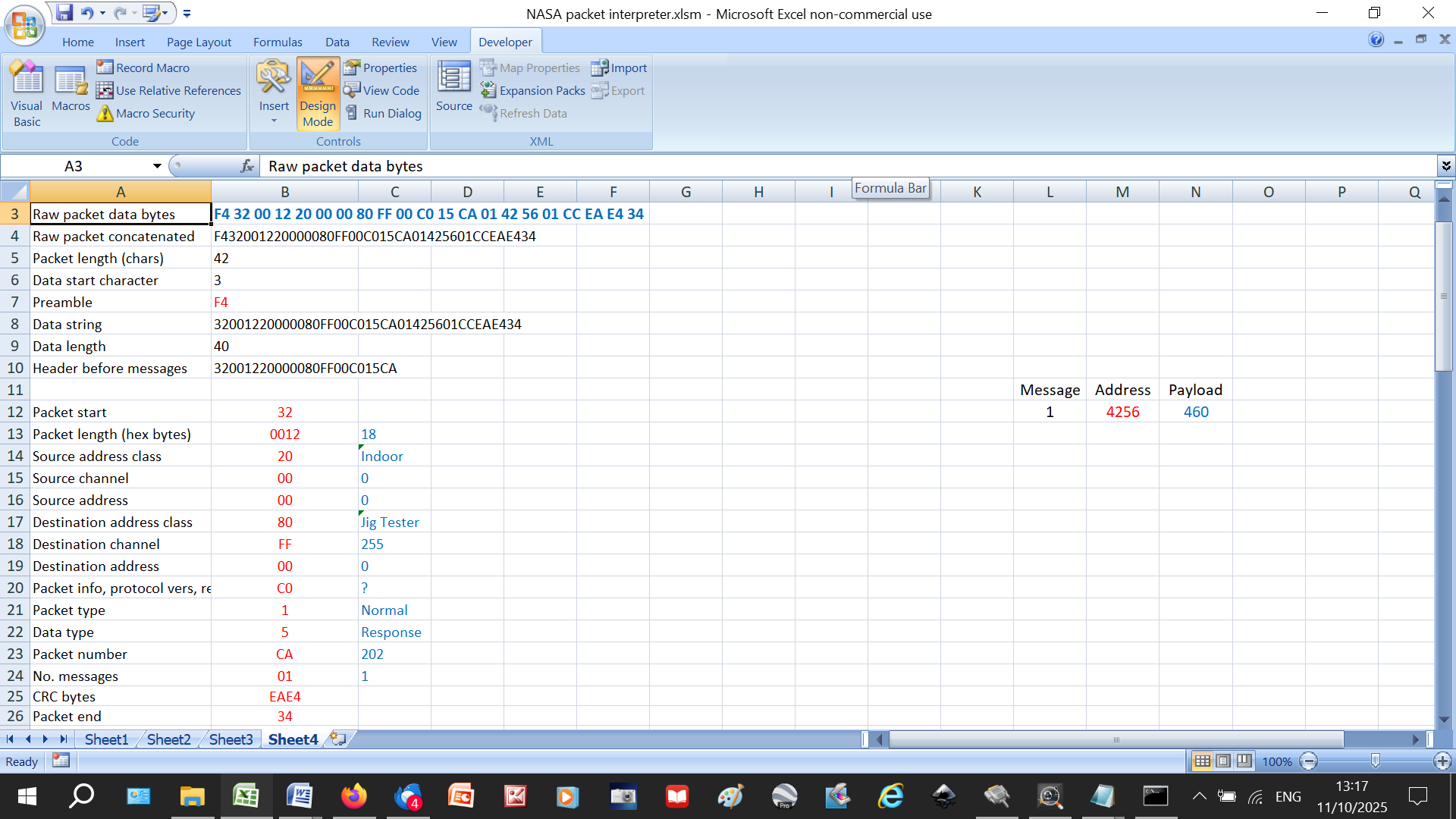

Out of interest, here is the traffic seen by my proxy when I change #2021 using SNET:
[2025-10-11 10:40:21.644] [OUTGOING] (120 bytes): (100 x 0x55) 32 00 12 80 FF 00 20 00 00 C0 12 CA 01 42 56 01 CC 62 3B 34
[2025-10-11 10:40:21.790] [INCOMING] (52 bytes): 7D FD 32 00 30 10 00 00 B0 00 FF C0 14 0A 09 82 33 00 44 82 98 00 00 82 A8 00 44 82 A9 00 44 82 AA 00 00 80 3F 00 82 43 00 00 82 35 00 00 80 BF 00 DE 60 34
[2025-10-11 10:40:21.811] [INCOMING] (4 bytes): F9 FD FD FB
[2025-10-11 10:40:21.842] [INCOMING] (21 bytes): F4 32 00 12 20 00 00 80 FF 00 C0 15 CA 01 42 56 01 CC EA E4 34
You can see the Response to the update request coming back a fraction of a second later:
Interesting stuff.
My choice of FD etc. was based on what I saw in the ‘scope traces coming from the Outdoor and Indoor Units. I can’t easily reproduce exactly what they were sending, as their characters were 4 bits long, but as far as the receiver is concerned it should look roughly the same at the RxD line of the UART. I could easily have reproduced the 100 x 0x55s instead, but I don’t think it is terribly important, or even needs to be there at all on a lightly loaded bus.
I just copied what I saw the Modbus interface was sending, with the source class changed to WiFi Kit so there wouldn’t be 2 Modbus interfaces on the same bus in case that upset things. I don’t really understand what the channel field does. The address is more straightforward. Looking at the data sheets for commercial devices that talk to the NASA bus, they mention that the addresses of the devices on the bus can be set manually or automatically. I guess in our systems it is done automatically at start up and the outdoor and indoor unit get address 0
The difference between Request and Write is interesting. The response to a Request is an ACK, whereas the response to a Write is a Response, so you can immediately tell that the write has succeeded.

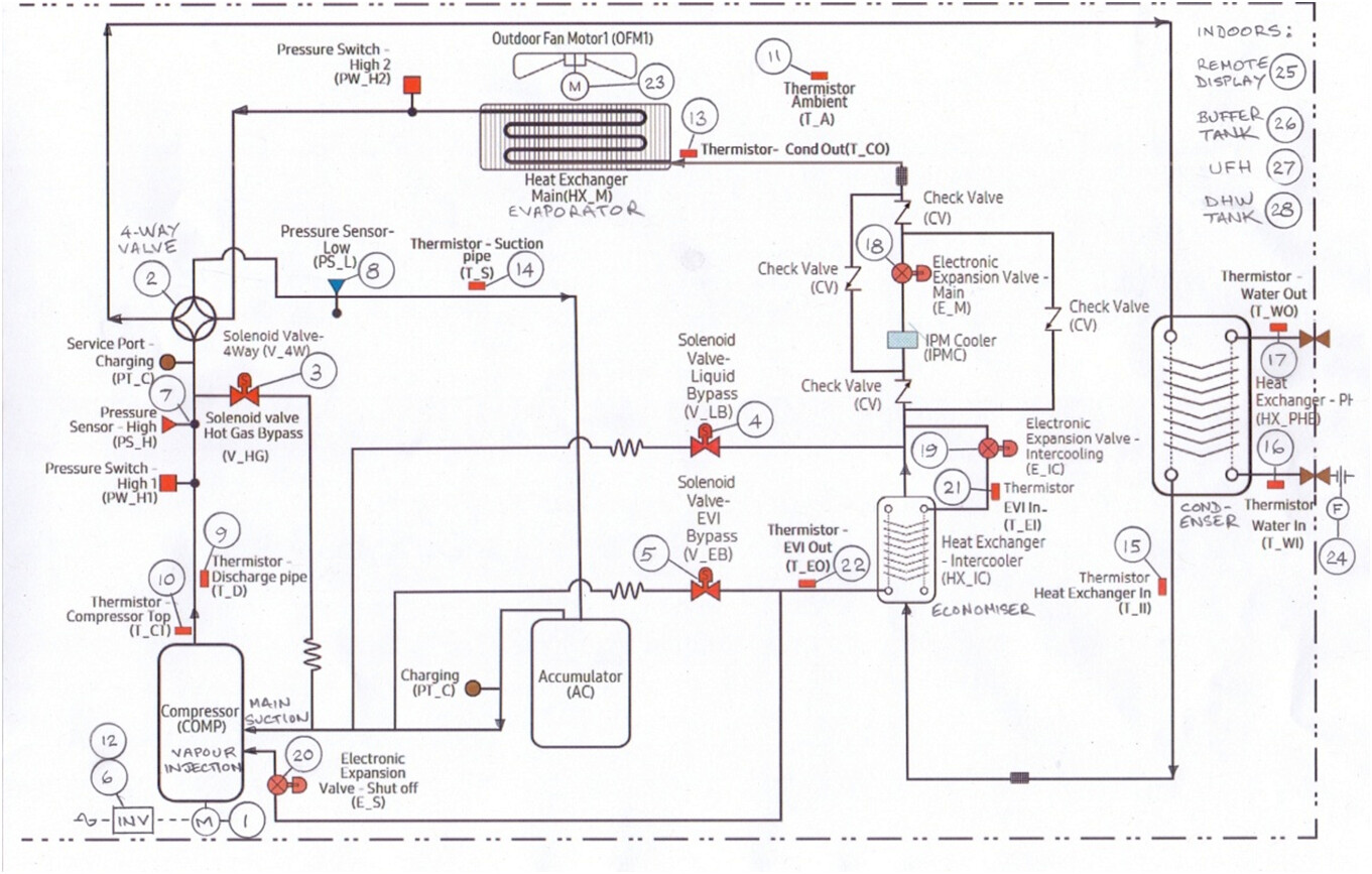

For my reliability testing I started adding in decoding of more registers, so I thought monitoring the refrigeration circuit would be interesting. It turns out you can’t monitor the Evaporator Out temperature on a Gen 6. Reading Suction Temperature returns a value of 0xFFFF (which seems to be the value returned for unimplemented features, despite it also being a valid temperature). Looking at the P&ID for the Gen 6 confirms there is no such sensor, whereas on the Gen 7s there is.
Can you post the Gen 6 PFD here please Alun? (It doesn’t seem to be on the Midsummer website - normally my go-to for technical data.) The HTQ series is far better instrumented…
…even though some Samsung terminology is a bit confusing (like they call evaporator inlet “condenser outlet” - probably a relic from the days of air conditioners).
[I wonder how suction pressure is controlled if there’s no suction temperature sensor?]

pp. 202 has the standard Gen 6 diagram, pp. 201 has the HTQ (but not as detailed as yours).
Yep, although the Samsung naming is consistent with AC cooling terminology, some of the comments added in Samsung NASA Codes document are (helpfully?) wrt to AC heating. Confused me until I got graphs of the measurements and thought “that’s not right, and that’s physically impossible”
No, the only reason I would need SNET is to update firmware. I would imagine there won’t be any updates now since the Gen6s are getting a bit long in the tooth, but that was one of the reasons I bought one. From an (old) engineers’ perspective, you don’t buy something that’s hot out of the development labs (because it’s going to be full of bugs) you buy something that is just about to be superseded (because most of the bugs will have been kicked out of it).
That remains a mystery. I looked at the wiring diagram for the Gen 6s and it does have more sensors, both temperature and pressure, but they are marked as optional. Looking at responses from candidate registers they all return 0xFFFF, indicating not implemented/fitted.

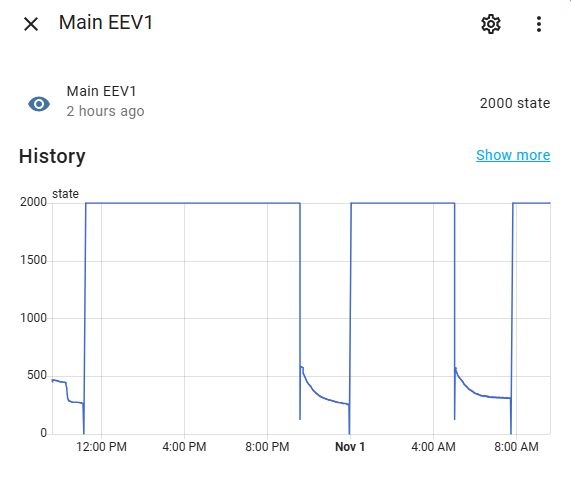

I have a question that SNET might be able to answer. I am looking at what I think is EEV position, register 0x8229. It seems to return values between 2000–0, which I assume corresponds to 100–0%. When the heatpump is inactive it sits at 100%, and immediately goes to a few % on start up. It occasionally wanders about between 100 and a few % during operation. What does the EEV position value look like on your Gen 7?
For me, through F3/F4 as it’s not connected to F1/F2 bus but through the indoor controller, I don’t have any value, the controller must not be storing the value from the outdoor :-
Maybe Samsung just look up the saturation temperature at the known suction pressure (using the table at the bottom of NASA.ptc), perhaps adding a small margin to account for a bit of superheat at the evaporator exit. What I see on my HTQ is that suction pressure is maximised consistent with ensuring (just) a couple of degrees of superheat at the exit (and similarly, that discharge pressure is minimised consistent with ensuring that the R32 is just a couple of degrees subcooled at the condenser outlet). So, 2 variables (suction and discharge pressure), and two knobs to twiddle (main EEV and inverter frequency). There’s likely some complicated interaction in the algorithm, but I’m inclined to suspect that the EEV is the main actor in suction pressure control, and inverter frequency in discharge pressure control.
On the subject of EEVs, yes you are correct that 0x8229 is the main EEV, and that 0-2000 is the digital output to the EEV actuator. Whenever the compressor is stopped the controller opens the Main EEV fully to flatten the circuit pressure, thus minimising the risk of compressor damage from reverse flow. (On the HTQ, it also also opens the compressor recycle valve for the same reason, but it looks like there isn’t one on the Gen 6.)
As for Main EEV position, mine spends most of its time modulating in the range 200-400, but hits 2000 during defrosts.
