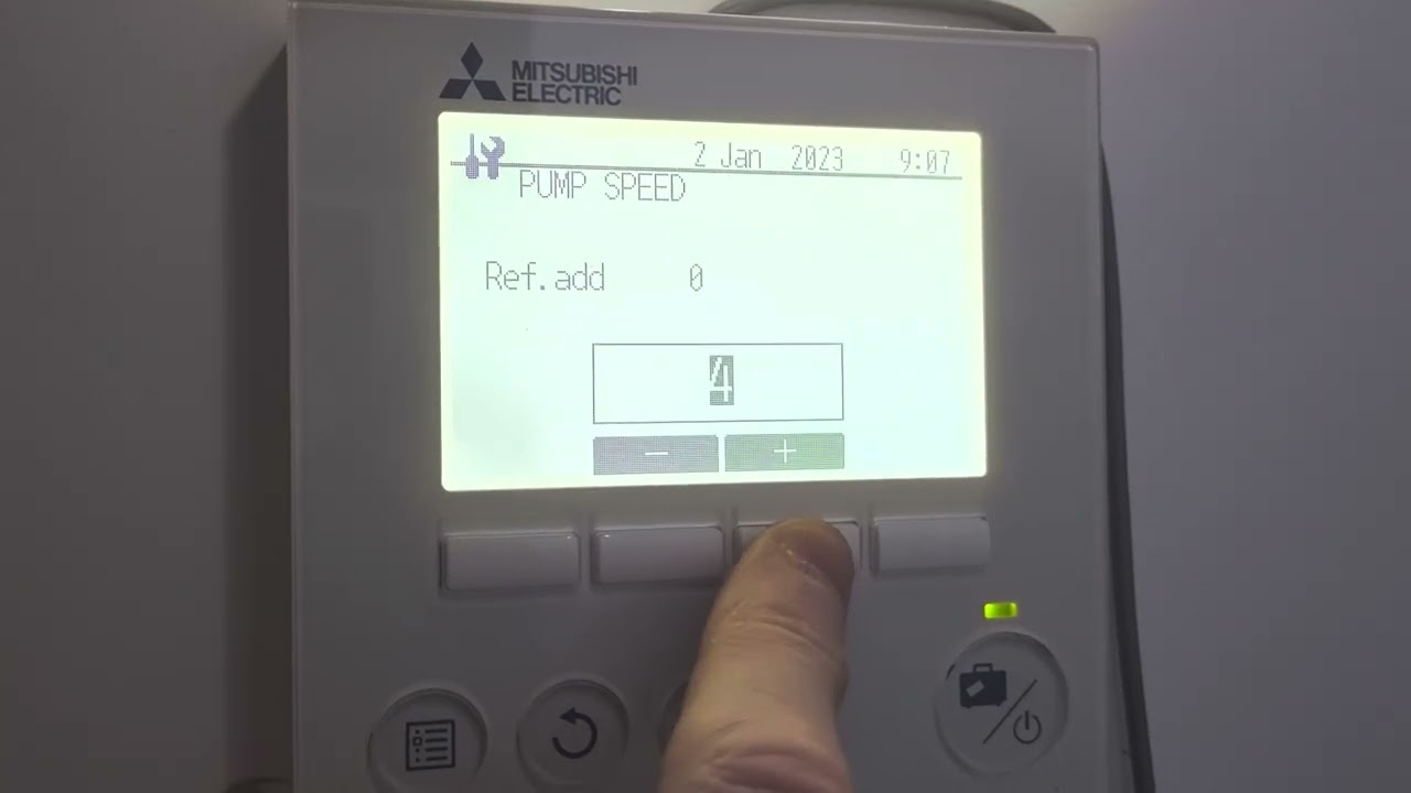

You can ask the FTC to tell you what it thinks the flow rate is by going to “System” → “Running Information” → enter in 540. See this video for a guide (skip over pump speed bit). Compare that to what the heat meter reports.

On the Ecodan, is pump speed fixed at the setting chosen in the 540 variable? 1,2,3,4,5 etc?
Or is there a PWM option? Ie, it auto adjusts?
Also, is there a pump inside the outdoor unit? Or does the Ecodan always have an external pump?
W
The system has always had glycol in it. Whether it was ever set up correctly is another question!
COP is already looking more reasonable. Is the other sensor also secure?
Two different things here: The pump speed is set to a fixed speed, 1-5.
540 variable on the Running Information screen tells you the flow rate in litres/minute.
