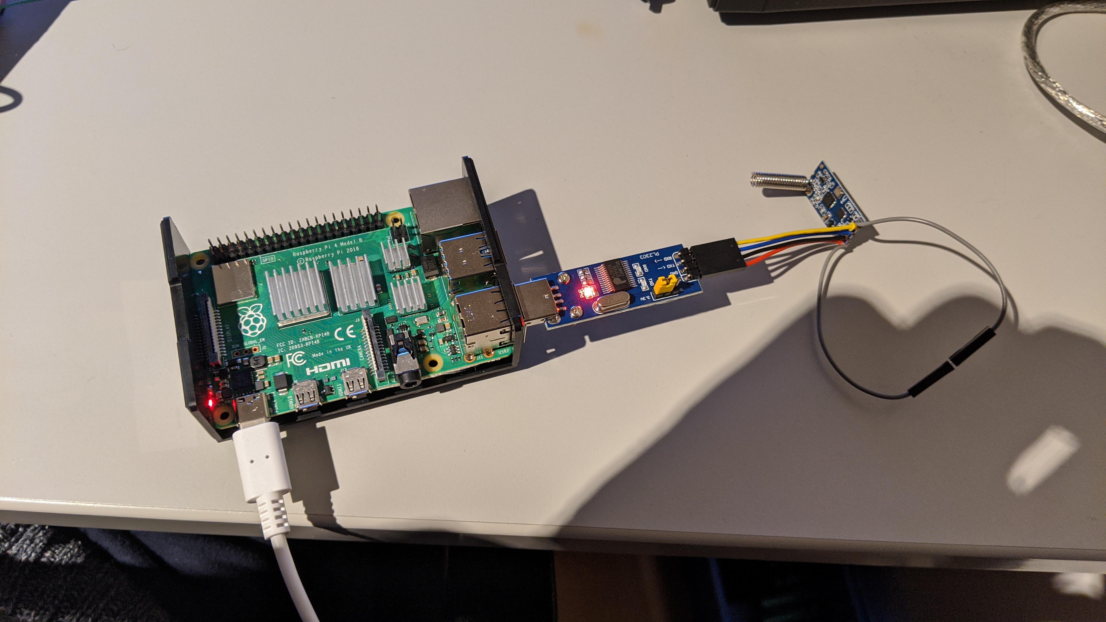

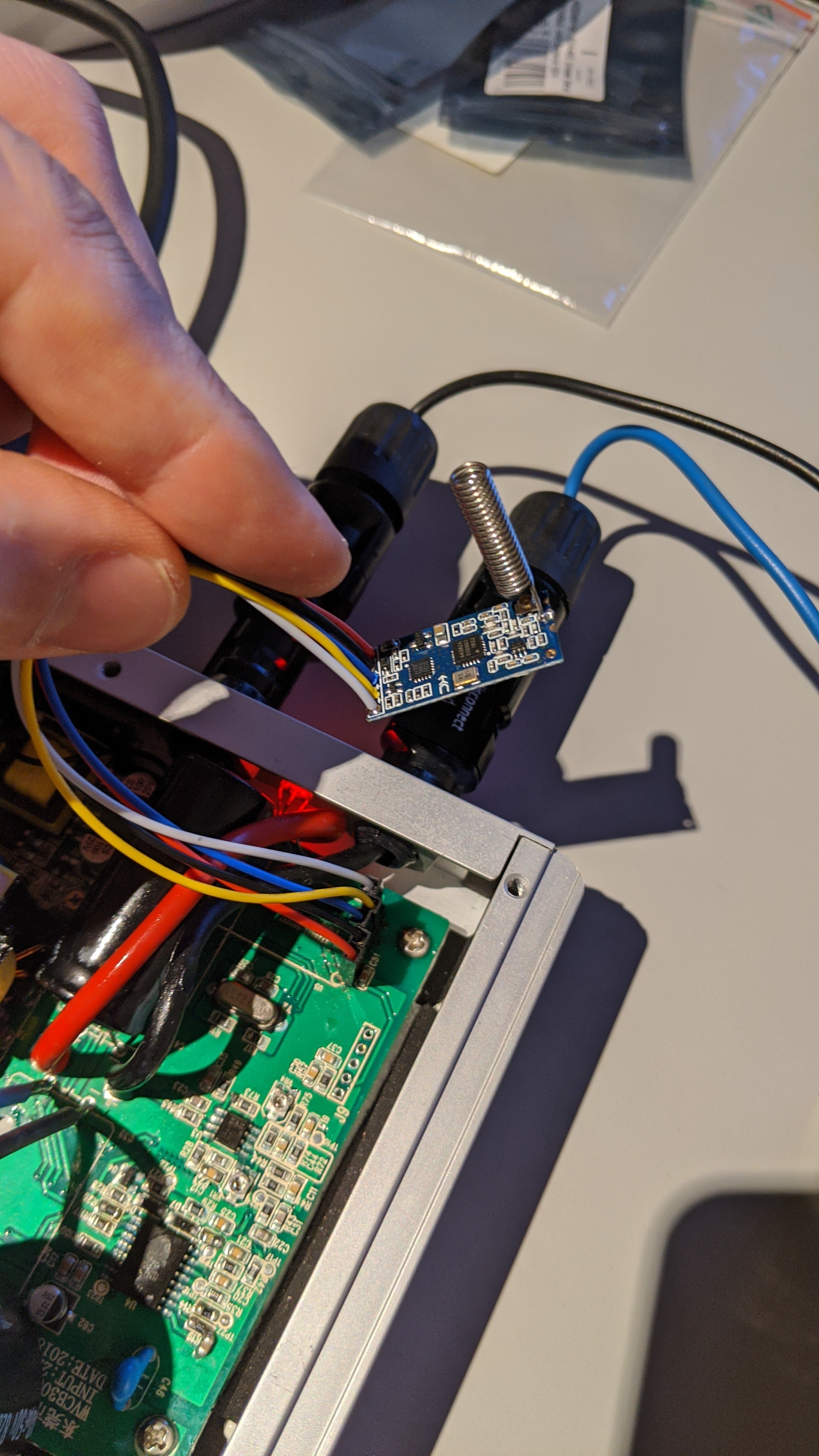

Now i changed the HC12 in the Inverter and I am realy sure that the communication between the both HC12 works. But why i cannot get a respons from the WVC300. And the dc voltage is also connected. Hmmmmm. maybe its too late, maybe I have tomorrow mor luck.
My problem is that I don“t have any modem
ID or powerID because I use a PI for the communication.

@Rene_Baars you can use uart pins (raspberry) for HC12.
So, now I have time the hole night to try every combination of bytes to get a communication. I have to use the USB to UART Adapter, because I need the UART on the PI for further Connections.
I will give you my results of my tries. :blush:
Do anyone have a R3, a WVC-WIFI-Modem and a HC12? With the combination it should be easy to find the Right masage like @SuperNinja did.
curious now that you took out the original hc-12 what are it’s setting and if you hook it up to usb serial does it work for you talking to your other hc-12s…
I ask because there are two frequencies used on the r3 inverter 433mhz and 470mhz that are factory set 433mhz is for the r3 modem connections and the 470mhz is for the e-box connection – the reason I ask their might be completely different protocol for the 470mhz connections versus the 430mhz
I checked the configuration with the ā€œHC12 configuration Utilityā€. It has the same Settings like the factory Settings.
  • 9600 bps
  • Parity = None
  • StopBits = 1
  • DataBits = 8
  • Channel = 1
  • 433,4 MHz
I made a connection between the ā€œInverter HC12ā€ and a ā€œnew HC12ā€. I connected the RxD and the TxD from the ā€œInverter HC12ā€ together. After this I sent a string over the ā€œnew HC12ā€ to the ā€œInverter HC12ā€ and I got an echo. So, the connection between the two HC12 works.

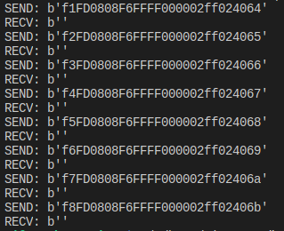

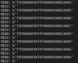

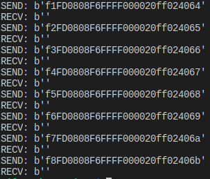

Try to bypass hc12. Check common voltage levels and directly connect Rx Tx to the inverter. It will speed up your tests. You can try my bruteforce script. Maybe you have better results than me.

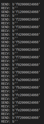

Try
f5[inverterid]68
Replace f5:
F0 f1… Ff
No feedback from the Inverter…
Try to replace 2000 by:
0200
02ff
20ff
you have to change the end byte to match-- this is the serial port connection via the wireless r3 modem - whether it is pass directly through or altered as in what the r2 modem does is unknown currently

No luck…
in your first picture you look to have 1 to many ā€œ0ā€
edit: never mind you just shifted down the 2 placement
