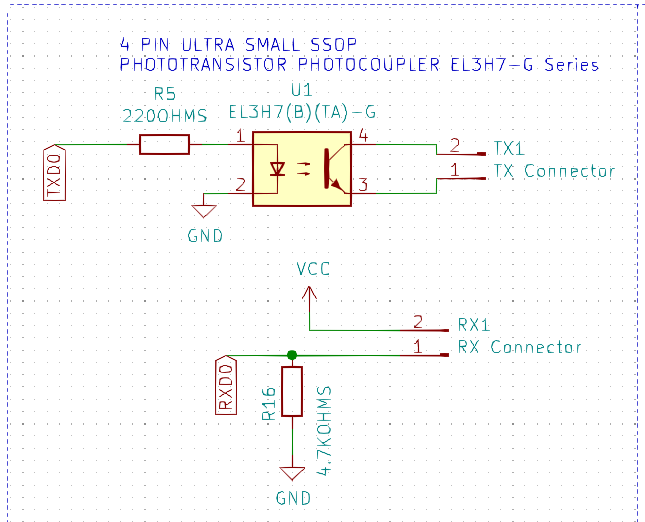

Hi @volkergi1970, If you look at the V4.21 or V4.40 of the modules R5 is the resistor which feeds the EL3H7 optocoupler - this is 220ohm already.
This should be feeding 10mA of current @ 4.2V cell voltage.
Part R4 is in the voltage divider

The R4 in your diagram should be 220 ohm if it emulates the existing module TX lines.
The MOSFET is purely there to invert the RX logic ?
My mistake the resistor on TX side stay’s as original.
Yes it only works as an inverter

@Albert I did a quick modification to the controller circuit based on your design - screenshot below.
Does this resemble what you have built?
How’s the testing going?
@stuart Yes correct this is what I have done. Last thing I changed was R29 from 47K to 2K2 That is now running from yesterday evening on till now without any error even with the motor with brushes (sparking all over the place) in between the wires. I’m still hoping @volkergi1970 is also testing this mod as I’m curious if in his situation it also helps.

Are we getting a bit mixed up here?
This is the V4.40 circuit, the optoisolator is driven by a 220 OHM resistor (not 2K2) - I make that about 10mA driving current - this obviously varies across the 2.0 to 4.5V range that the cell could be at.
