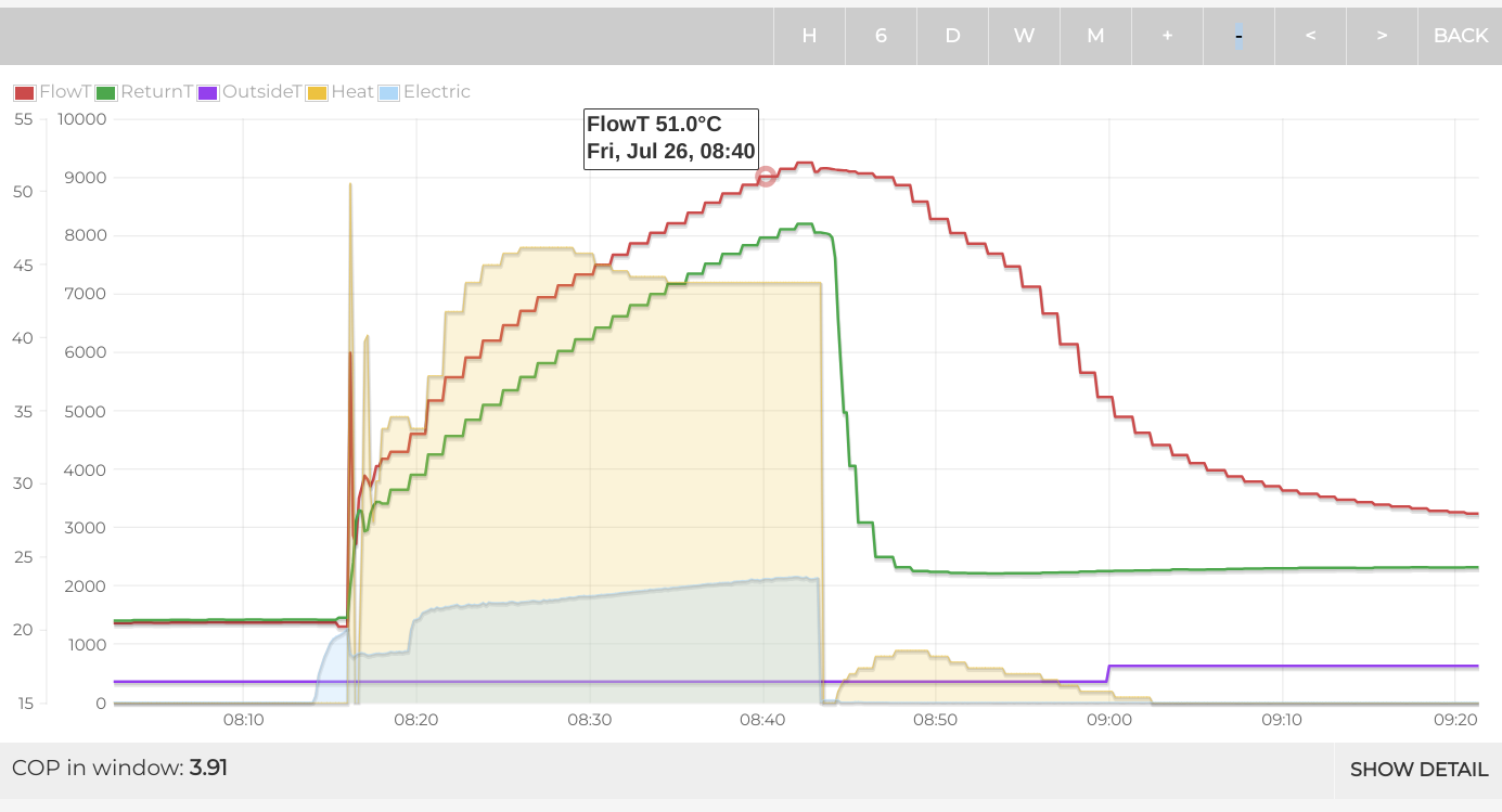

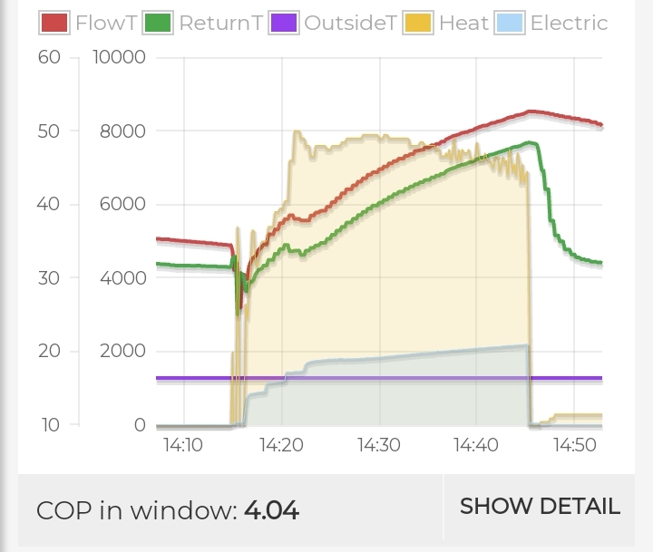

Early days, but the DHW cycle does look better. Note how the measured heat continues until the end of electrical consumption, as it should.

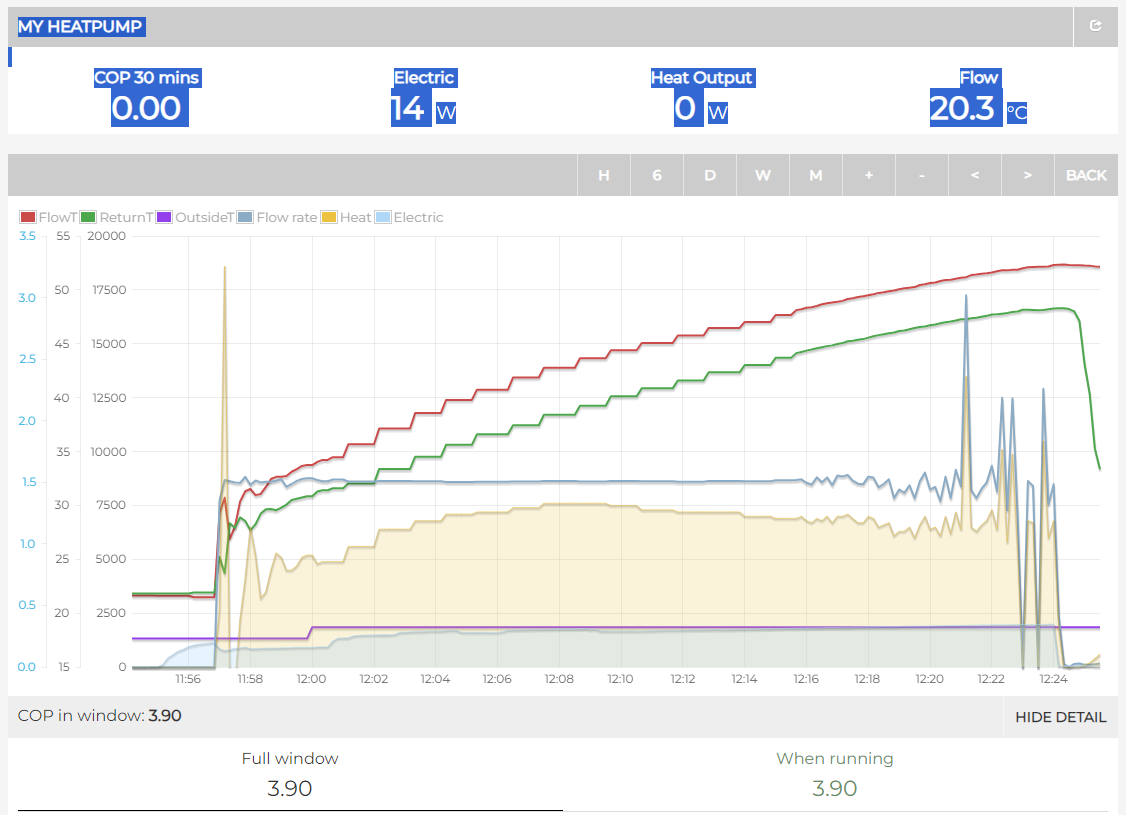

Yes, the last cycle has been perfect. If you check the box to show flow rate you should see a nice steady flow rate, if you see oscillations or the flow rate dropping out before the end of the cycle, this indicates an issue. It looks like the air issue has been resolved. I don’t think adding inhibitor has anything to do with it though.

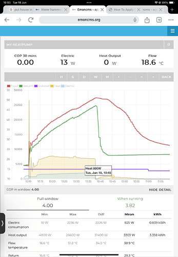

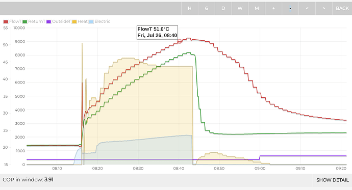

I just looked at latest hot water reheat, is the spike up at 10:10am today normal along with the continuation of heat being produced after 10:40am with no electric being used this time?
It’s hot, but not delivering heat. (flowrate is zero after 11:40 as is compressor electricity)
Looks like the microbubble separator does the job nicely!
That post doesn’t mention any fault with the meters, the post references the error which can occur due to trapped air in the system. Air in the system is very common and inevitable for a new system, it usually resolves itself assuming the air has somewhere to be released from the system.
Great to see it looks like the issue has been resolved on your system :+1:

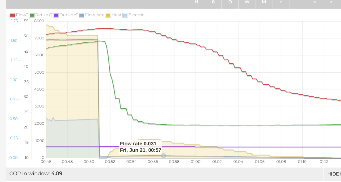

There’s a small amount of flow rate at the end of the DWH as the residual heat in the pipes is dissipated into the heating system, it looks like a thermosyphone since the pump is not running? I don’t think it’s anything to worry about, it’s a very small amount of heat 0.181kWh
Adding the microbubble separator has worked wonders here…should they be a default on all systems?

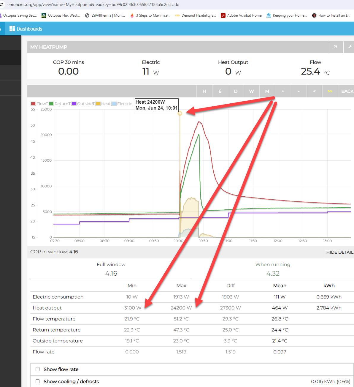

Are these spike ups normal giving Min Max in full window figures which don’t look right

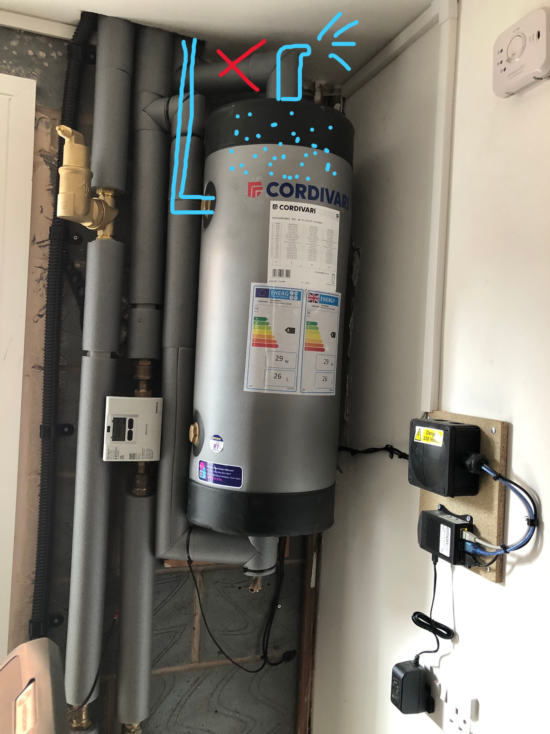

Also looks like your air issues aren’t cured, and they have done a terrible job of piping up that volumiser (why not go in the side and air vent at the top?). My 12 year old has more of a clue than Octopus do it seems.

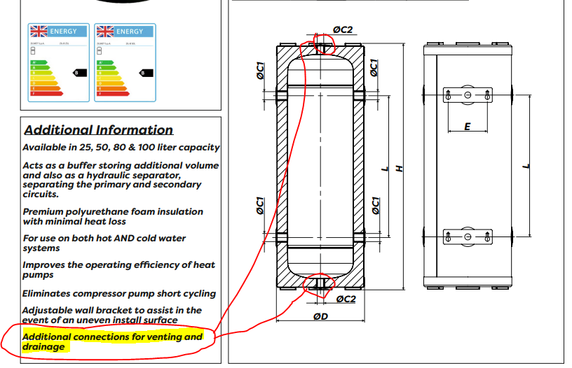

Just why they have plumbed the volumiser up like this i really don’t know. If they had gone in the ‘side top’ tapping (as I’ve shown below) it would allow an air vent to be fitted in the top of the volumiser to release any dissolved air in the fluid (the velocity slows down inside the chamber and will naturally release dirt/air at this point)? Currently it just gets stuck in the volumiser and can go back into the space heating circuit when heating is turned off.

Devil’s advocate: if the volumiser were on the space heat only (not the primary) and therefore wasn’t active during summer during DHW mode perhaps having the microbubble deaerator on the primary pipe as-is, AND an air vent on the volumiser, would be sensible?
So where does this leave the end consumer? Back to square one. This is going on far too long. Just want the thing installed properly so I don’t get this hammer noise and any air in system which I thought was resolved. Is it not? I’d also like my water pressure back as it was.
The buffer being used as a volumiser wasn’t designed to be piped in the way it has been. The top tapping is for an air vent and bottom tapping is usually for a drain to remove any sludge from within it.
I am glad they have fitted a deareator but they haven’t thought about the volumiser.

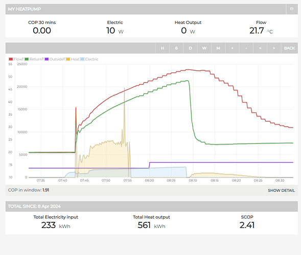

Looking at your OEM it doesn’t look like it is completely resolved? Are you still getting the hammering noise?
Yes still getting a hammering noise though it has changed sound wise.
Again Octopus are coming out on Monday. I am showing them this post. No idea what they are going to do, was hoping they had ordered this part in to get the 3 way valve corrected.

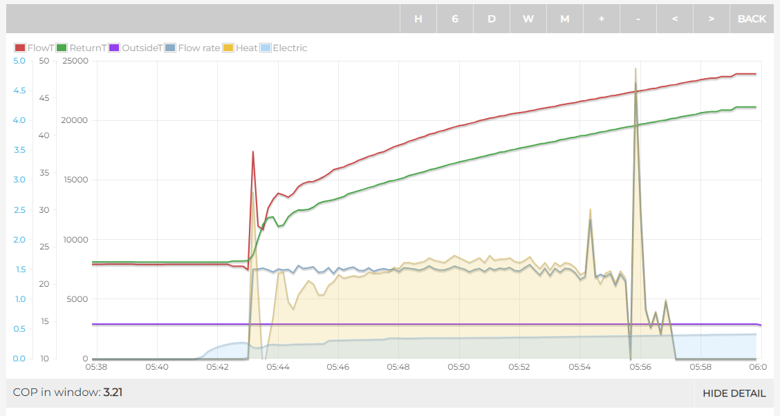

Starting to go back the way it was again on the charts
