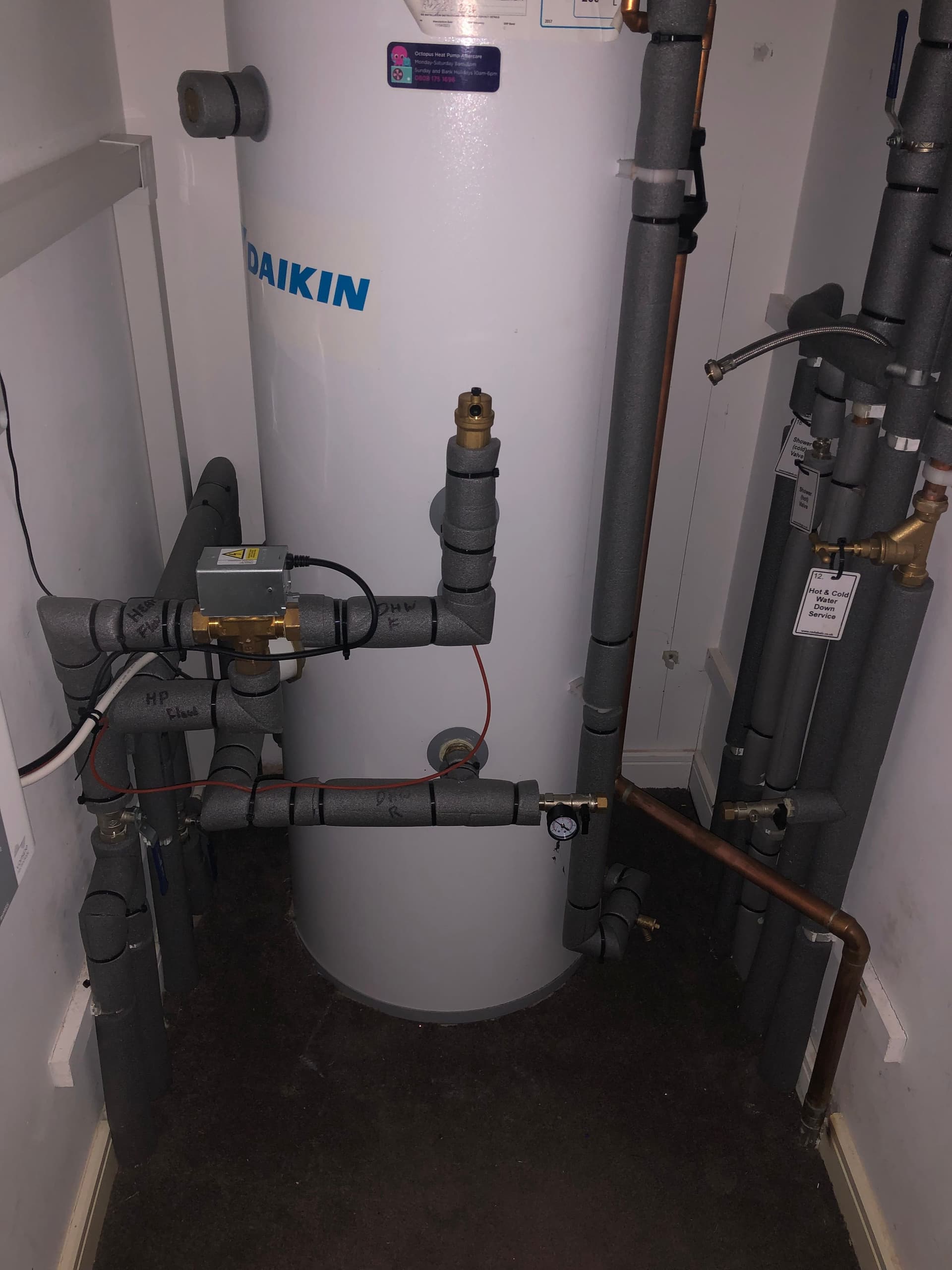

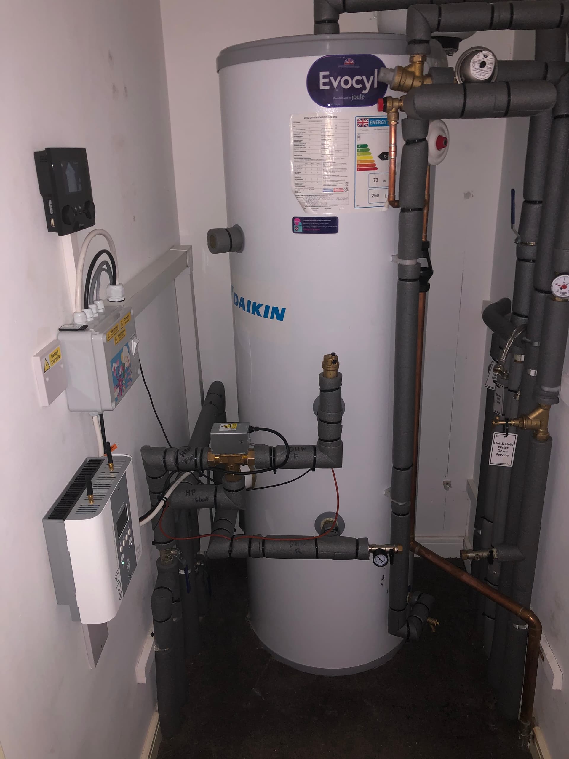

This is a 4kW Daiken Heatpump and 250L hot water tank, The Heat Pump pipes go into the garage at the side of the heat pump by the side door, then straight above into the cupboard where the hot water tank is in a cupboard upstairs above the garage.
I can see from this image…
…that they have used a standard 28mm Honeywell Home diverter valve with the cylinder. In one of your other posts with this YouTube link…
…I could see on the heat meter that the flow rate was 1238 litres / hour, which exceeds the maximum capacity of that valve.
I would say this is some of your issue. This diverter valve would be suitable for the application…

If you look how they have piped this up it’s not surprising this is happening with the heat meter on the return just after the connection tee where the space heating and DHW returns meet.
Lots of these systems are running DT3, so if the system had been running DT5 at 4KW then at best you would get away with it. As I said in my video, personally I don’t think these valves are suitable (especially for mass heat pump adoption), as the fitters setting up the systems just aren’t aware of the limitations of the components they are using, nor capable of the fine tuning necessary.

Differential shut-off pressures of motorised valves is a good example of this, where designers have seen that the valve has a Kv/Kvs value of say 8.6 and assume it can automatically deliver 8600 litres per hour, without fully appreciating the maximum shut-off pressure is much lower than the 100 kPa the Kv/Kvs value was generated with.
The V4044C is not much different in cost to the VC Series valve, but the application difference is night and day.

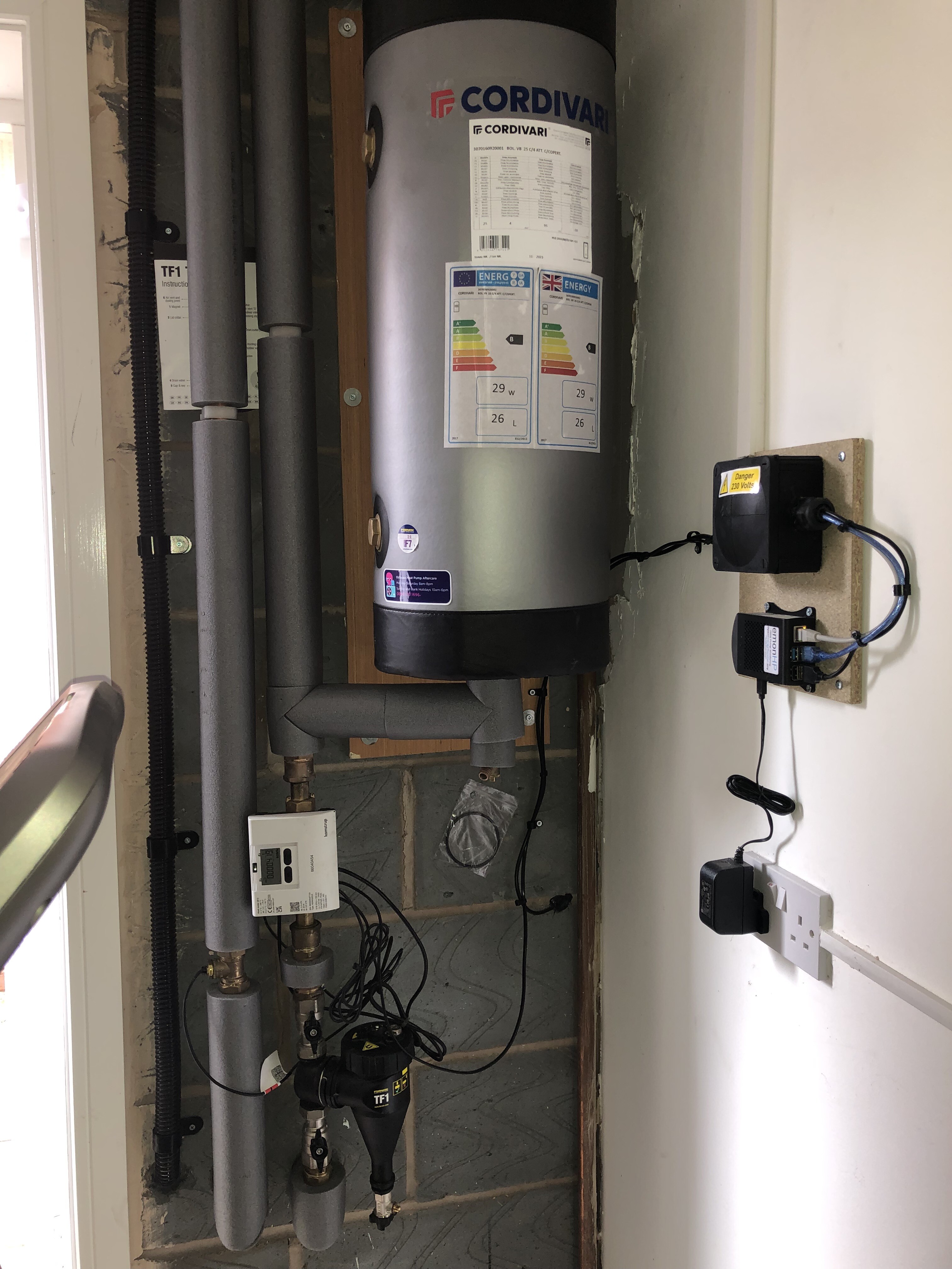

Looking at the installation photos @JustinUK has shown, the installation isn’t terrible, but there are some very clear hydronic design faults including the position of the heat meter.

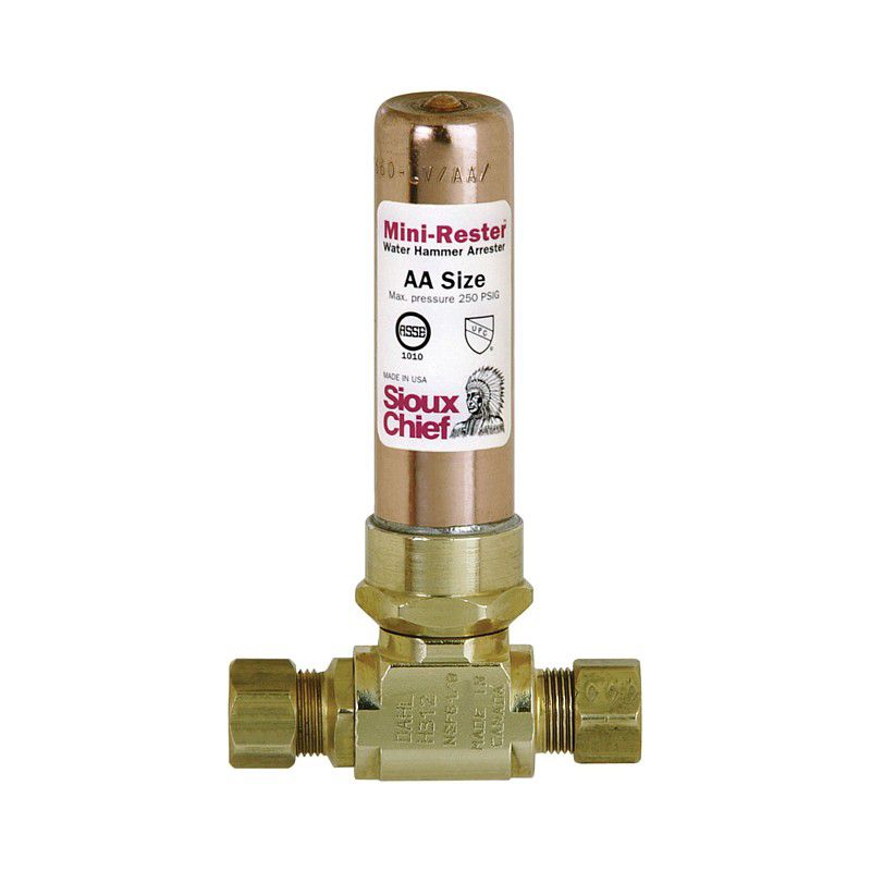

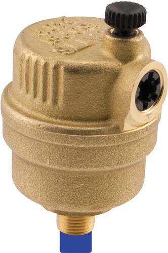

curious you do not put these things on your lines to prevent water hammer
or have automatic air bleeders installed
so any trapped air is released from the system automatically as the system circulates
I was always taught to design things out correctly rather than add things to mask the actual issues.
Auto air bleeds like the one you have shown are only really any good at aiding with initial filling of the system, but can actually cause air ingress if they are left live in the system after this is done (especially when placed on the negative side of the pump/circulator).
With a heat pump you are better to use a microbubble separator on the flow (standard practice) or a vacuum degasser (best practice).

never had problems with mine. it being installed for many years . mine is installed just after the pump on the top of an inverted “T” that acts as an air trap. and it runs continuously when you charge the lines you hear air after 24 hrs it usually quiet. but will bubble for weeks of months before all the air is gone completely out of the system

Ok they did a few more things today as well as drain the system out, as got the water hammer noises when the engineer was here which stumped him
Turned down pressure at the main tap to 2.5 bars
put on a few bits and pieces, don’t ask me what they do I have no idea.
R&D are monitoring it, so am I - if there are any problems they will replace the expansion vessel on the tank.

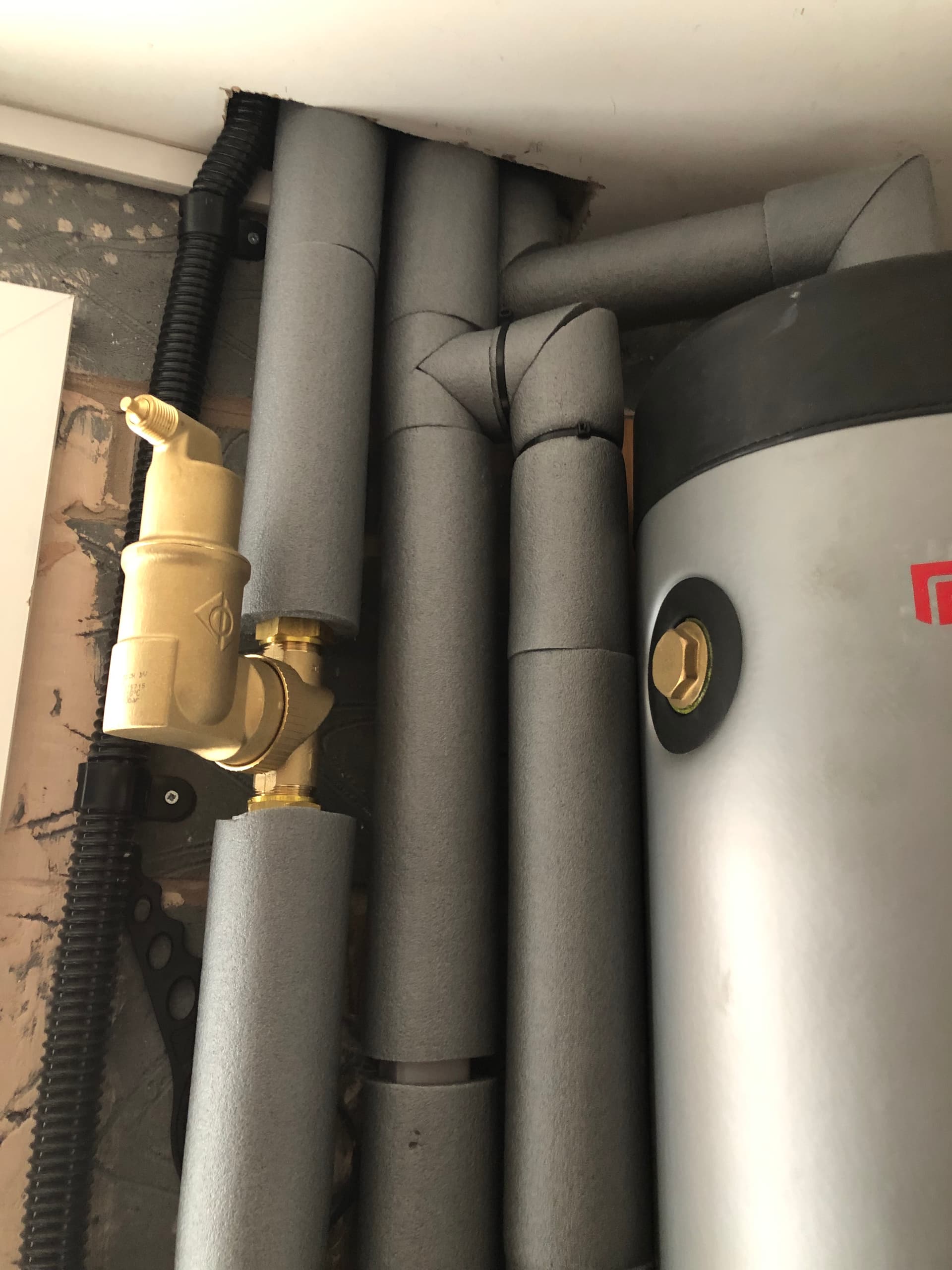

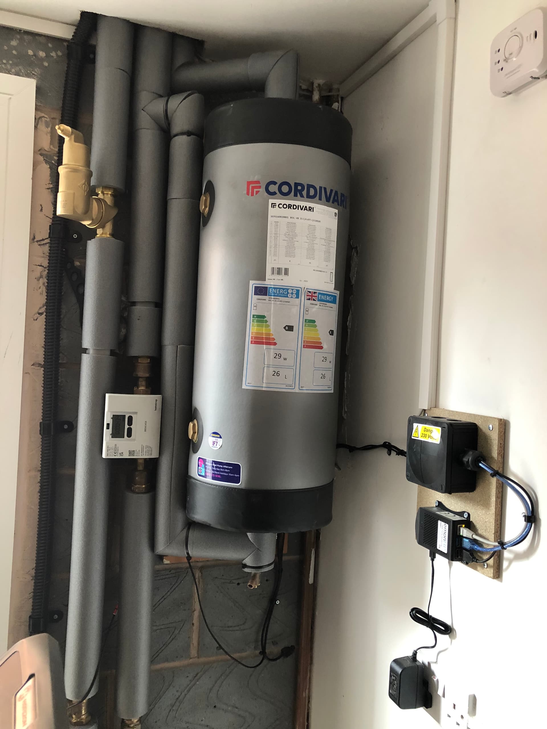

More bits and pieces pics.
Filled it up with 3 of these
Deaerator fitted
Moved the heat pump
Fitted a few new bits and pieces in here and pressure guages
