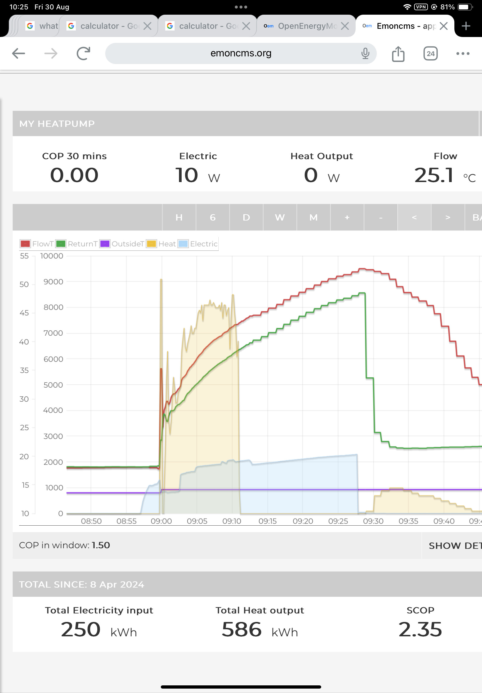

So waiting on @Octopus to contact @MWPHS and Daikin to go over if these parts can be installed as Mark has suggested above to fix this issue which is still ongoing. Octopus say they fit what Daikin supply. Meanwhile still getting water hammer noises, that don’t happen when Octopus are here. :frowning: it’s not as bad as it was initially and they heard that when they came out but it’s still there and charts like this still affecting COP.
They don’t look right, wondering if it is generating heat but it’s not recording on the monitor between 9.10 and 9.30 and then there is the part after where heat being generated and no electric usage.
That’s as far as my knowledge of these things go as a end user, I’m not a engineer but these things don’t look right.
