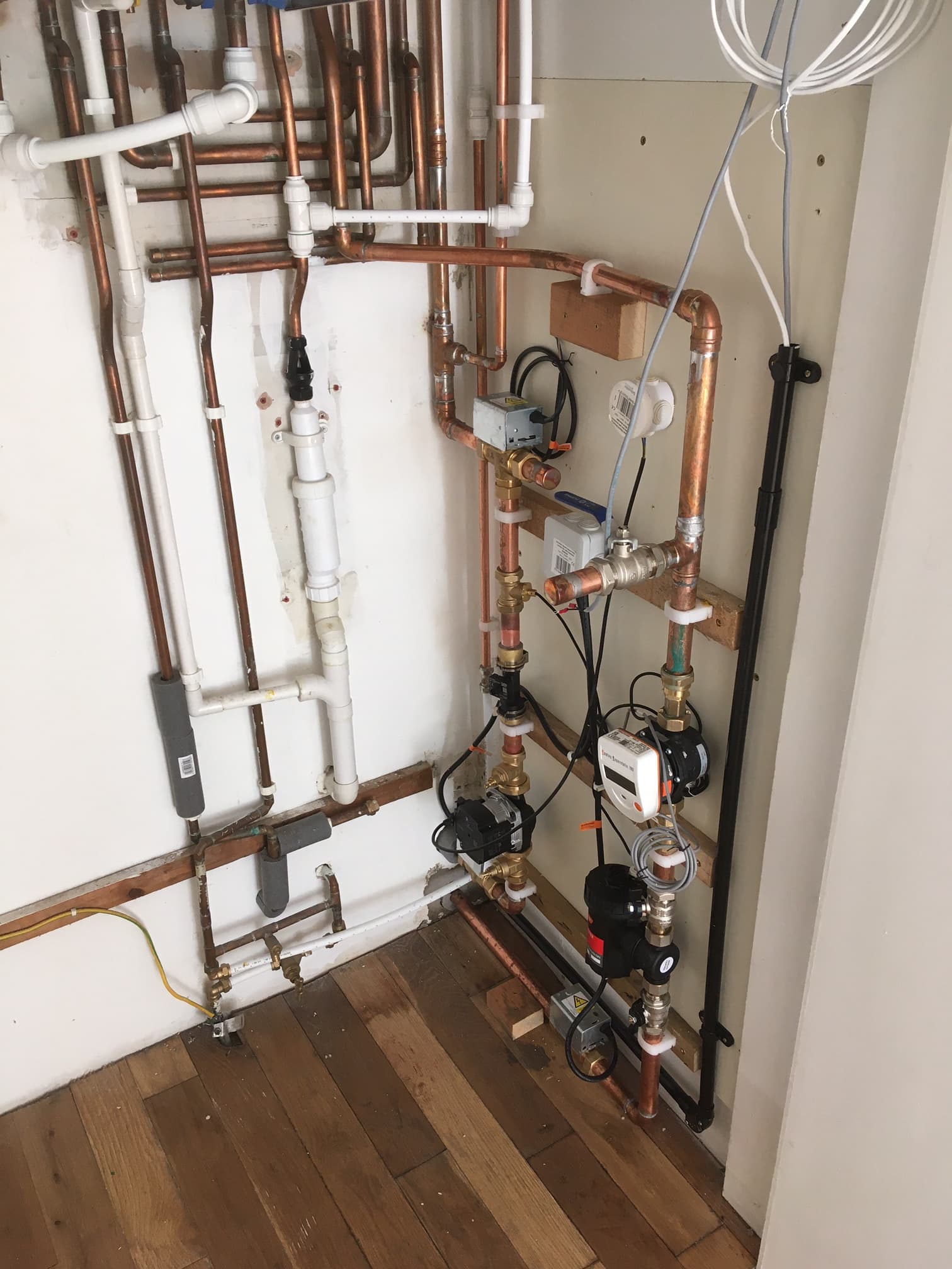

The meter is located on the return pipe to the ASHP there are no buffers or headers.
I will attach a picture of the install in another reply as the video seems to have mucked up the upload

yes, something like that, Im guessing? who installed the heat meter?
Twas I :slight_smile: I installed it all
ok great, worth draining down cleaning out the heat meter and trying again?
Its a bit of a pain if I dont find anything wrong with it Trystan. Unfortunately I didnt put isolation valves either side of it. Could you send a replacement that I could pop it, if its the meter itself thats faulty? It seems a bit of a stretch imagining something that could slow the flow mechanism without stopping it altogether.
