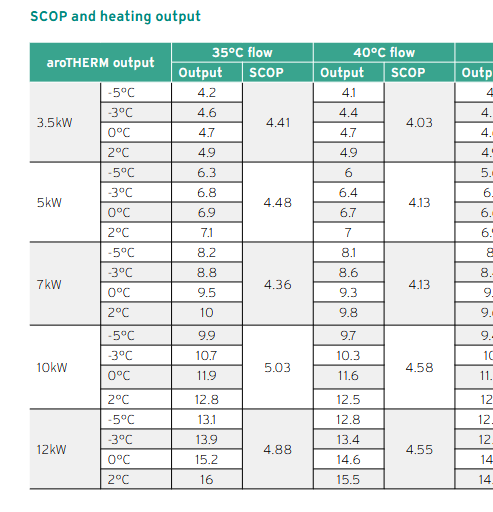

My starting point was this Vaillant data sheet
My guess was that these figures were reasonable maximums but excluding defrosts. The data below is consistent with that guess, and provides some estimates for both. The alternative guess- that the stated outputs in the data sheet include defrost allowances- can’t be squared with the data.
To test the first part I found a V 7kW pump on OEM (#124) that seemed to be working hard in the 11 Jan cold snap. That pump was regularly showing 10.5kw steady output between defrosts at temperatures of c-1 (as low as I was interested in). For simplicity I assumed that actual peak output in favourable conditions was about 10% above the spec outputs at all OATs…

@Simonwhiteley confused how to read this. We are seeing an average of around 6.7 kW from the 7 kW vaillant in the 0 to -3C range, what does your ‘Output kW’ column relate to?
“Output kw” is what the Vaillant spec sheet (pictured above) shows for 35deg flow temp, with some interpolation/ extrapolation from me. (I see the -2 figure should be 8.8kW). Less 20% gets you pretty close to your figures.

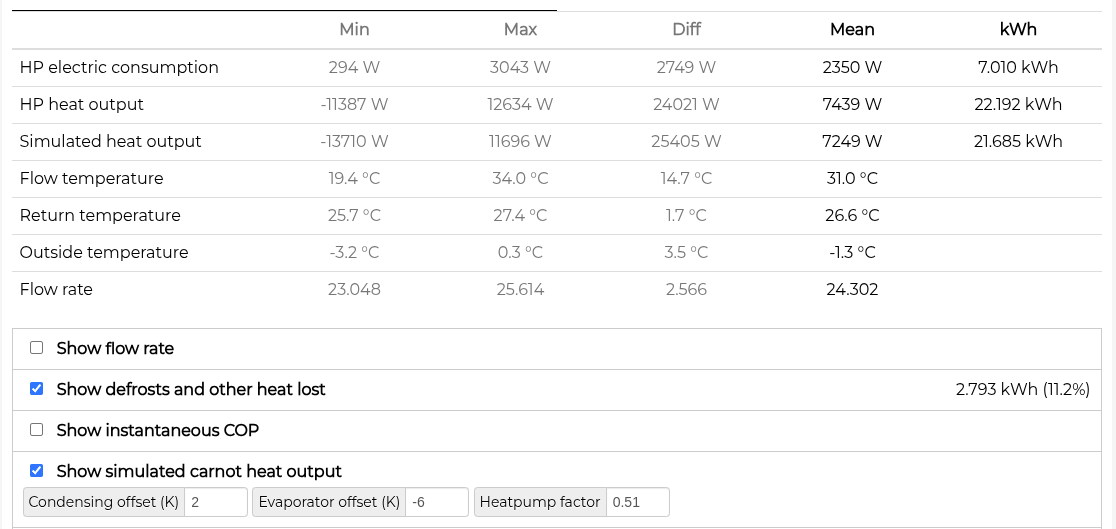

I still don’t understand why you’re estimating defrost losses, when they can be measured directly.

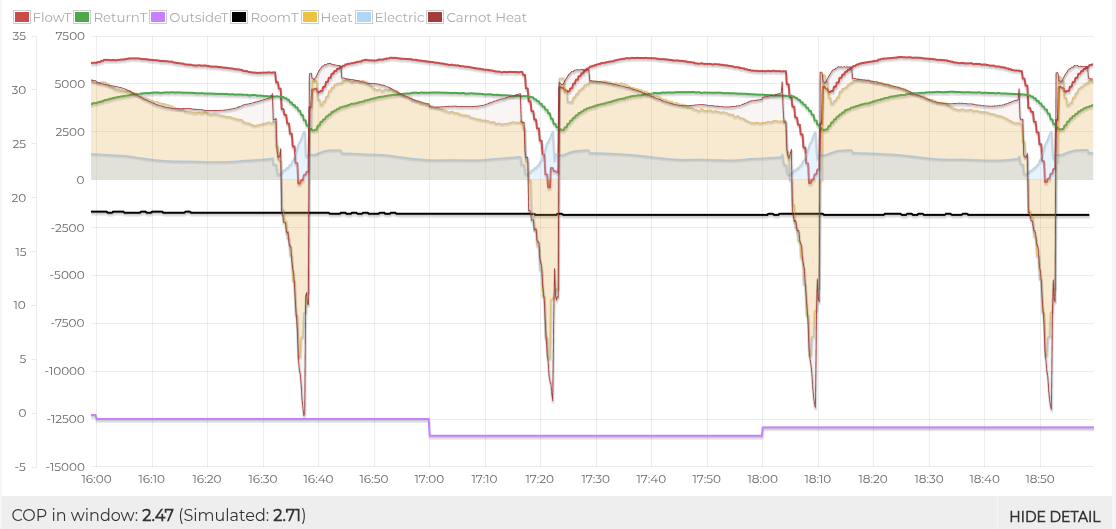

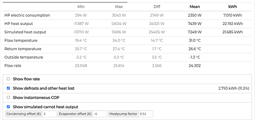

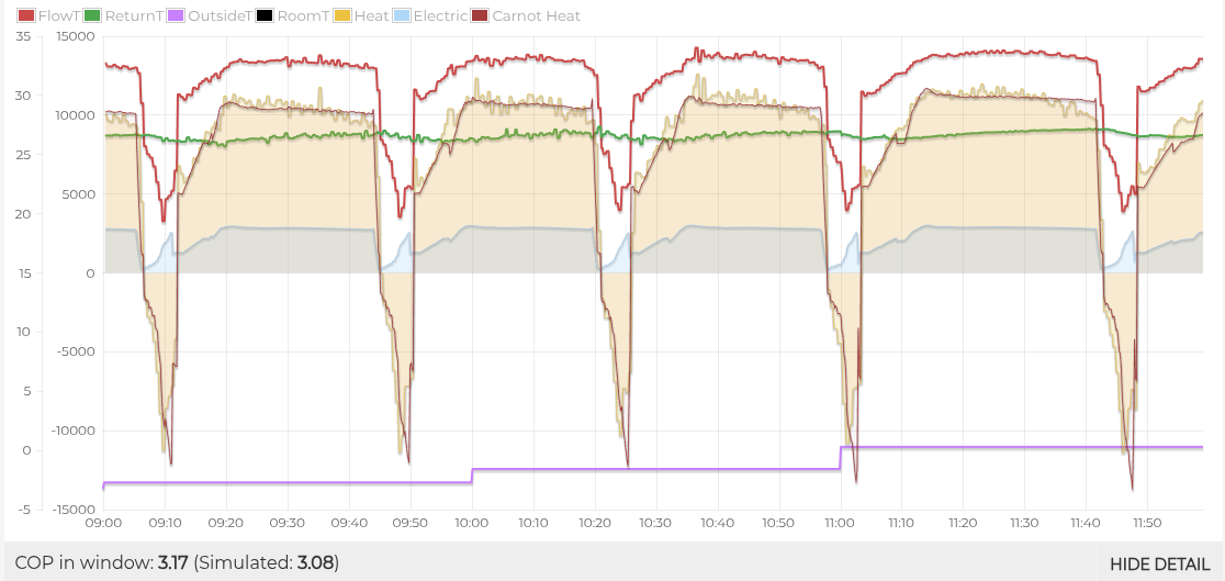

Looking at system #124, specifically this 3 hour period in the morning that saw 5 defrosts with average ambient of -1°C:
  • maximum heat power = 11 kW
  • total overall heat output = 22 kWh (average power 7.4 kW )
  • total heat lost to defrosts = 2.8 kWh (11%) (average power 0.93 kW)
  • heat output is matching the Carnot formula very closely, so no other “losses”

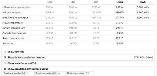

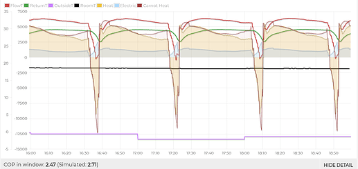

This other random system [#158] defrosting 4 times at -1°C:
  • maximum heat output = 5 kW
  • total overall heat output = 8.9 kWh (average power 3 kW)
  • total heat lost to defrosts = 1.8 kWh (17%) (average power 0.6 kW)
The Carnot formula does show a drop of performance just before and just after the defrost, accounting for another 0.3 kWh of heat “lost” due to the defrost. Less than 0.1 kWh per cycle.
The same system at +1°C lost just 10% of heat to defrost.

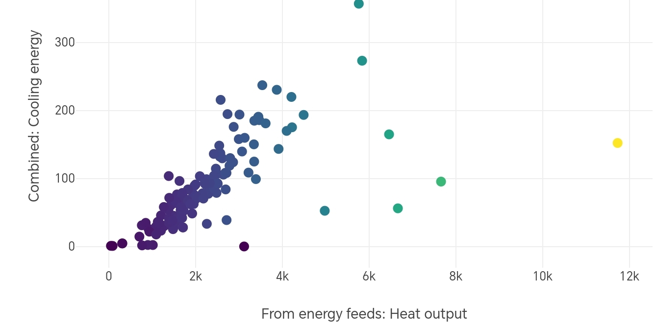

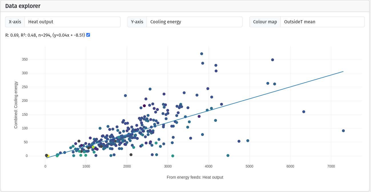

Looking at the aggregate data for 316 systems over January, plotting total Cooling (defrost) energy over total heat output shows a fit gradient of 4%. Some of the most affected systems have defrost energy up to 10% of their heat output. Much easier than examining individual systems.

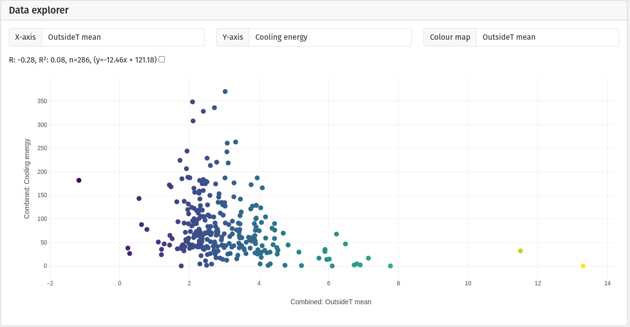

(Plotting against “OutsideT mean” and we’ll see that most systems were running between 1 and 5° ambient, prime defrost temperatures.)
Edit: even amongst only Vaillants, defrost accounts for just 5% on average.
tl;dr heating energy lost to defrosts isn’t nearly as big as you have estimated
