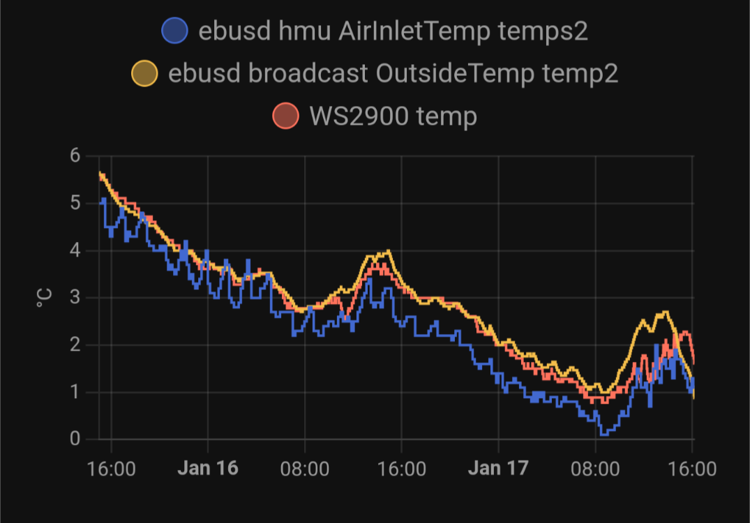

I use the vailant outdoor temperature sensor (via ebus) as input for heatpump app, however the “air inlet temperature” is often a couple of degrees lower than this.
Currently my 7kW is in the middle of DHW run and just did a defrost! Looking at the heatpump app current temperature is 6.8C and it shouldn’t really be doing a defrost, however if I look at the air inlet temperature it is at 4.8C.
Met Office: 6C
Vailant Controller External Temp: 6.8C
Air Inlet Temp: 4.8C
So not only is the a potential difference between actual and met office temperature, but (unless my sensors aren’t correctly calibrated) there can also be a significant difference between vaillants own sensors. Do others also see a difference between outdoor sensor an air inlet sensor or could it be something about where the air inlet sensor is positions or air movement over it, that means it reads differently?

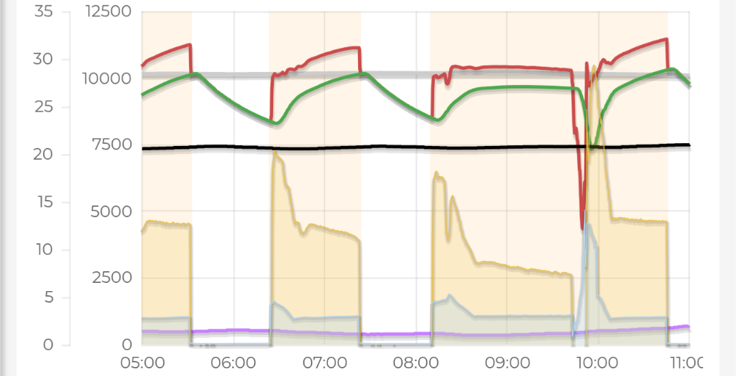

It’s cooled a bit by the air flow, as you can see by the periodic drops when the compressor comes on. Here’s outdoor sensor, inlet temperature and my own weather station.
LHS looks like air inlet temp drops 0.5C below when compressor is on and is slightly higher between cycles (maybe during defrost?). Yet after 3pm on 16th you can see a constant difference of 1C, any idea why behaviour changes?
In my case air inlet temperature seems to drop beween 0.5-1C when the compressor is on, but it’s also around 1.2C lower when compressor is idle. I’m guessing one of these sensors is slightly out. My concern is that if the airInletTemp sensor is under-reporting for some reason then could I potentially be getting defrosts when not needed (like today @ 6C). Did anyone work out what triggers defrost?
I’d expect defrosts to be triggered by the heatpump detecting that the coils are iced up, rather than any external temperature sensor. An under-reporting sensor shouldn’t matter.

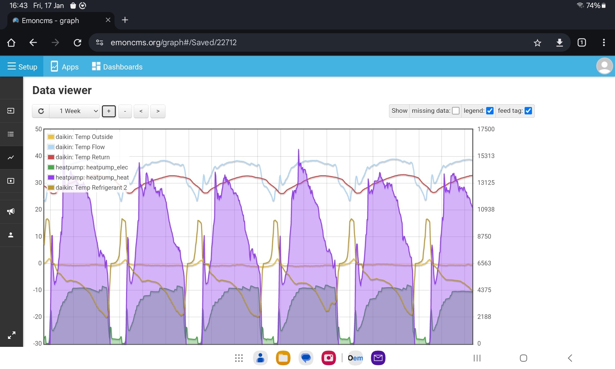

It’s definitely tied to output power because It always looks like this for me. Heat power decays for same electrical input and at some point I get steady state behavior where there should be cycling. Then a defrost is triggered
A Daikin special engineer told me that the refrigerant temp in the evaporator triggers defrosts. This makes sense as with max compressor power the refrigerant out of the evap clearly gets colder as the evaporator loses efficiency ie it picks up less heat from the atmosphere so gets colder. You can see it here.
Put another way …when the evaporator gets close to stopping evaporating then its time for a defrost.

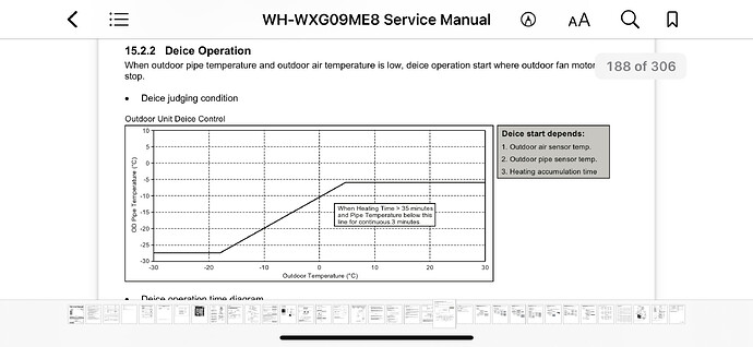

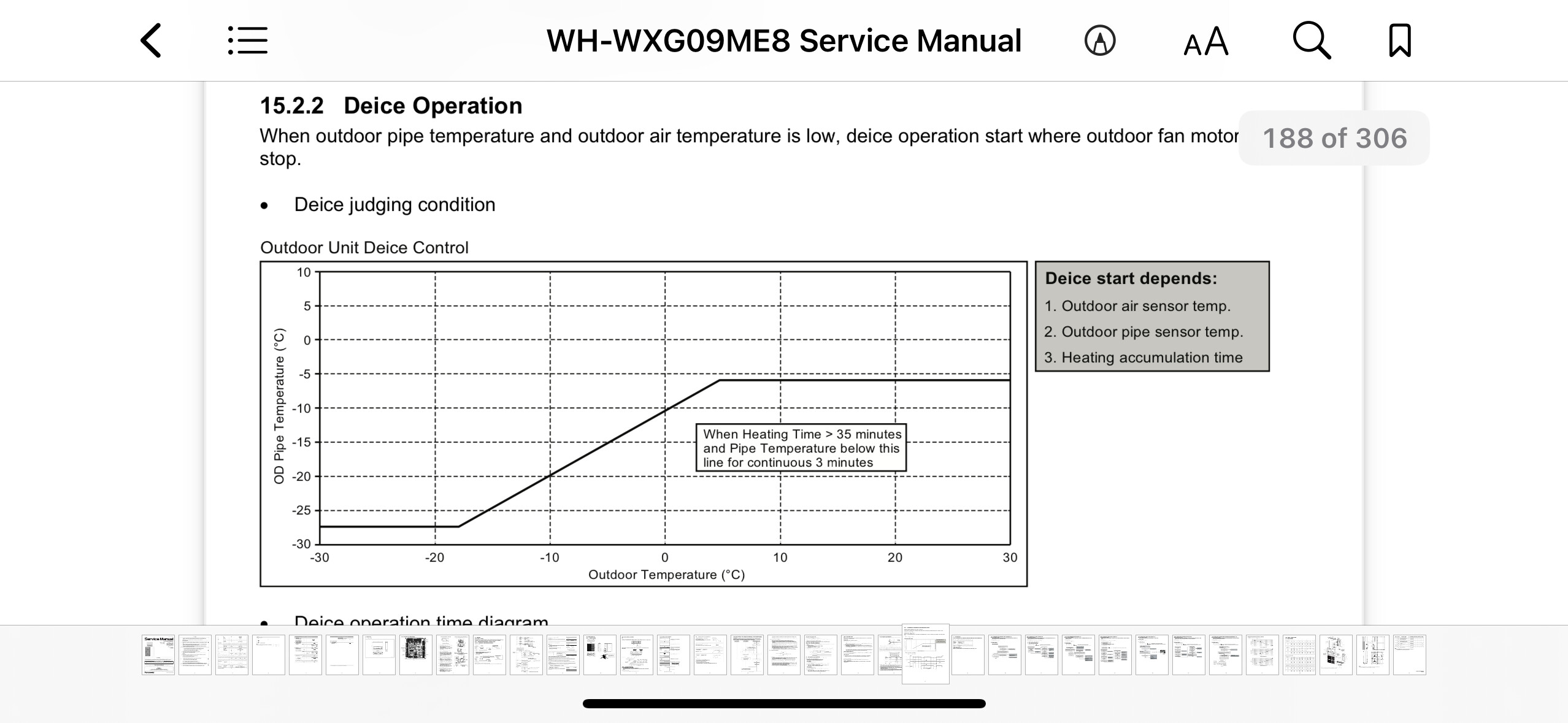

On the Panasonic’s for example, the defrost cycle is triggered on a sliding scale between outdoor temperature and evaporator temperature. So an error in either of these sensors will affect things.

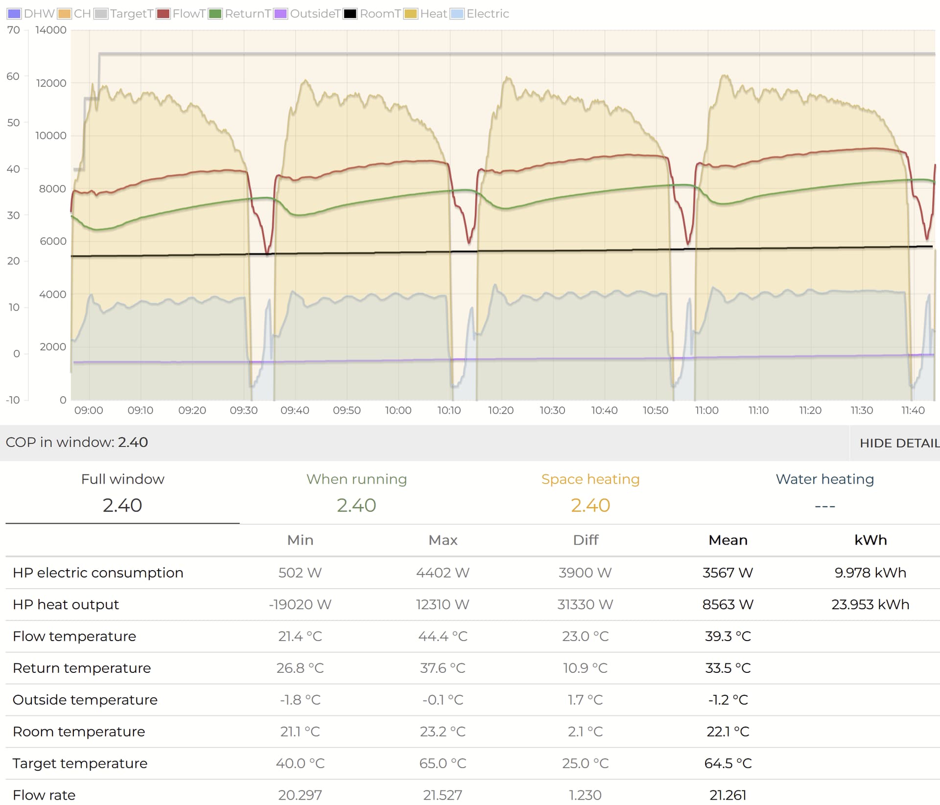

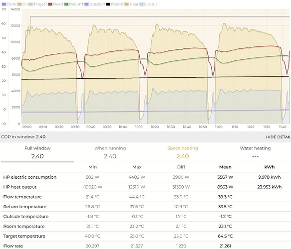

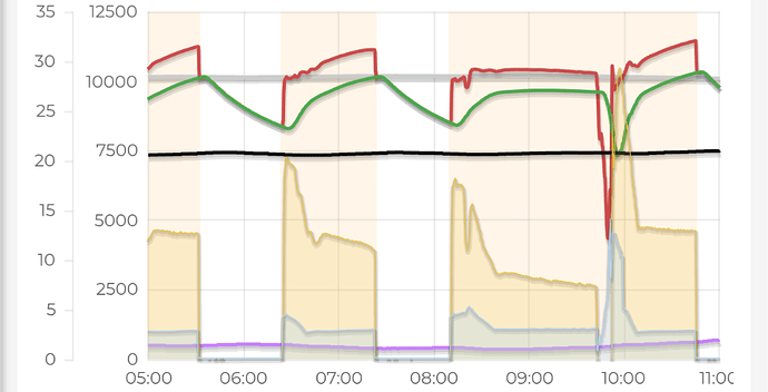

We had some fog this morning in sub-zero conditions, so that was perfect for another test.
At an average -1.2 °C and 100% RH (visible fog), I got 4 defrosts within 2 hours. Heat output at the approximately 40-45°C flow temperature was 11-11.5 kW, which fits the datasheet between the values for 35°C and 55°C flow temperature (given as approximately 12 and 10 kW). Actual heat output with defrosts was 8.5 kW, so approximately 25% less.
