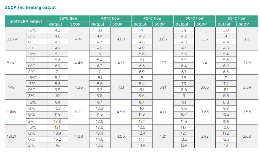

Have come across this thread while researching (as an end user, not installer) various heat pumps for install in the alps (design temp around -12) and obviously concerned about the reports here of lower than stated outputs due to defrosts on Vaillants. Although as mentioned above, high humidity in the UK might play a role. I have however come across something fairly interesting that I thought would be worth sharing here. In the UK (& also Germany), Vaillant markets the nominal outputs as reflected in model numbers as 5,7,10,12. However in Italy (haven’t checked other countries), the unit model numbers differ slightly (S3 instead of S2) and the nominal ratings are 5,6,8,12,15. Looking at the graphs, the units have identical performance. I wonder if this just a regulatory difference or whether due to climate differences they are more confident of hitting the stated outputs.

Worth clarifying that this is not a reason to avoid Vaillant, it’s an issue with many heat pump brands, Glyn was showing me some data on a Viessman with a similar issue just yesterday. In a way it’s not really a fault, it’s just that heat pump manufacturers need to provide better data and then we can design systems around that…
Understood, but it is useful to know given the knowledge, or lack thereof of some installers, especially regarding the 7kW SKU.
Reflecting on this whole thing, I wonder if what’s happened here is that Vaillant engineering in Germany provided the UK sales office with max output capacities (not including defrosts) and that it was these that were used to populate the nicely formatted table in the datasheet that we’re all familiar with. No referenced testing standard is given alongside that table for the capacities as far as I know…

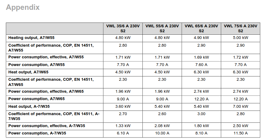

A single referenced EN14511 testing standard full load heat output figure is given in the appendix of the installation manual at A-7/W35 and these figures are much closer to what our tests above indicate, they are still a bit higher, but not nearly as much. Is this whole thing just a unfortunate mistake, not helped by the above table given without context and perhaps given without the UK team realising that it was max output only?
It’s a shame that A-7/W35 is the only full load test, A2/W35 & A7/W35 are partial load outputs. There are also no -7C max output figures in the first table to compare against.
In my opinion, those temperature tables cannot capture this issue because humidity comes into play. We would essentially need output capacity over the 2D parameter space temperature & humidity. I’ve had runs around freezing temperatures with defrosts every 30 minutes or every 2 hours - it’s completely dependent on humidity. At a minimum, there should be multiple tables with e.g. 30%, 60%, 90% RH.
Another unfortunate factor is that this issue does not exist in Germany or many other countries with much lower minimum temperatures compared to the UK. If you have to design for -10°C, there’s plenty of headroom for the defrost dip. As stupid as it sounds - maybe it didn’t occur to them to include design guidance for this “edge case”? They really need to include a big warning to include 25% headroom when the design temperature is around freezing and high humidity is to be expected.
