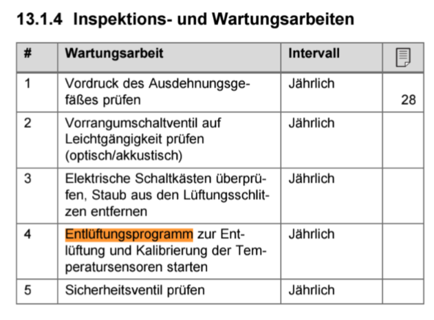

It appears the newer-gen Arotherm devices have a built-in compensation for the sensors. There is an automatic air-bleeding program which detects sensor offsets and sets a delta internally to compensate. The older arotherms also have this program - maybe it would be worth a shot to try whether the compensation is an undocumented feature on them
Very interesting! Where have you gleaned this info about the new-gen Arotherms?
I read that there is an air bleeding mode and temperature calibration on a german heat pump subreddit. Looking at the manual of the latest Vaillant indoor unit for the newer models confirms this:
The service instructions mention running the air bleeding program (“Entlüftungsprogramm”) to calibrate the sensors once a year.
More details in the document (German only, unfortunately)
Nice, I just picked a pair up off eBay for £12, brand new.
Any chance of a translation of the instructions to try this with an existing Arotherm+?
