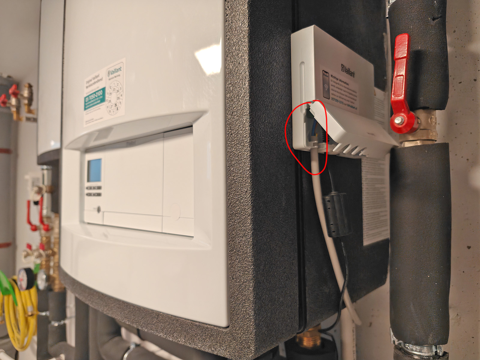

Hi,
I purchased the ebusd adapter and already integrated it into Home Assistant.
But I have a question regarding the connection to the Vaillant Bus.
I have the Vaillant hydraulic station and the Network interface VR921 already connected to it.
Can I now just unplug this marked cable and split it to both the existing Vaillant Network interface and the new ebusd adapter? (= connect them both devices in parallel) and then it should work?
Thanks!
Yes exactly, that’s also how I did it
Thank you very much! :slight_smile:
