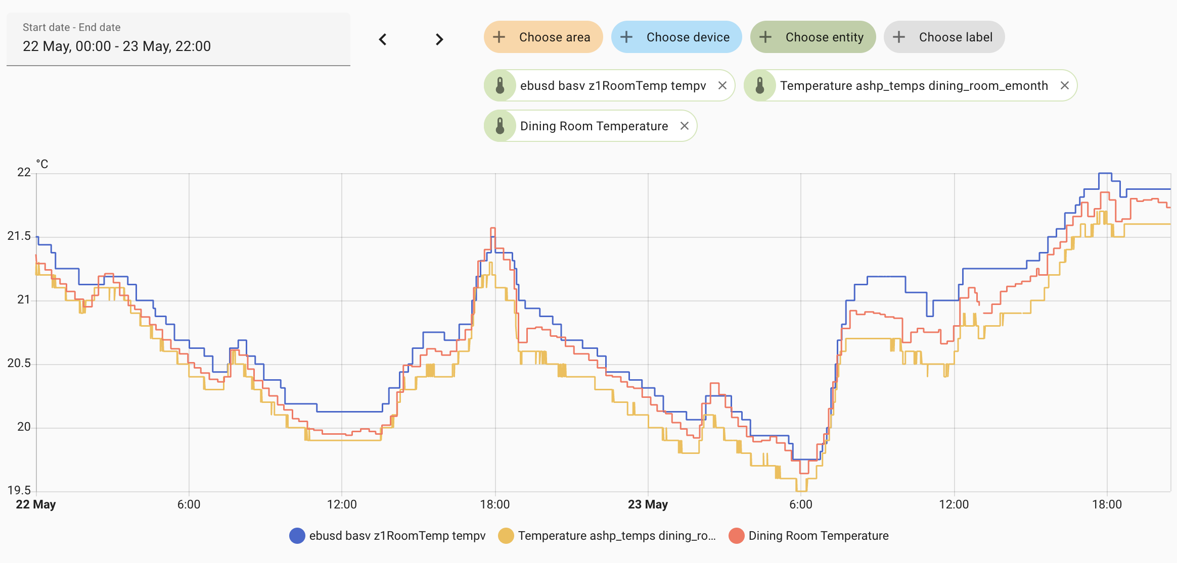

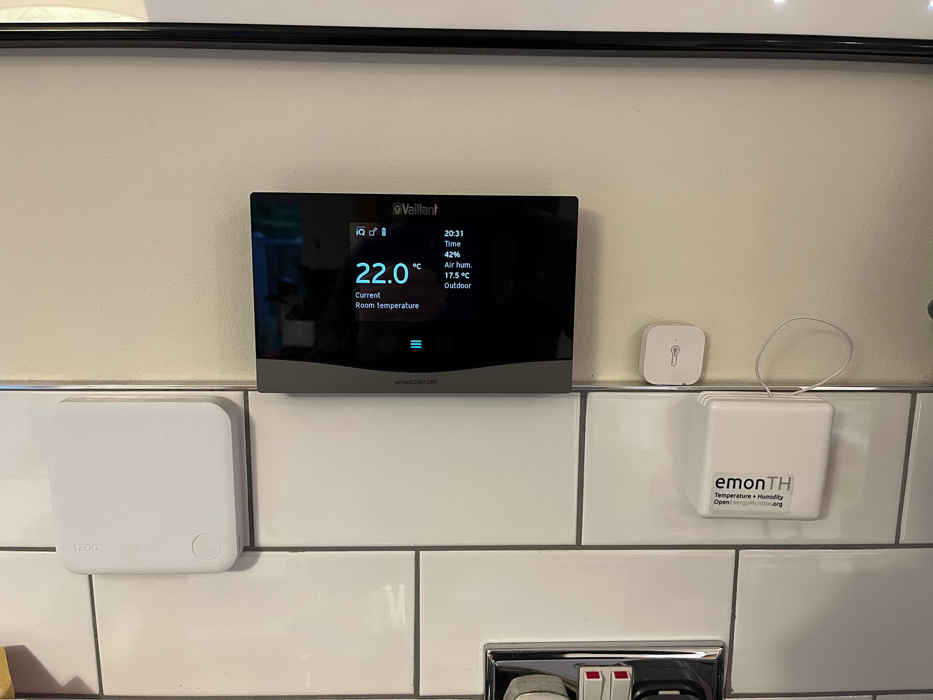

I’m convinced my wireless sensocomfort reports higher than anything else (the other 3 thermostats in the same place)
Anything between 0.2 to 0.5C and beyond difference.
it also seems super sensitive to noticing a bit of heat (see just after 6am this morning).
I did try altering them, but it only allows changes in 0.5 steps. Which can be too big a jump!
I’d love to write a bit of an automation to poke into the offset to match these sensors up.
ie, check difference and then alter to the offset every 5 mins or so.
Because the sensor comfort (and the Havenwise controller) both use the internal temp from the senso comfort to make flow temp decisions (as part of the ‘active’ room temp mod)
