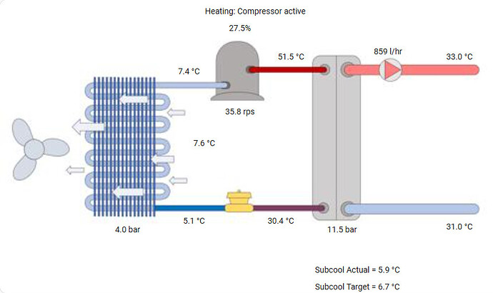

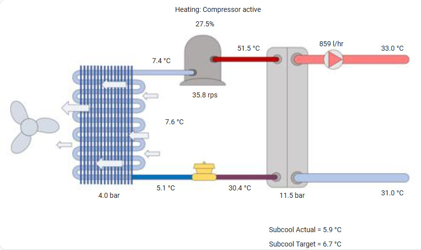

I have now managed to get (Nearly live) data streaming onto this backdrop. (updating 1-4min) will need a better app to view on, the HA card isn’t very customisable and doesn’t view right.
Big thanks to Mick and Andre, (I’d get you a pint at installer Mick but unfortunately wont be there this year!)

What tutorial / link did you use for the backdrop and positioning the data on it please ?
Didnt have tutorial.
I drew the fridge circuit on another platform, saced as pic. And just used picture elements card on homeassistant dashboard.
Its really not a good element though, looking for better ways to set it up. Ideally something that will save a screenshot of that picture at various times, or something that i can move a time slider and see it all change on the pic woukd be ideal

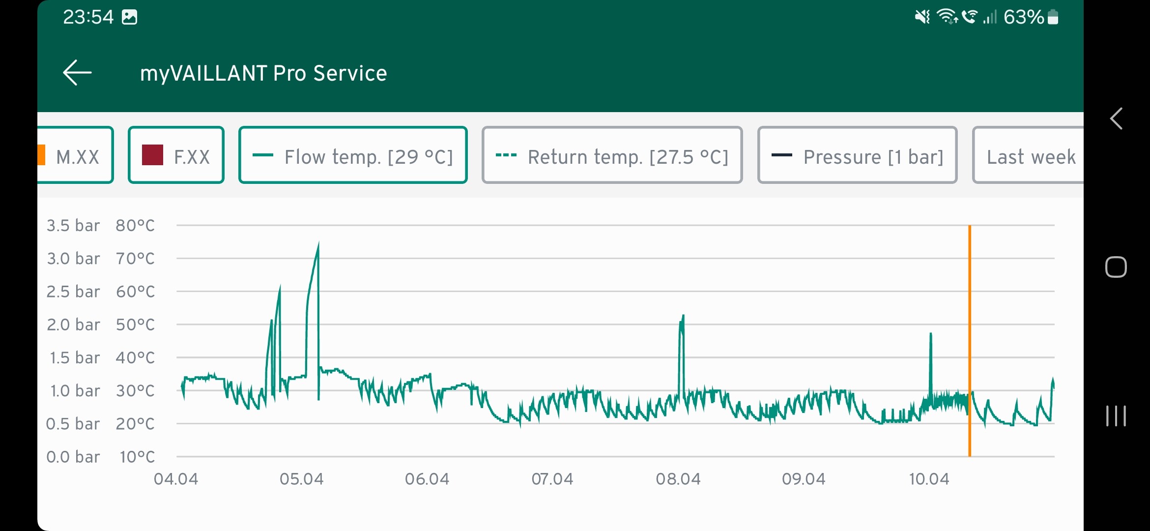

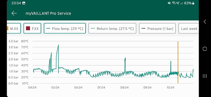

Ive been away all week but have realised the heat pumps been cycling a load more than normal, whichbwent crazy last night when i upped the polling to every 60 seconds.
So the ebusd adaptop appears to be significantly interfering with the ebus comms. Can see off the inbuilt monitoring the difference disconnecting the ebusd had just where orange line is.
Going to sit diwn and deactivate ebusds protocols for polling, and set up script that will manually poll for certain info only and space it out so that is polling for say one sensor every 5 seconds to free up bandwith on ebus.
Ive managed to keep my system at a very low cycling rate so far. 3326 hours of compressor running time with only 911 starts (0.27 starts per hour) was 0.21 starts per hour before this week!)
I thought i read the sheild c6 adapter wasnt meant to interfere with ebus, but as im forcing polls rather than just reading data tgats naturally moving accross ebus then its too much for it to handle.
It shouldn’t interfere, but at some point there was a home assistant related config that polled some problematic values and this led to the issues you describe. Which values are you avtively polling? Are you using HA?
Yeah. My thoughts too Andre
I had this a while ago, overpolling and cycling.
I’m gonna have to search back through the thread to find it.
It was just a setting change in the end.
So looking back, the fix is to do with the filter-seen variable in the mqtt-hassio config file
Make sure that is set to 1
mick@ebusd:~ $ cat /etc/ebusd/mqtt-hassio.cfg | grep filter-seen
filter-seen = 1
mick@ebusd:~ $
I wander if I just alter that file to stop any polling via ebusd and only use the manual script if that would be better.
Hopefully get an hour to play about with it over the weekend. I’ll try what you have above, and note the bits that get updated each minute, then possibly just narrow the manual 60s poll to things that arn’t already being done.
Either that or I can try a command to space out the requests by 5-10 seconds each, so only asking for a little data at a time.
