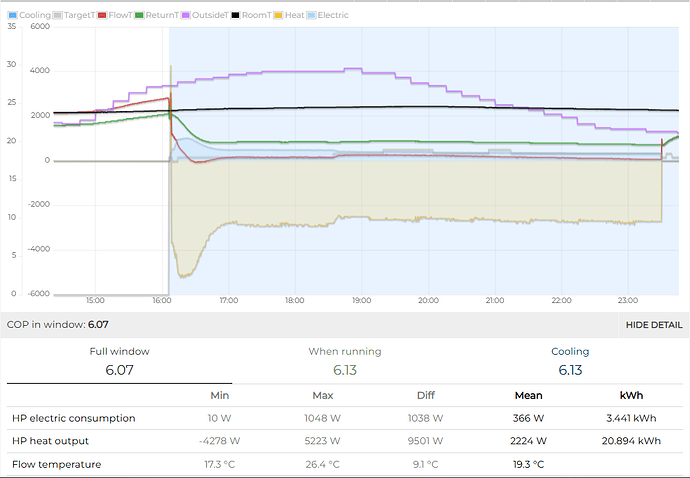

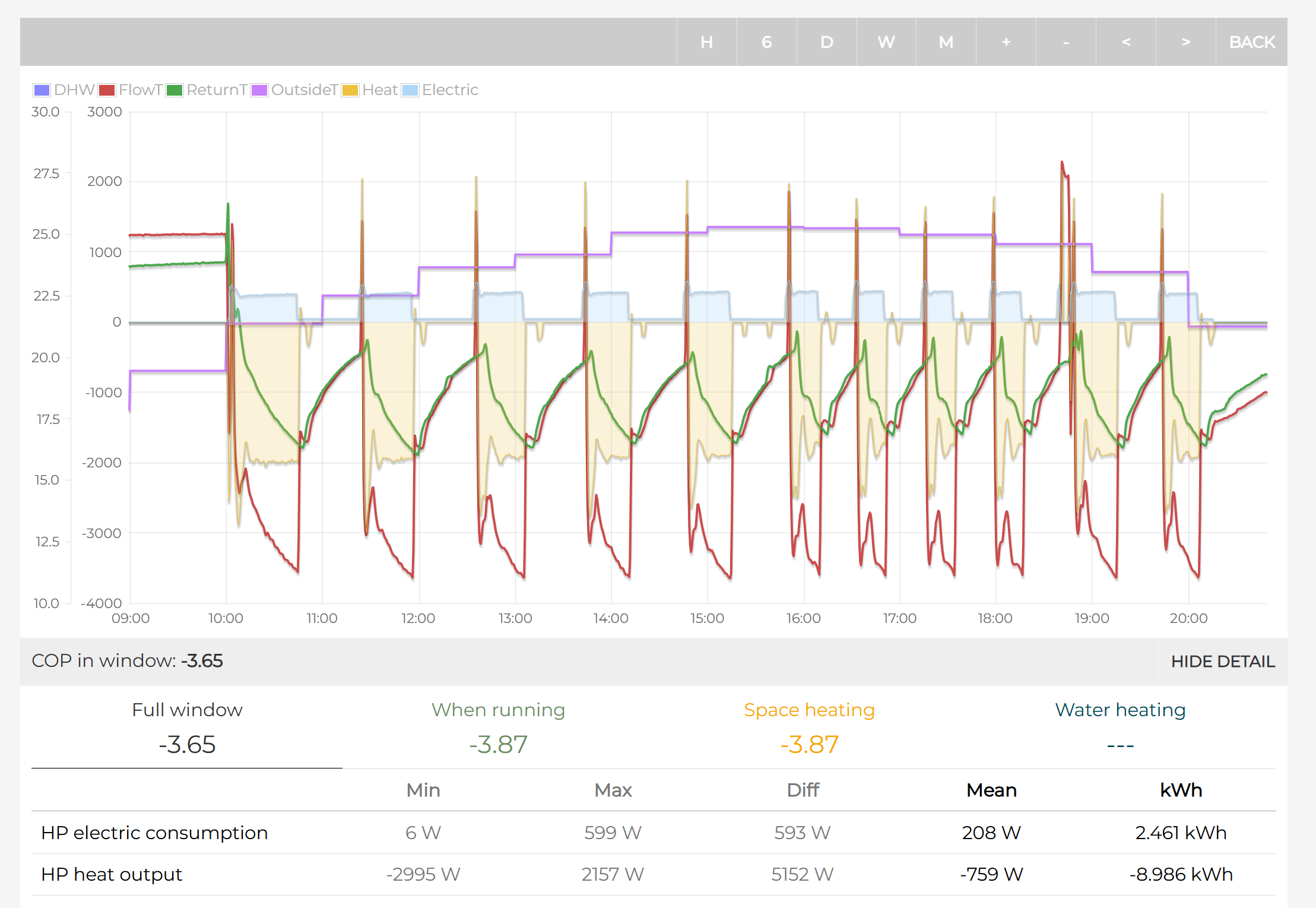

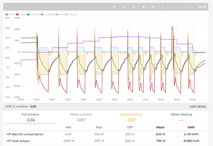

Hello all, ive got a Aerothrem plus 5kW. Had cooling set up for a while and pretty happy with it! The only issue im having is a lot of cycling… It normally runs at around 430-470W (input power), with a typical on cycle of around 30 mins, and around 30/40 mins off. See attached screenshot for yesterday.
Ive got UFH (or UFC?!) and MVHR with heating/cooling coil FYI.
Has anyone got any ideas of how i can reduce cycling?

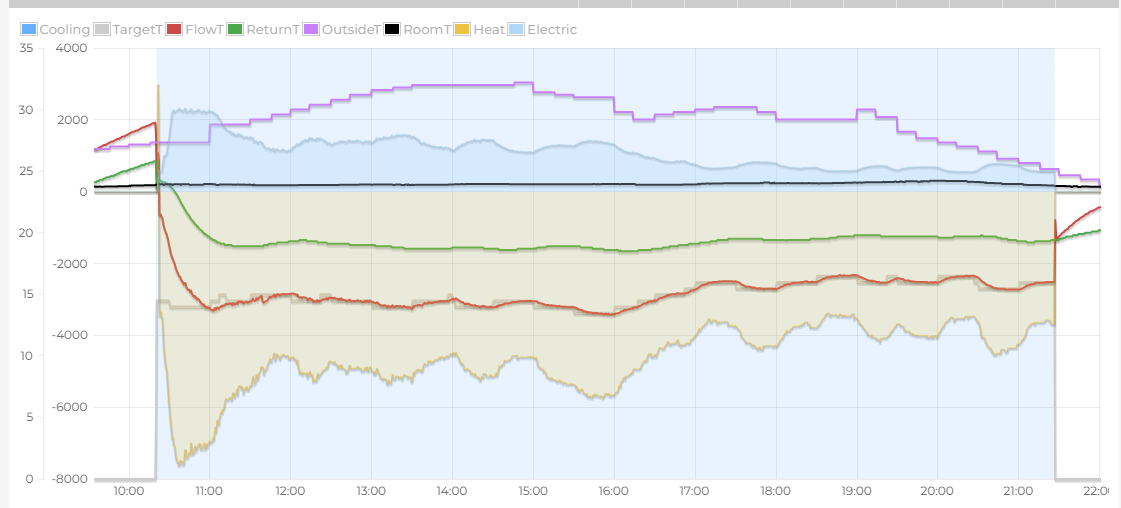

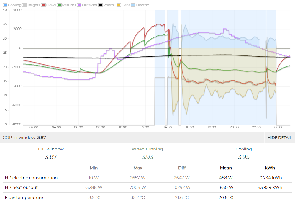

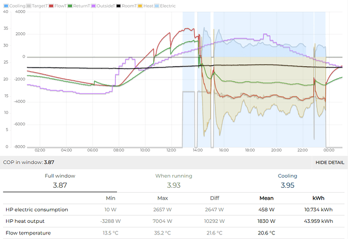

I can’t go to low because of the DEW.
Thanks to the fancoil, it’s possible. I’ve place it right on top of the system before the Rads & Floor, his T output is monitored to be kept at DEW +1 so the input can be much lower
Saturday
more than twice the output during a day !

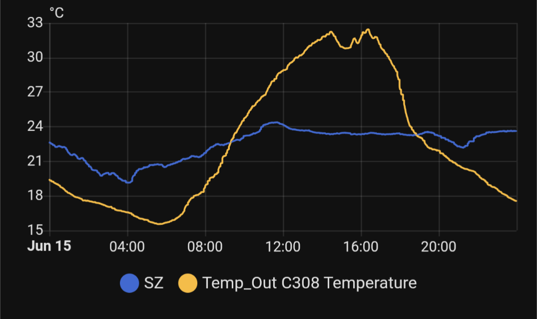

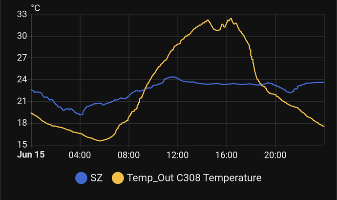

It works nicely - even against the natural convection. Definitely shaves a few degrees off for me. Here, I turned coolingnin around noon and the temperature in my bedroom stops rising and stabilizes at around 23.5°C for an outdoor temperature >30°C. One issue is the circulation direction in the radiator - the whole rad doesn’t get cold, only a part because it’s optimized for distibuting hot water inside itself. Condensation can become an issue where very old rads can become rusty.

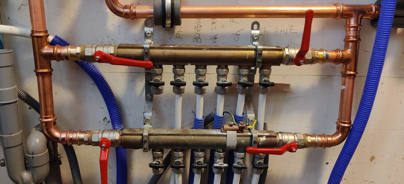

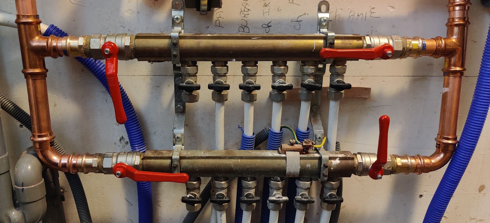

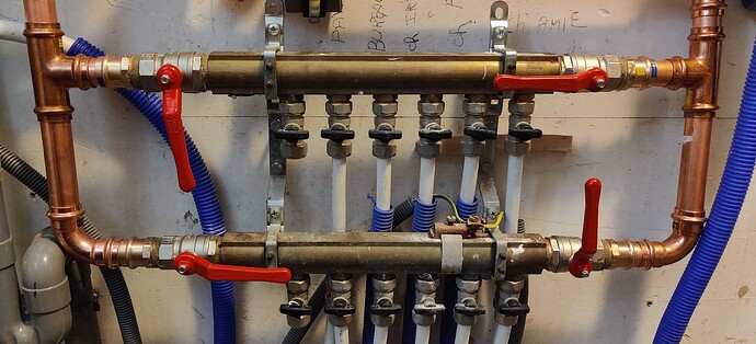

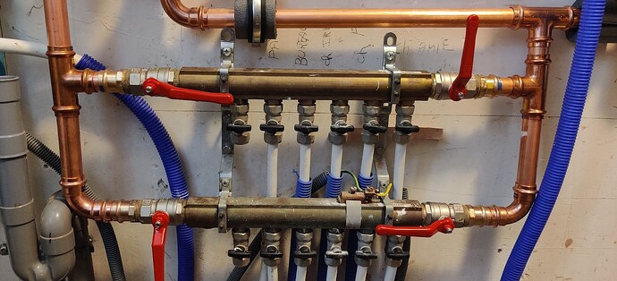

Here is how I flipped the flow to the rads, it’s manual twice a year
Winter mode
Summer mode

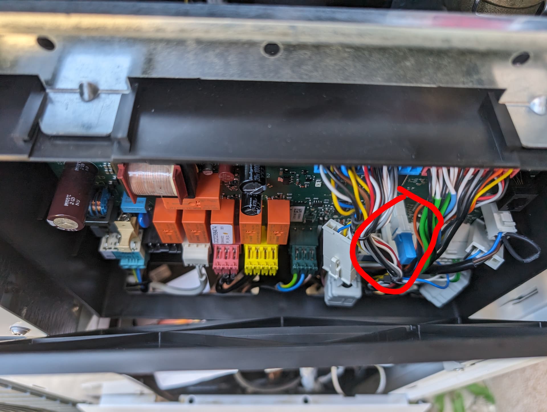

Hi all,
I’m looking at adding the 0020266328 part to my ASHP. I’m just wondering if there’s any visual differences between it and the official 0020269259 part.
I.e any etched part numbers on either of them ? Is the number on the sticker unique?
I have been discussing it with my installer and he’s afraid that the cheaper part would void the warranty for it not being the “official” part
However if there’s zero way to tell them apart I can’t see how that could be enforced because for all the manufacturer knows it does have the 0020269259 part installed :wink:
I look forward to everyone’s replies and hopefully saving some money!
I don’t think there are any markings on the resistor itself if I recall correctly. I only have a pic after the install and I think the marked part is the plug-in resistor.
Certainty no marking on the outside other than the sticker.
Stickers can fall off of course. Just saying.
Thanks both,
Very reassuring. The idea would be that the sticker may ‘accidentally’ fall fall
I am really curious to know if that sticker is the same on both the boiler £5 part and the £500 ashp part
From the images I can see online for the genuine part the sticker is blank
