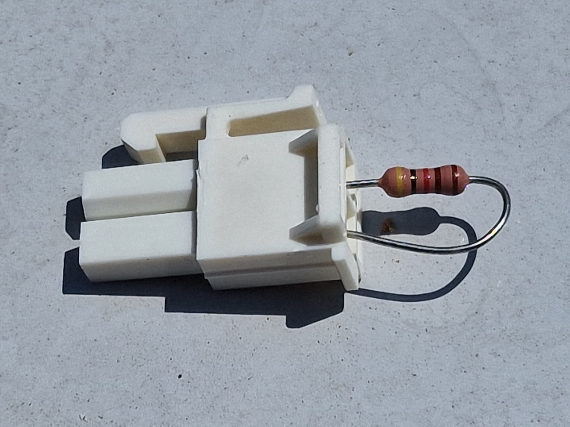

I’ve set a 4K 1€ resistance on a Molex 2 pins connector and it works perfect

I have the 0020266328 which cost around £5, and yes, it works

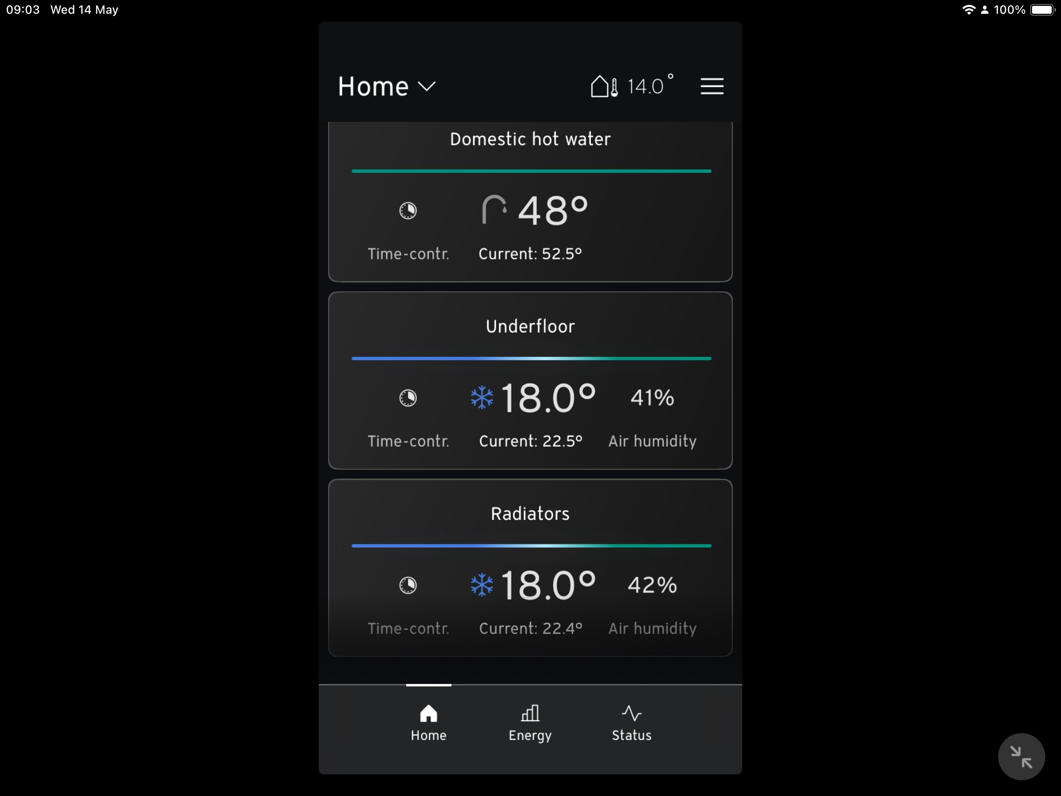

I have managed to get the cooler working, after looking through various posts!
Nice to see the app turned blue for cooling.
How well does the dew-point control work? Any issues with automatically keeping the flow temp above dew point?
Still playing currently, I have now set both zones to 16c. No condensation on any pipe work, had also notice the house temperature was still rising.
I have setup a schedule for cooling from 03:30-20:00, hopefully it will help get the temperature down by early morning.

Update: Dew point when I started playing I’m sure was 14c, is now 10.5-11c.

In case this helps anyone, I bought the cheaper of the parts (… 328) and can confirm it is just the 4k resistor.

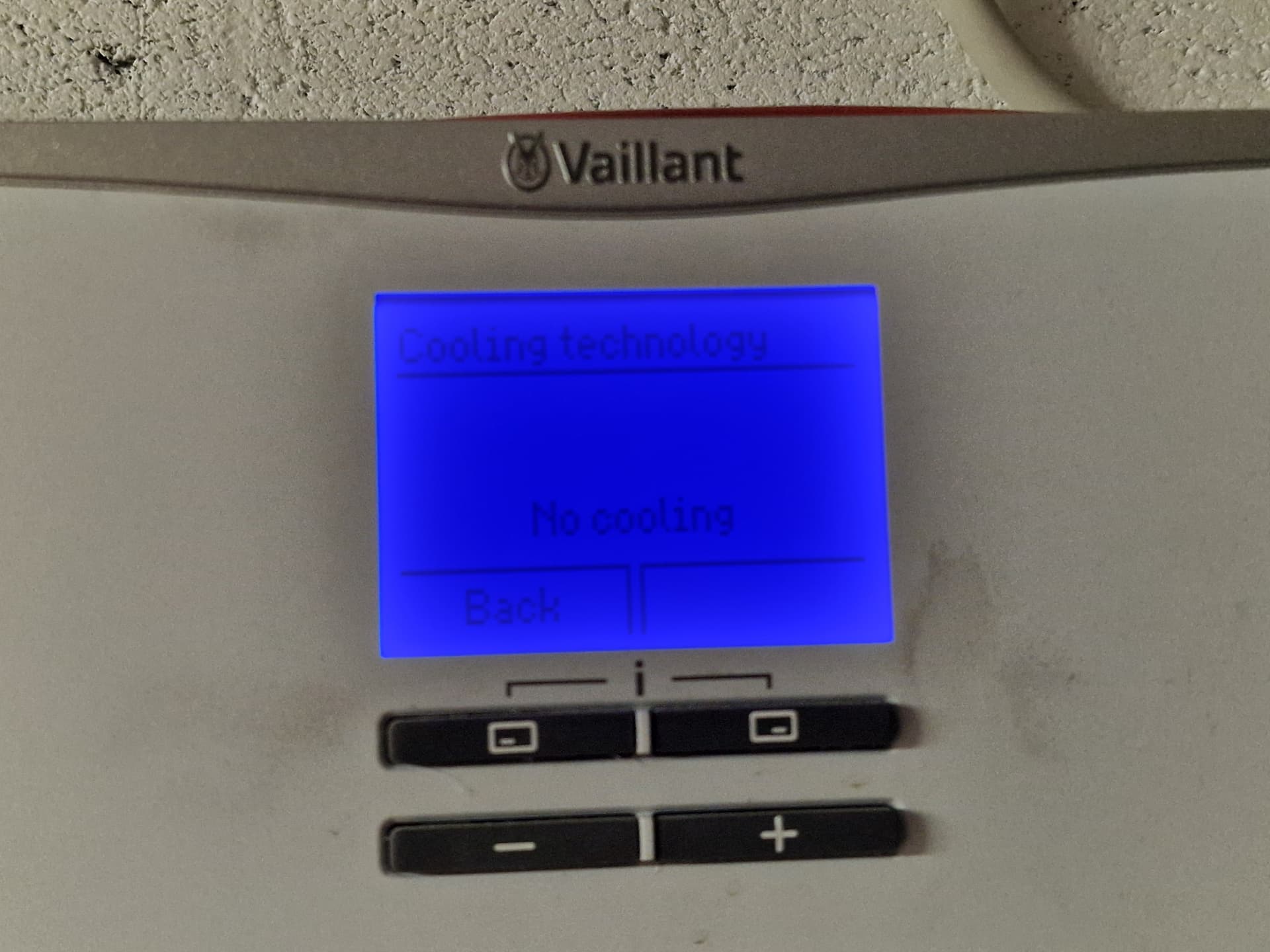

I also had the issue where it would go to cooling for a minute and then just show standby. I followed all the advice I could find but nothing helped. What finally worked for me was going on to the actual controlling unit (not the wireless sensocomfort unit) and changed the ‘cooling technology’ from ‘no cooling’ to ‘active cooling’. I can’t remember where exactly it was but I think it was under the installer configuration.
