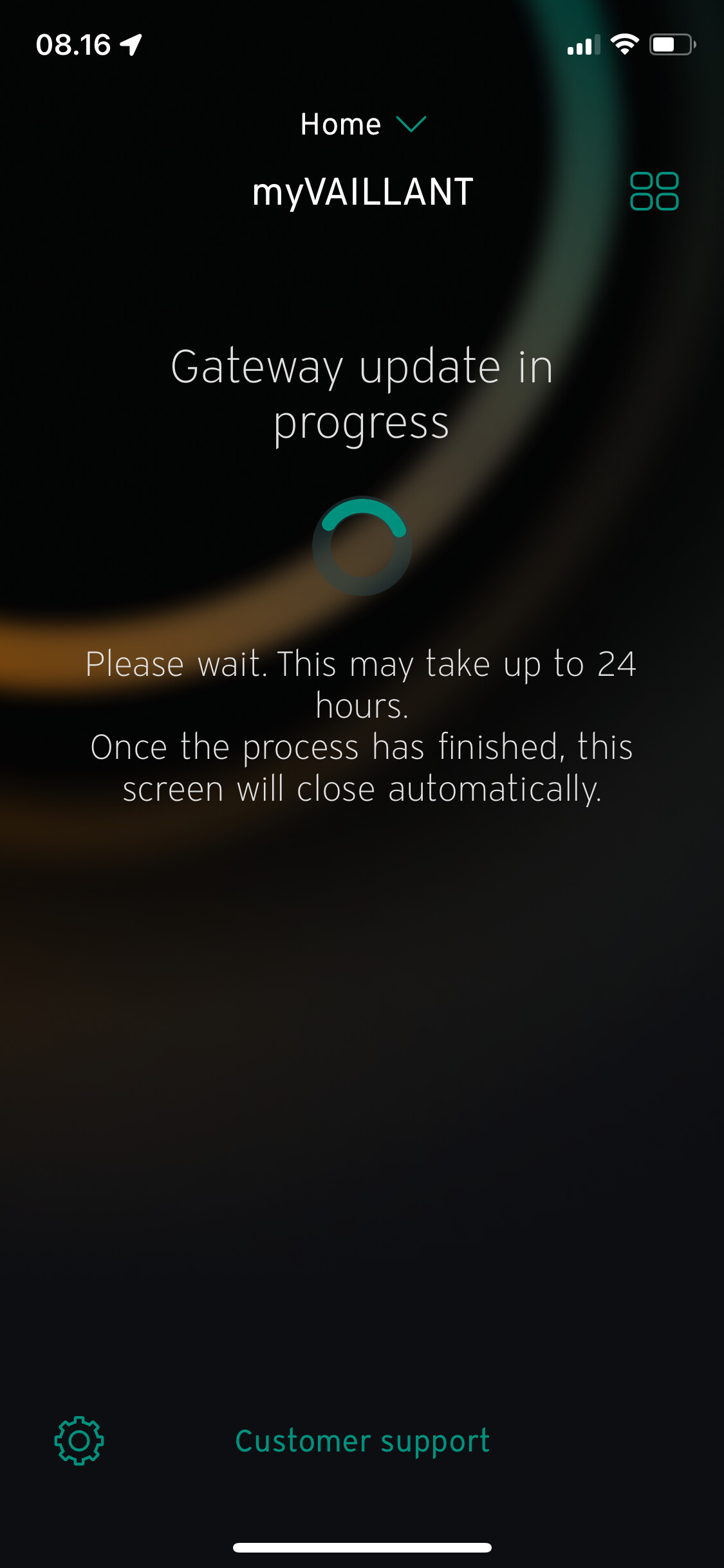

I am working on that! The App states that there’s a gateway update in progress that can take up to 24 hours… :stuck_out_tongue_winking_eye: What takes 24 hours to upgrade with a fibre connection these days??? (Potentially 14 hours left before the update is complete.)

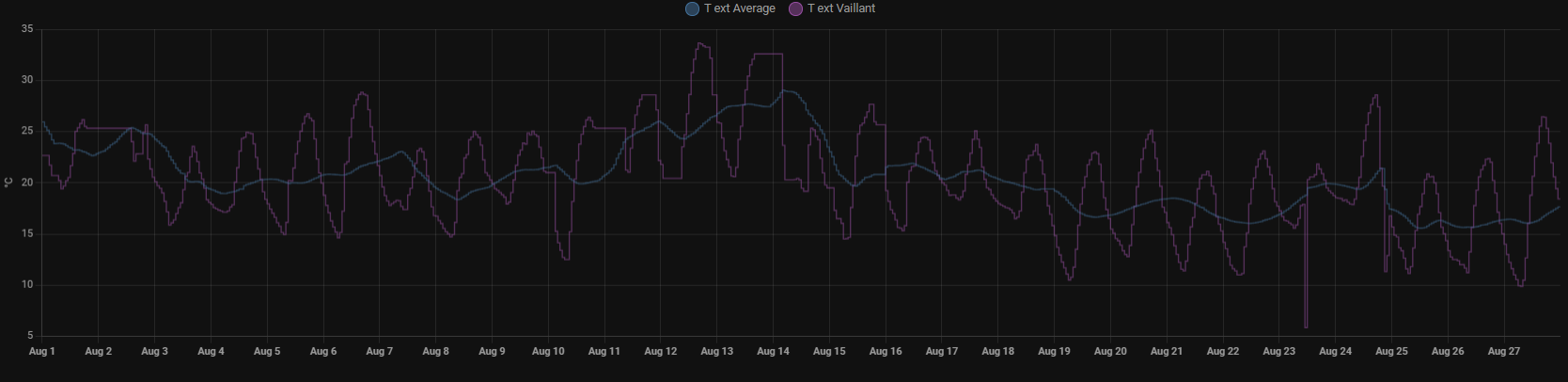

A small addition on this subject, in the VRC, the TE setting is linked to the average external temperature and not to the actual temperature. It reacts very slowly in time and can be the reason why a cooling does not activate in automatic mode
