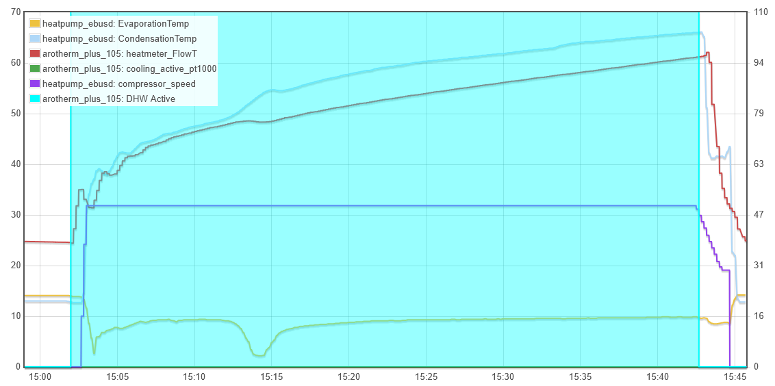

DHW Target temperature and current temperature for the tank (center) both come directly from ebus –> NodeRED –> emoncms, so this is exactly what the Sensocomfort sees. What other ebus evidence would you like? :smiley:
You can run the heat pump without a Sensocomfort and have it use its own internal logic. In the manual for my VWZ (indoor unit/controller) there is no mention of the offset, so that’s why I think this is a feature only used for other end devices.

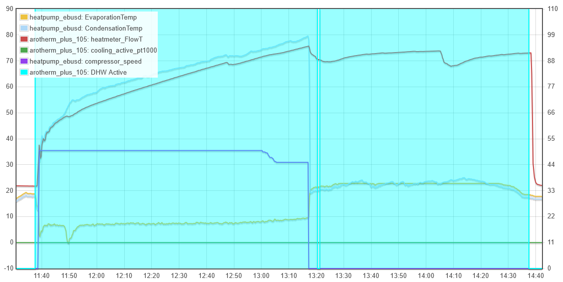

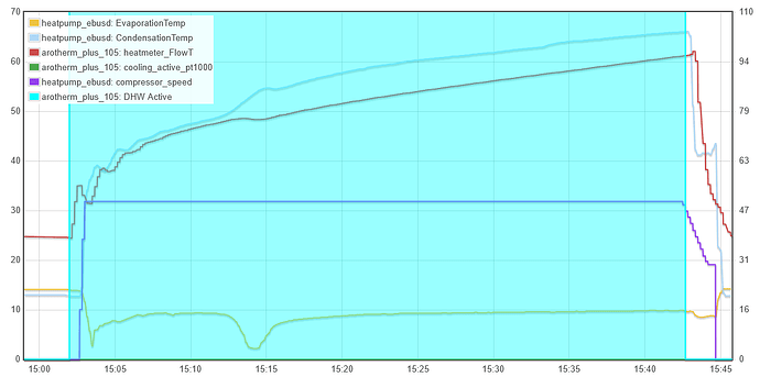

Yes, compressor speed is constant, 50 rps for Eco here:
There is no involvement of flow temperature in the control system here at all. It starts the compressor at the given speed and sets the flowrate as defined in the DHW settings. The resulting flow temperature increase is purely a “passive” effect of how much power the compressor outputs vs. how much the DHW cylinder with its heat exchanger can extract. If my heat pump provides 10 kW and my heat exchanger takes 7 kW of that and delivers it to the tank in the cylinder, then the remaining 3 kW increase the water temperature in the DHW coil loop over time.
The control mechanism is simply “Compressor at desired speed until DHW tank sensor reaches the target temperature (47°C for me)”. In that way it’s just like a very simple water boiler thermostat that switches off once the setpoint is reached. You could not build a “dumber” control mechanism :smiley:.

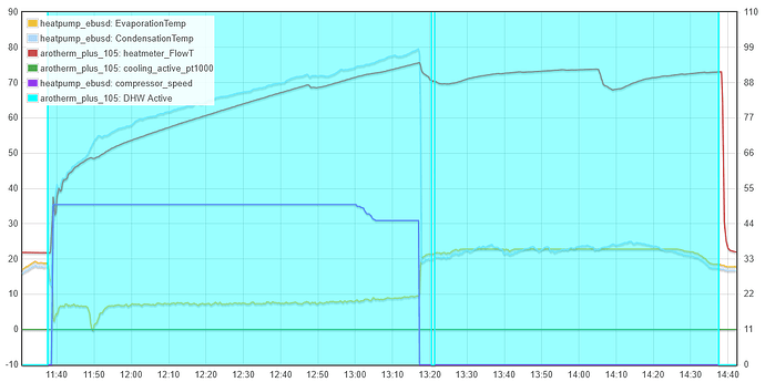

There is one safety feature here in that once flow temperature reaches around 70°C, compressor speed is ramped down and it is turned off once flow temperature reaches around 75°C. This is data from a legionella cycle where the backup heater takes over to provide the last few degrees. You can see the compressor ramp down from 50 to 30 rps towards the end.
Flow temp always goes above the desired DHW target temperature, so does return. As above, they don’t enter into the control scheme. DHW temperature itself also slightly overshoots as the compressor is turned off in the instant the temperature hits target and then the remaining energy in the DHW loop diffuses into the tank.
DT is constant for me throughout the cycle at around 4K. Return temperature also is not considered in the control mechanism and is simply a result of the constant compressor speed and energy exctaction by the heat exchanger.
