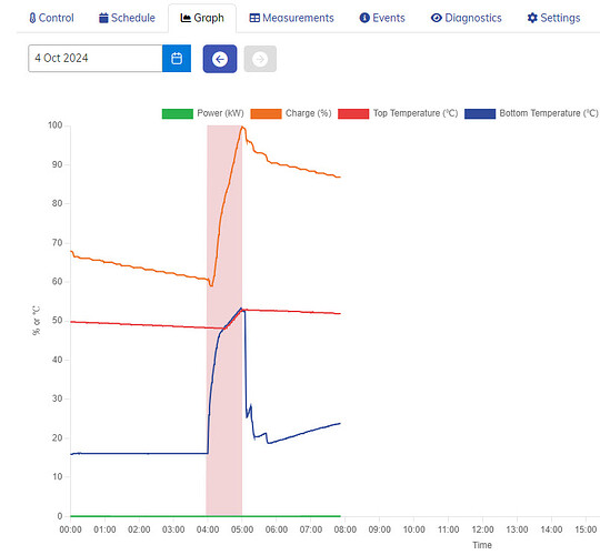

My Mixergy when left on the Agile tariff automatic setting does run partial charges that don’t affect the temperature at the top of the cylinder.
You can see how it heats the bottom of the tank first and only starts to pump that water to the top when the bottom temperature starts to match the top temperature.

The heating run in the screenshot should really have started 30 mins earlier for example.
Mine does exactly the same, this isn’t what Mixergy refer to when they talk about “partial charging” though. Partial charging means you can heat/use/heat use just 30% of the tank if you want to. This is not supported with ASHP. Your graph doesn’t show partial charging as charge ends at 100%, does it sometimes heat and not end at 100%?
It does. Not that often. It did happen today though.
The first block was the Mixergy with nothing else scheduled for the next 90 minutes.
I boosted manually which is the second block.
I see what you mean about the partial heating. You just end up with hot at the top and bottom with a cold section in the middle.
I wonder if thats deliberate though, or actually Mixergy thinks you have are using top coil and not ASHP?
