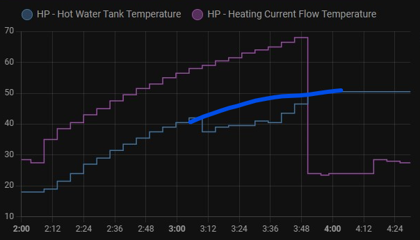

I normally see behaviour like you describe with a small and consistent overshoot. In this case above, the pump switches off as soon as the temperature sensor reaches 46, but there is the strange dip. Extrapolating the first part of the curve to extend over the dip (I roughly drew this in the plot above), it looks like the temperature was probably increasing, but just not being measured. There was no hot water usage, as it was in the middle of the night. Also, the Vaillant Connect monitoring is slow (the 5 minute intervals you point out), but since the behaviour of the controller ties in with the temperature of the plot, I don’t think the monitoring is the fault.
My first thought is a faultly sensor, but this would seem to be a very unusual fault, as it seems OK the rest of the time. My second thought is weird fluid dynamics, but I don’t really know whether this is a possibility.

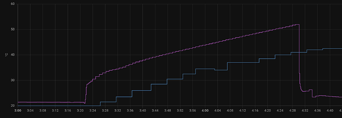

Mine for example cuts off with the flow temp just below the target tank temp (45C) at 44.6C. That’s in ECO mode, Auto pump (trying it out as it was set to 100 before). I thought I read that it cut out just below the tank target temp on purpose to let the last bit of heat soak in from the coil. Seems to have gotten a better COP using Auto pump speed than the 100% it was set to before. It’s the highest COP I’ve had for water heating (only been in 2-3 weeks) but I think the tank was also ‘one shower’ colder (there was basically no hot water in it), so that’s likely done it for me.
Having the pump at 100% vs Auto only seems to make 1C difference between the delta of flow and return too. ~2-3C on 100% and 4C on Auto. That’s 20lpm on 100% and 14lpm on Auto.
On the HA image, the two cylinder temps are one in the cylinder pocket of the Vaillant cylinder and one on the little holder by the immersion stat under the foam bit.
EDIT: OK analysis fail! I’ve just realised that it hit the 2hr limit for DWH and never actually got all the way to 45C is should have done
The tank was colder than I’ve had it before and just assumed it had reached target temperature, I should have realised from the HA graphs that the cylinder temp was too low.

Analysis fail - seems it hit the 2hr time limit for DWH and stopped heating it. Because it was on a boost, it didn’t resume heating again making me think it had finished
Only realised this morning when HA reported the tank temp was only 38C before I had a shower.
