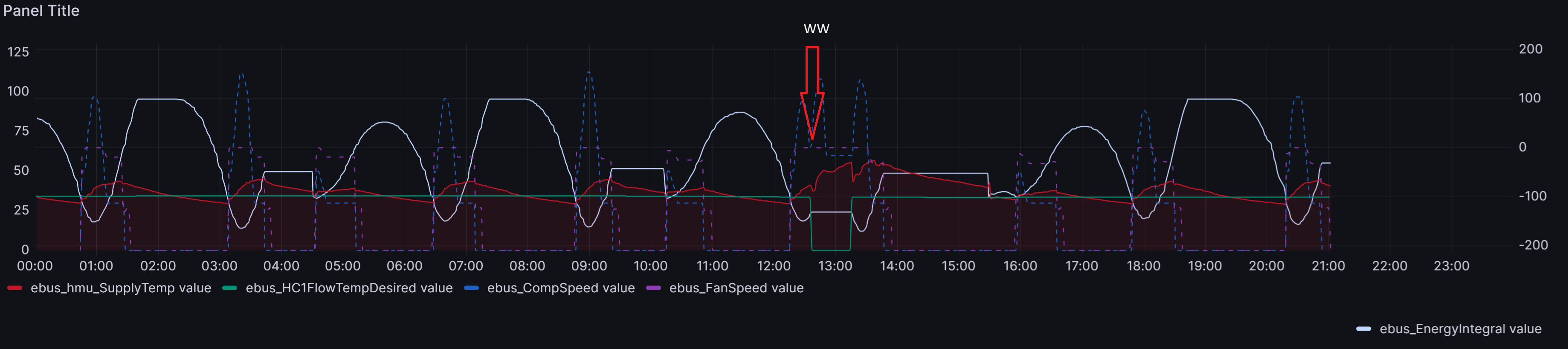

Hi, as I mentioned in other Thread I’m new here and have a Question about the Energy Integral. I thought that it is always a curve (like a Sinus Curve) but when I look at Grafana I see that it has those I will call it " Half Curve" between the Cycles.
Can somebody explain why the Curve form the Energy Integral looks like that?
Red Arrow = Hot Water
Attached Picture:
Integral is set to -100
Red= Supply Temp
Green= FlowTemp Desired
Blue= CompSpeed
Violet= FanSpeed
White= Energy Integral
aroTHERM VWL 75/6
uniTOWER VIH QW 190/6 E
Buffer Storage VPS R 100/1 M
The EnergyIntegral is clipped once it reaches +100°min - it cannot go any higher. This is why you see the flat region at 100 that only starts to drop once flow temperature drops below the target.
OK. Thats clear, but what is with this flat regions where the Integral only reaches about -19°min at e.g. 4:00 or 10:00?
Why doesn’t it climb highter to +100°min? This what I expected.
Was the heating off during that time for any reason? Maybe you’re not using pure weather compensation but your Vaillant controller is in a mode (active or expanded, forgot which does this) that can turn the heating off when target is reached? Plot your flow rate as well and see whether it drops to zero in those times.
