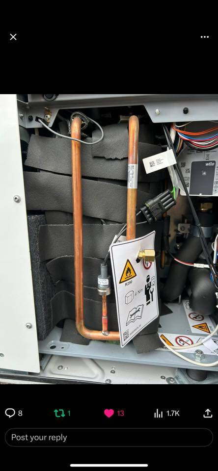

    • With all the panels off, there were no loose components, and applying pressure to internal pipes and components to check for vibration, or if it dampended by applying any pressure showed no change in the noise levels.
    • The engineer did apply a known Vaillant dampening “fix” onto one of the panels, which was simply a sheet of stick backed plastic. We agreed that it was unlikely to reduced the noise/vibration and indeed it did not.

this is what one Vaillant engineers fix was apparently:
not going to help with compressor life if thats whats buried in armacell tape.
