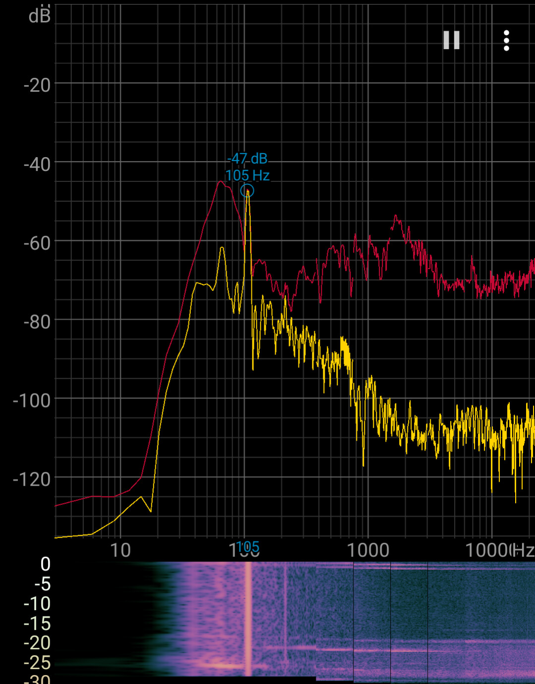

Dean, here is the link to the video, I don’t have a way to upload the file.
Vaillant 5kW Sound Test
https://1drv.ms/f/s!AhD5yW27785ul_pUjGNB7R7e6vAT3g?e=wiu7zR
I had to wait a while to record, neighbours oil heating was drowning the sound out :wink:
It’s much quieter! I will share this with Vaillant as there is a clear difference.

Ah interesting, when I listen to it on OneDrive directly, it’s quieter. I’ve downloaded it to my phone to compare directly with my video, they sound the same. There is a distinct buzz. Maybe this is normal with the aroTHERM then?
This is just the aural character of rotary compressors; they all buzz to a degree.
Scroll compressors, as per the 10/12kW versions, have a less harsh profile.

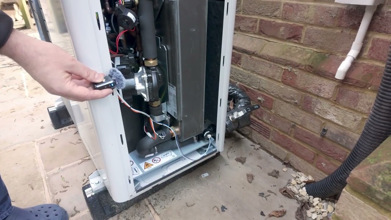

I went to a noisy 7kW unit today. Measured noise levels weren’t that bad - 60 dB with the case on, but it sounded rattly, and the noise transferred through the pipework.
I opened the unit to see what was causing the noise - and it was the pump. Running at 68% speed, the pump was causing all the noise. I didn’t test 100% speed, but the customer tells me it makes a mighty racket, way louder than what you see on the video below.
When pumps was slowed down, the unit is virtually silent - even with the compressor full out. I feel most noise probelms on 7kW units is the pumps.
Have a look at the attached videos;
That’s weird, as the 5kW and 7kW units use the same pump.
7kw is 1200l/h and 5kW is 860l/h so obviously running faster on 7kW. It’s a Wilo pump and they can be noisy.

Yes, you do need 1200l/h to get the output. You can’t dial it down without affecting the performance and efficiency of the unit. 7kW units are just underpowered and noisy. We stopped specifying them now.
My 5 kW 's pump runs at 70% , around 1200L/h and it’s quiet
I think there are many 5kW arotherm+ pumps out there that work harder than 68% to get their 840 liters. In general the 7kW pumps will indeed work harder, but I would think if there really is a noise issue with these pumps, the 5kW should be affected too. Probably less frequent, but stil…
It’s definitely compressor vibration causing the issue in my 7kW unit. I monitored the % pump speed and it’s a constant 67% during DHW and 79% during heating. As the compressor speeds up/slows down, the vibrations occur at different rpm’s whilst the pump speed remains constant.
