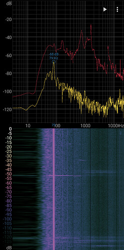

Here’s a Spectroid scan from our master bedroom during a heating run. At that time it was consuming 1700W of power and producing 5800W of heat with an outside temperature of -0.6C.

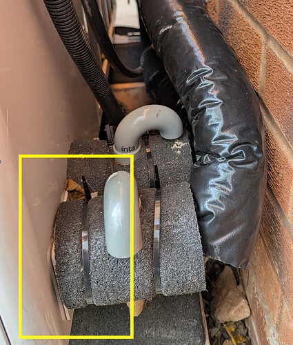

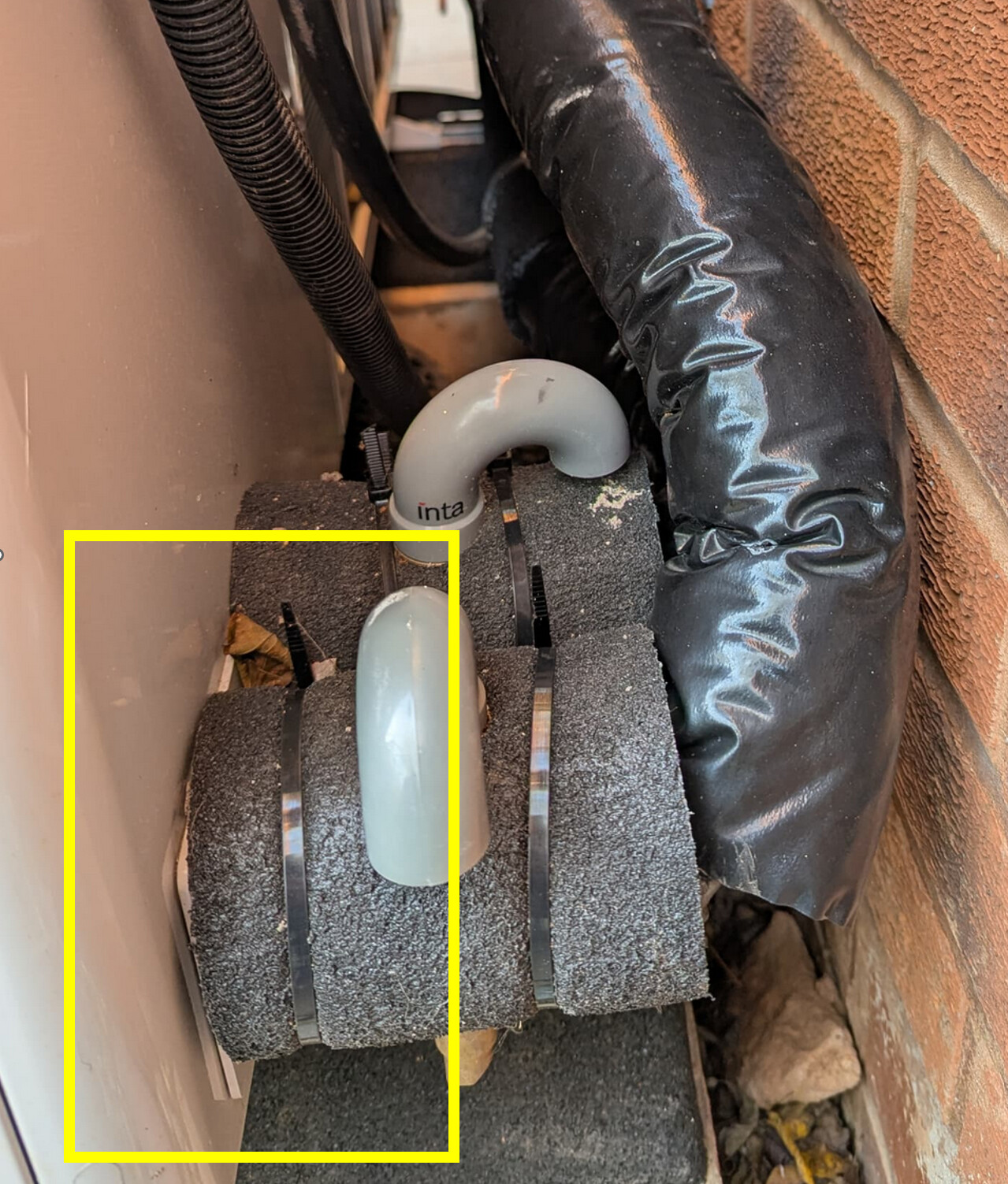

Can you share some info, and possibly photos, of your primary pipework runs from the outdoor unit to your cylinder/indoor location?

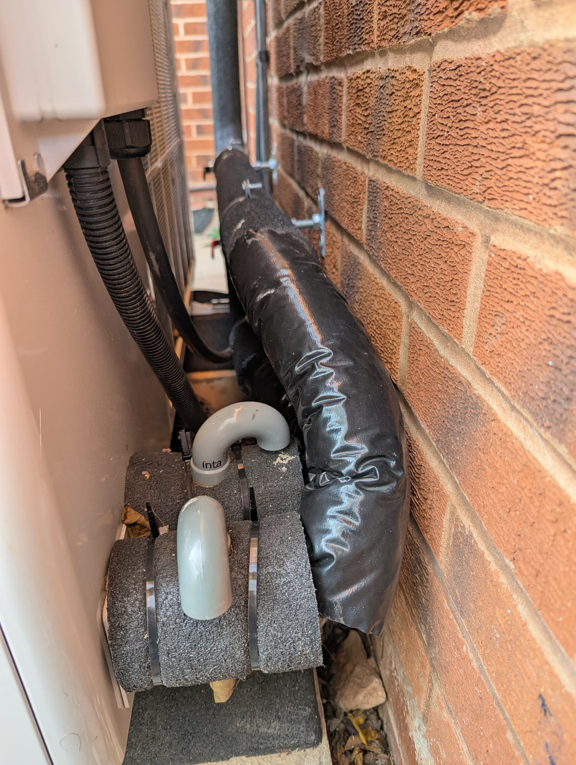

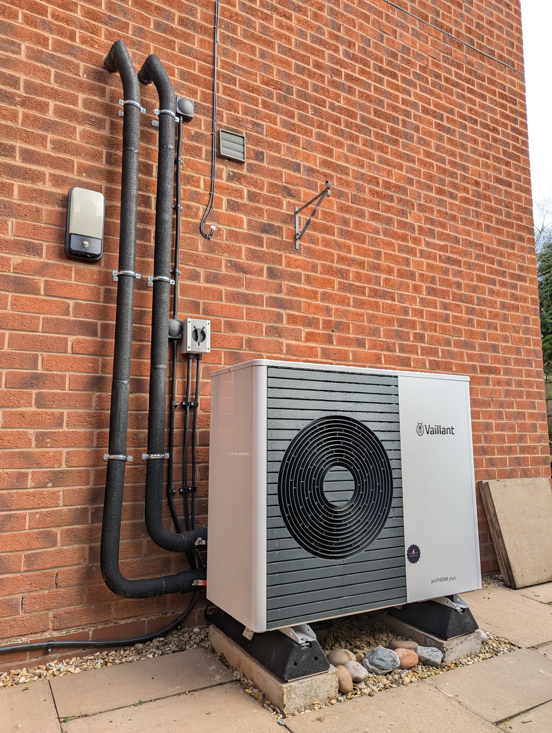

The heat pump is by our back door. The primary pipework runs up the wall, enters under the floor of the landing, runs down the landing into our airing cupboard in the centre of the house. The external pipework is insulated with Primary Pro and clamped using their rubber lined brackets. It all looks fine. If you ask me, the vibration is coming from the radiators but low frequency sounds are hard for people to locate. Here are some photos…
What do you think? I can feel vibration in the external primary pipework and at the back of the unit.

If you put a finger on the plate highlighted, can you feel it vibrating, and does it chnage when you are pressing it?

that insulation is proper awful on what im guessing is the flexi sections, though they didnt leave themselves enough room to be honest. could do with the gaps where the elbows are covering.

Nothing changes when I press on that little panel.

Explore if coming from the pump or from the compressor: If the tone changes or goes away with different flow rates or with different levels of compressor modulation. When the sound deadening panels are off, the sound will be a lot noisier and may be able to further identify where is coming from.

The unit looks very close to the wall, I checked the specs and its 200-250mm. Mine is 300mm away and the flex hoses are not so sharply bent, which may not be helping with the pressure of the bend on the unit and vibration coming through.

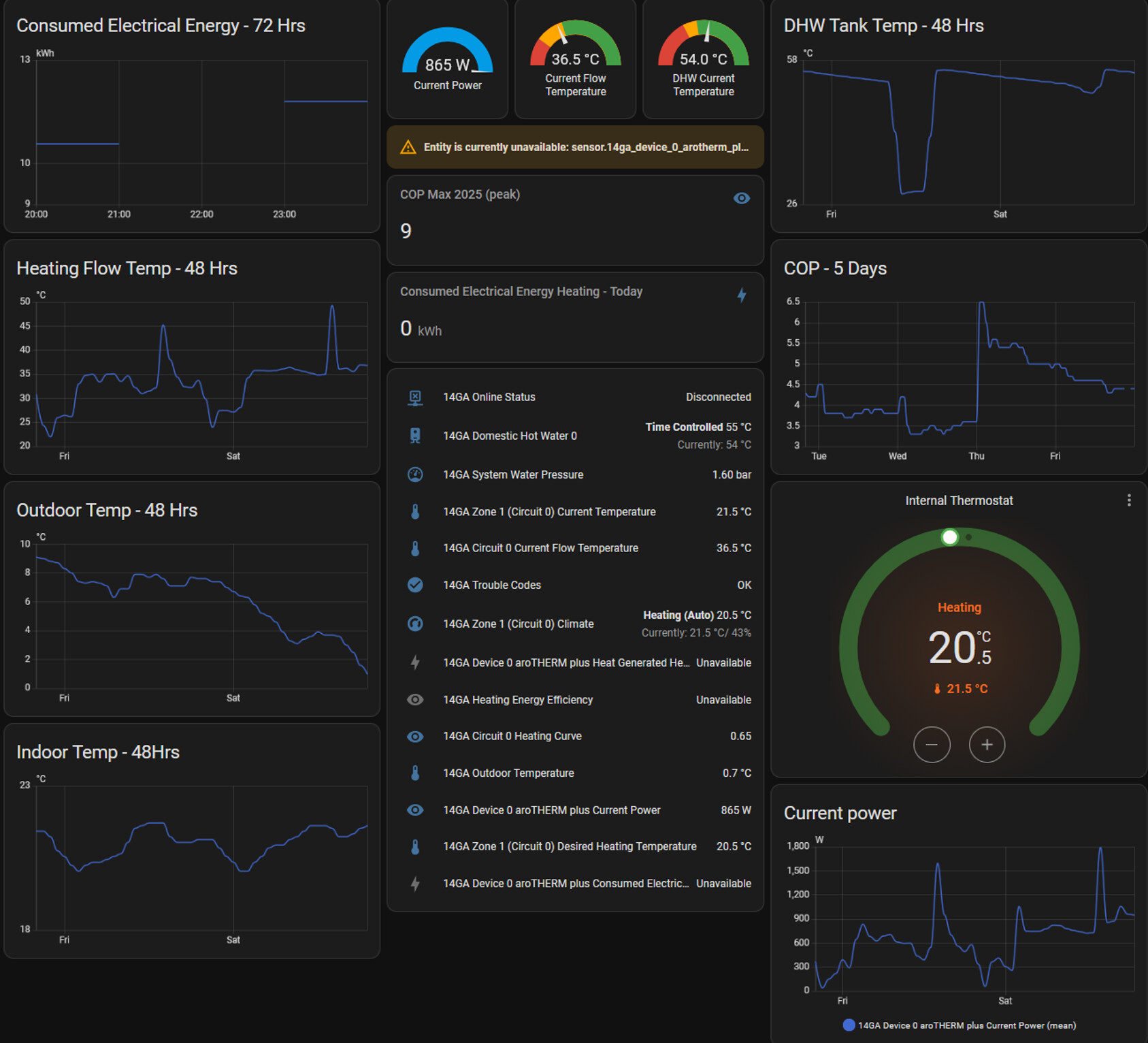

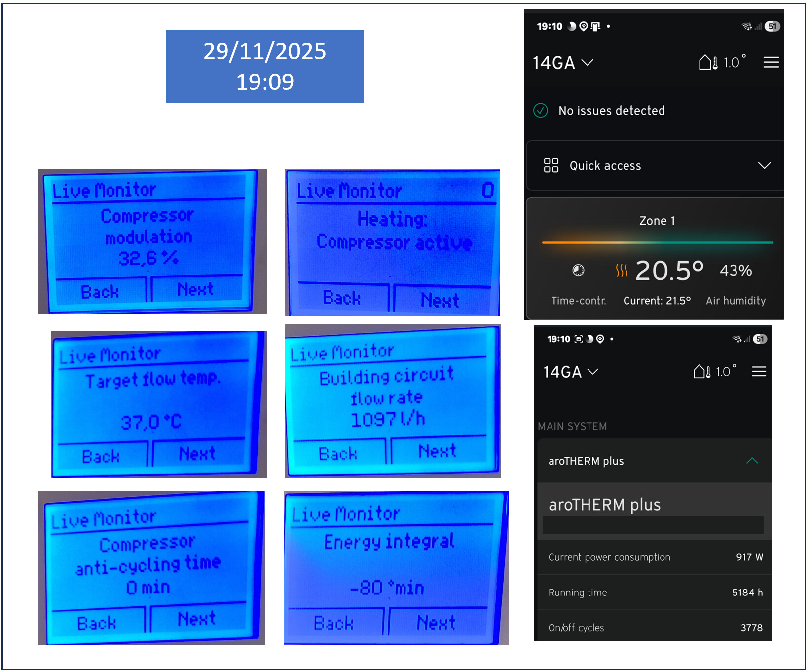

During some of my resonance periods, I’m capturing screens and data, as i dont have the hardware for some of the hardware for some of the values.
Is the compressor speed available in any of the controls?

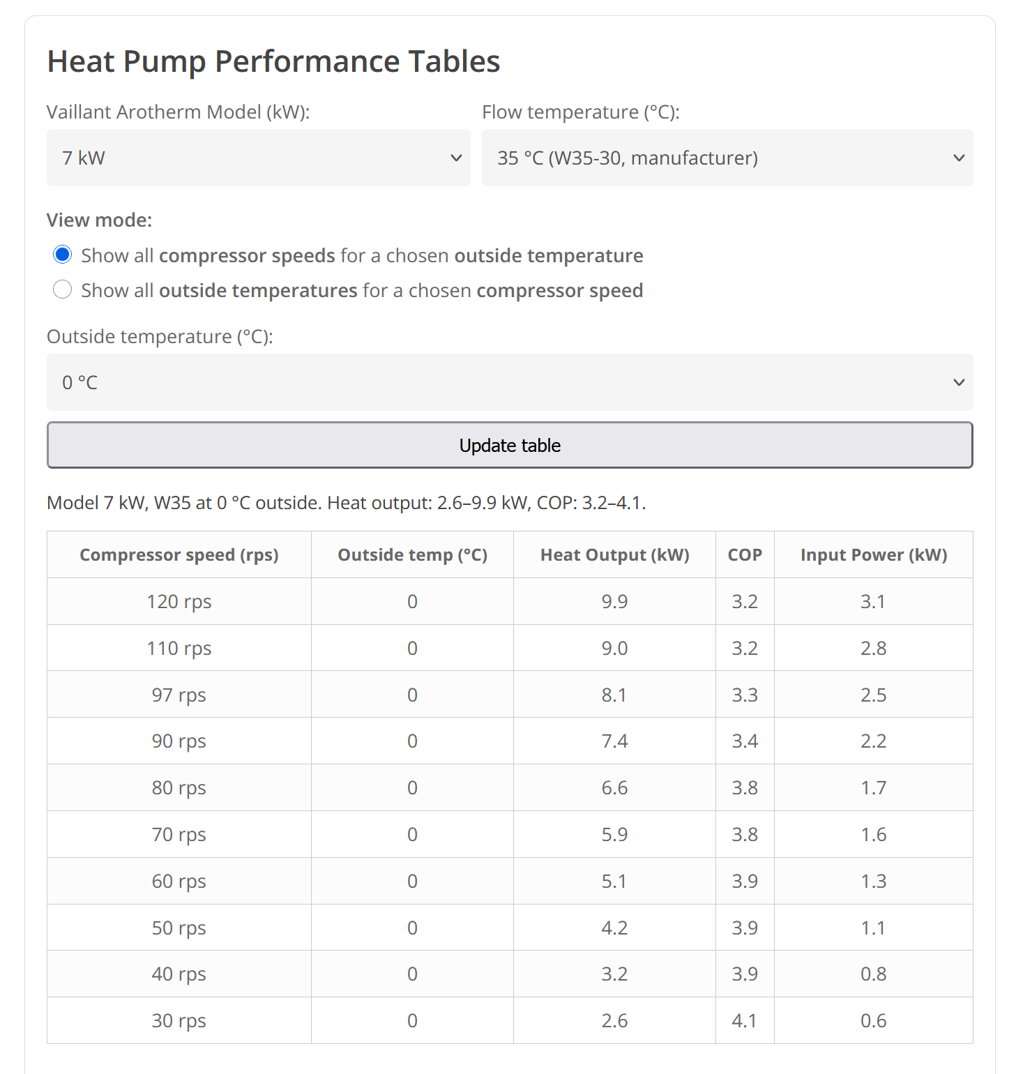

Looking at Mick’s ever excellent pages and the widget for performnce, starts to gives a table to work with at outside temps, current power & Flow temp, to cross ref into compressor speeds to allow some record of the start of the noise.
Also capturing video/audio from the same location for consistency.
Will also add spectroid captures.
I get frequency changes in the noise levels as the compressor when outside temps change and the pump increases to meet the flow temp delta.
This was all captured last night at 19:09
Metadata/config below -
  • 7kW Arotherm+
  • 3 bed bungalow, well insulated. All rads & pipes replaced for flow rate & temp design.
  • Central Scotland.
  • Single open zone utilising UFH Manifold, but no actual UFH.
  • Room Temp Mod - Active
  • Sensocomfort in Hallway (not a cold zone due to doors)
  • Desired- 02:30 to 20:30 - 20.5°
  • Setback – 18.5°
  • Heat Curve - 0.65
  • Min flow temp - 15°
  • OT switchoff - 16°
  • DHW Scheduled cycle - 14:00 to 15:30 to 51°.
  • Legionella 1 per wk @ 15:30
  • HA for monitoring and automation
OT set to 0°
Flow temp 35°
https:
//energy-stats.uk/vaillant-arotherm-performance-data/
