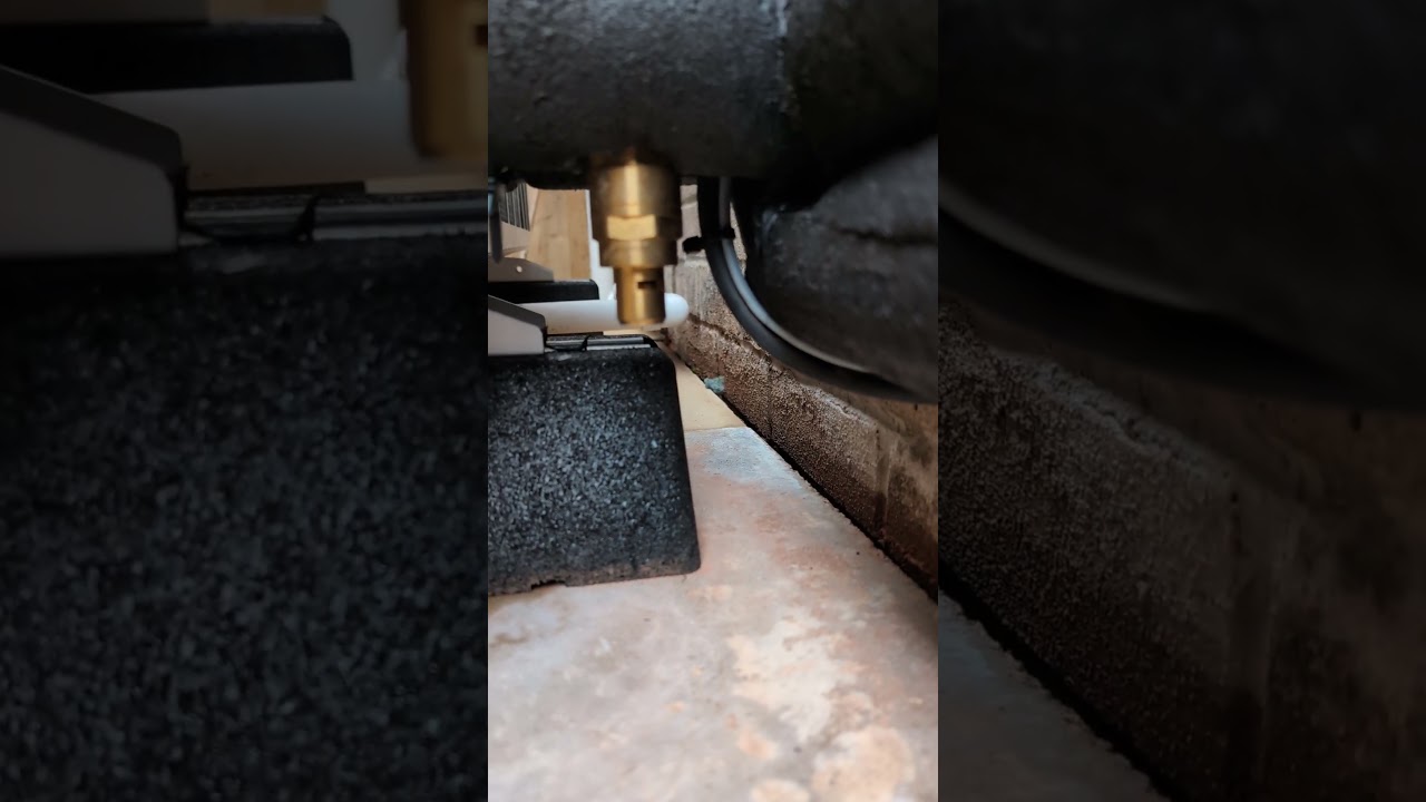

Here is the original video and a new video to compare.
Before (111rps)
After (108rps)

Thanks for posting the videos. Doesn’t sound like it’s made a transformative difference, is that fair to say? I was helping a friend with their Midea heat pump recently in temperatures around freezing and the lack of buzz was very clear cut compared to the Arotherm.
My impression is that the problem is a lack of vibration isolation between the compressor and the case (and other components). While the compressor isn’t exactly quiet at high speeds, it only becomes a nuisance when you get resonant rattles in the casing and vibrations transmitted into the building via pipework. A like-for-like compressor swap seems unlikely to resolve these issues.

-67dB at 97Hz recorded by the wall it’s against.
