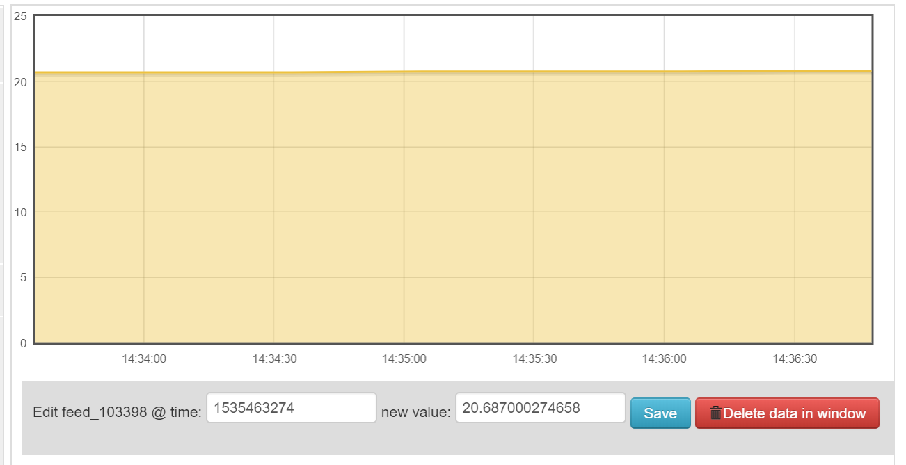

A bit more info I found playing with it whilst waiting for the kettle boil.
3 points from the same zoomed in section, they are all out by 4 secs, they should be 1535463240, 1535463270, 1535463300.
At a different level of zoom these three are all consistently 16secs out (should be 1535466930, 1535466960, 1535466990)
if I zoom in slightly on those same last three points again (or what i think is the same points)
These appear to be just 3 secs out, but could it actually be 33 or 27 seconds out? The values are too similar to tell, I will have to do more tests with some varying data.
Needless to say, there is some serious cross talk between the zoom level or size of data and the timestamps that should not be affected by zoom or anything else for that matter.

I tried multiple times to edit this datapoint but the screen never changed, no error, no refresh (as it does when successful) it silently failed.
eventually by zooming in and out I eventually got the edit to stick, the difference was that the apparent timestamp was now greater than the true timestamp (as per all the examples above), with the prior failed attempts at this correction I had noticed the apparent timestamp was actually 3s earlier than the actually timestamp.
the above screenshot is immediately after the edit succeeded as I did not take screenshots of each failed attempt.
I have briefly looked at the code and see no obvious errors, but I vaguely suspect that what is happening is that the vis is requesting feed data by the usual means, start time, end time and interval and the data returned is presented with the requested datapoint timestamps rather than the found datapoint timestamps.
