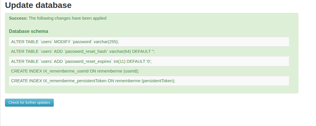

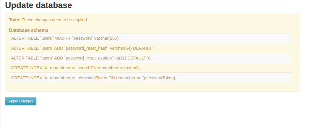

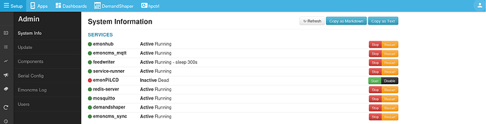

Hello @diyhouse
This looks related to recent security improvements in emoncms, a more secure way of storing passwords. It looks like the database update might not have run. Can you try a database update via Admin > Update > Database Update, does it report any database modifications?

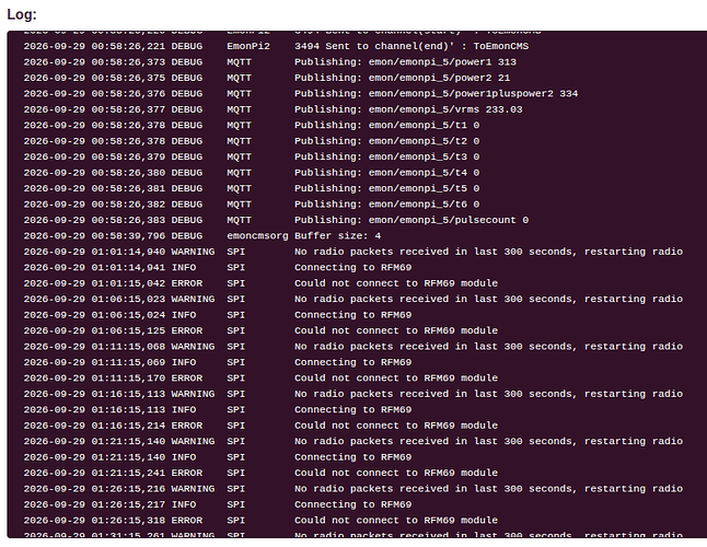

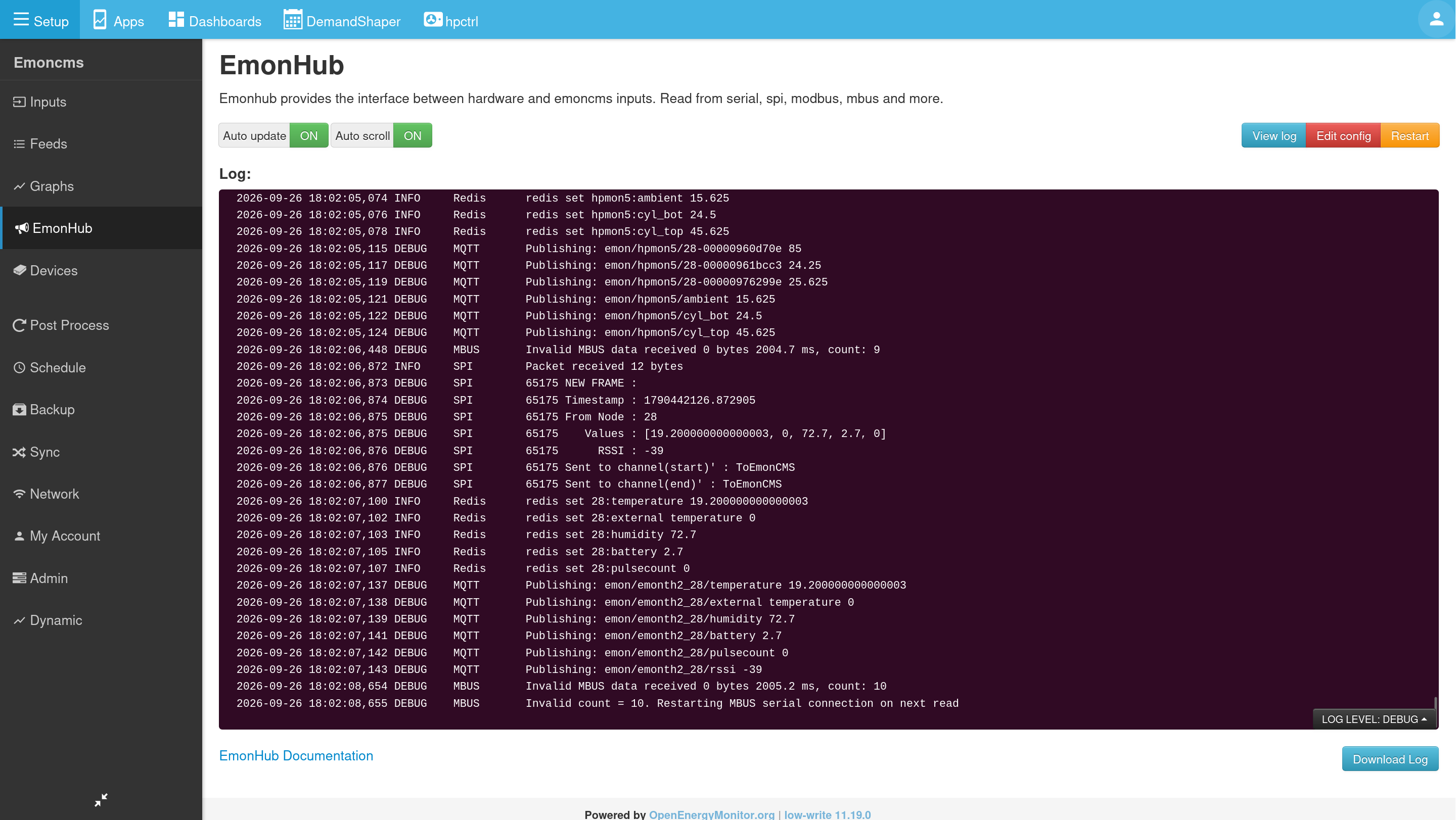

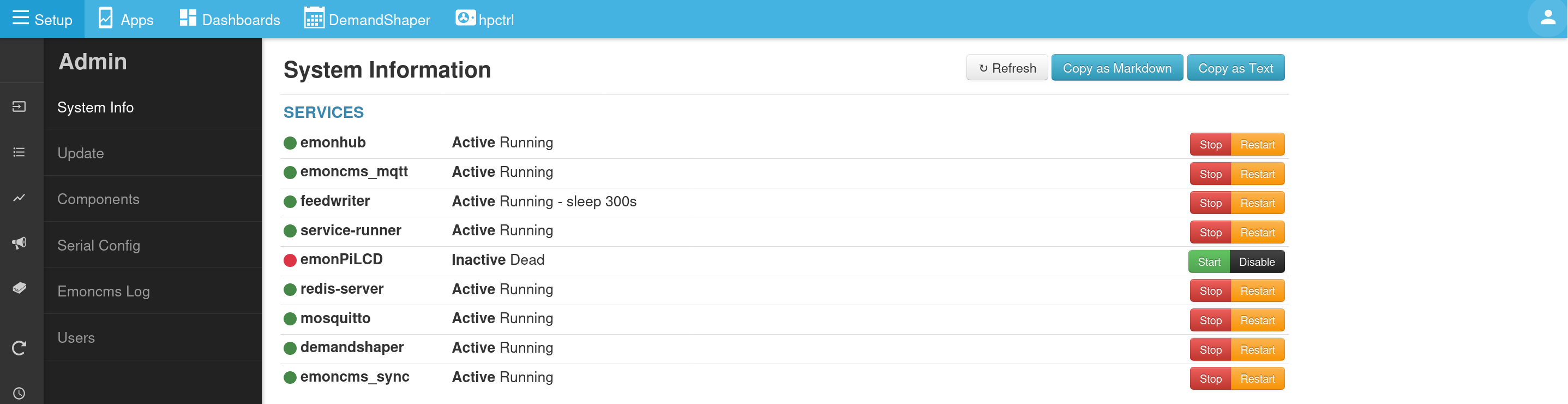

When this issue pops up the first place to look is the emonhub log, if the data is coming in there and publishing to MQTT then we know the data is getting that far and the next place to look will be the emoncms_mqtt service, is it running/exited - that can be found towards the top of the Admin > Info page.
Example here shows emoncms_mqtt and emonhub both running, if they report anything other than that it’s a clue at least that we can work with:

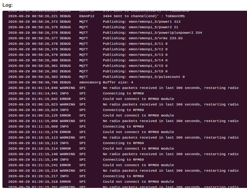

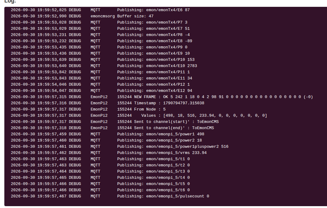

Hi Trystan,.. Just got back,.. to investigate my issues,.. and looking at the EmonHub logs,.. I get this when things seem to go pear shaped…
This then continues,.. to current time,… pls note I recieve my Tx4 data via USB,.. which shows a similiar story,..

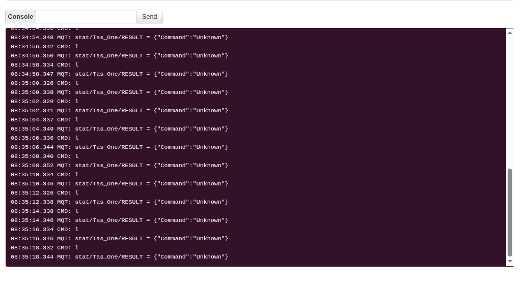

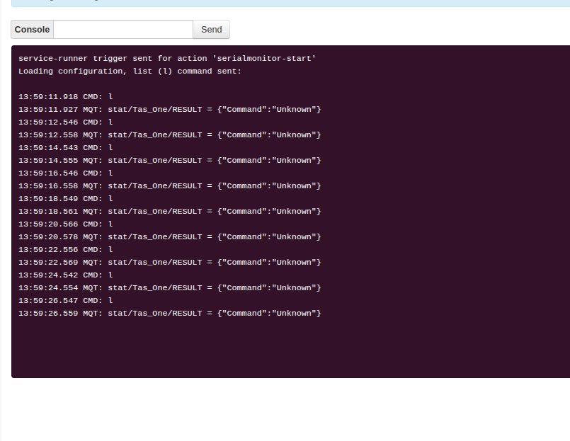

I do use ‘Radio’ to receive temperature and Hum. data from two remote sensors.. although EVSE data is being received via WiFi…

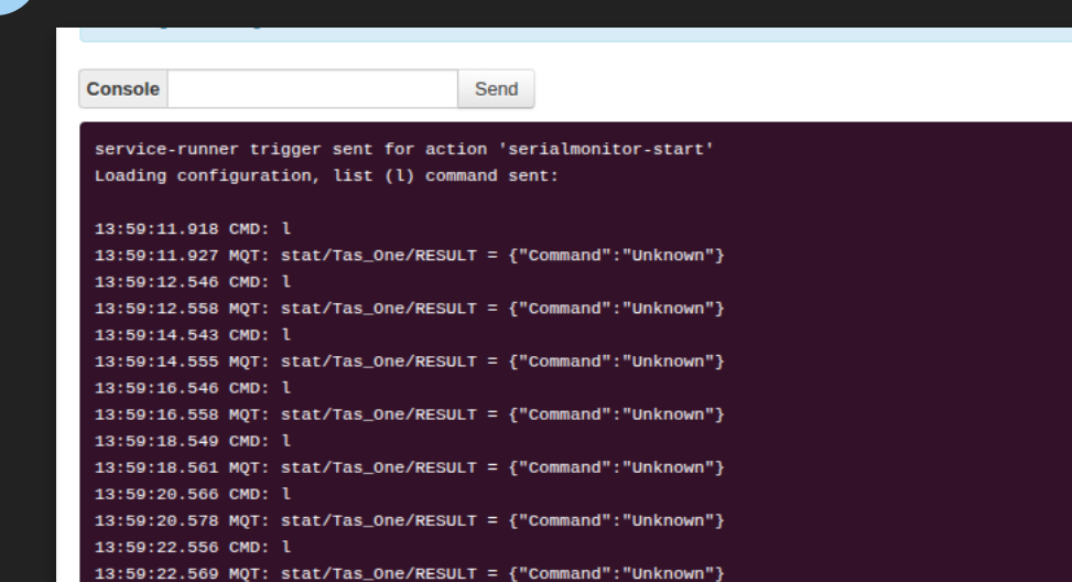

Not sure why I am seeing ‘stat/Tas_One’… as MQTT data,.. This is a Tasmota device tied into HA,.. why it appears as serial data at my EmonPi I do not know…
I do plug it into my EmonPi2 for power,… but this does seem to be sending rogue data,.. what ever,.. I have now disconnected it,.. and powered it down…

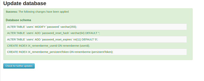

I have applied the database UPdate,… and got this:-
Having applied the database update,.. and I have now rebooted,.. and things seem to be OK for now…
I will monitor to see how things go.

The emonhub error with the RFM69 connectivity issue is interesting, let me know if that happens again! What emonSD image version are you running? Can you copy the output of the Admin > Info page here

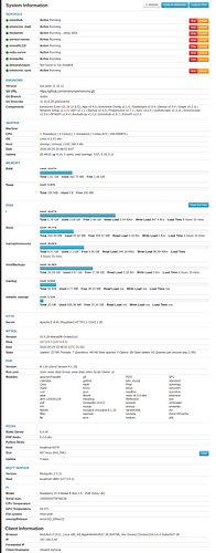

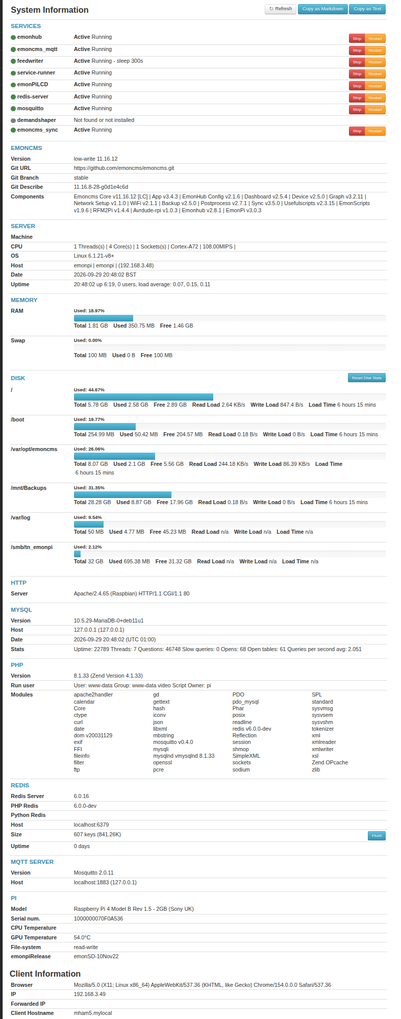

Let me just confirm I am running an EmonPi PV,.. yes an old unit,.. my info page is as follows
Not sure my original image but it was the ‘current one’ at the time… I have not rebuilt the system since.
Ah thanks! that makes sense, no SPI RFM69 on the emonPi v1 for emonhub to connect to and hence the error, you can ignore that or remove the interfacer config for the SPI from emonhub.conf if you prefer. I dont think this is related to the real issue that you have.
Did you say that both the emonPi v1 and emonTx4 data both stop at the same time?
I wonder if it’s an MQTT mosquitto server issue or perhaps a crashing emoncms_mqtt.service.. when this happens does emoncms_mqtt show as stopped?

pi@emonpi:/opt/openenergymonitor/emonhub/conf $
and typical EmonHub output is as follows.
ah sorry that was a red herring, the MQT is in the serial window not the emonhub.log window, from your earlier screenshot.
The emonhub log looks fine.
The emonhub.conf you have shared there is just an example conf file in the emonhub directory. The actual configuration file running on your system can be found at:
cat /etc/emonhub/emonhub.conf
Let us know what you see in that one
Since disconnecting it have you had this issue again?
Two other possibilities here:
  • The emonPi v1 power supply may not be sufficient to power all 3 devices: the emonPi + emonTx4 + Tasmota, power supply issues have often caused radio issues in the past.
  • It looks like the Tasmota does connect as a serial device and so it may have taken over /dev/ttyUSB0 from the emonTx4 causing the emonTx4 to stop reading. If you have two USB serial devices plugged in they can often swap ports, there is a way to fix the ports by id but it’s perhaps simpler given possible power issues could be to power the tasmota separately.
Thanks for responding Trystan,…
Since disconnecting my Tas device,.. normal service has continued,… However it can take 2 or 3 days before Comms are lost,.. so still sort of early days…
Yes I have been giving this some thought myself how I might best derive a 5volt USB supply for my Tasmota device,…
For now I will leave it disconnected,.. and see how the EmonPi / Tx4 continue perform,…
many Tx
