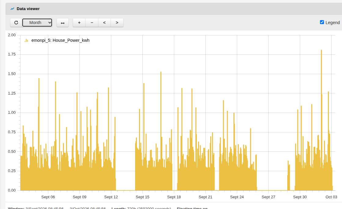

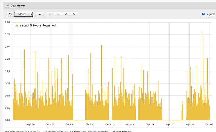

Hi Guys,…sorry the gremlins are back,… feeds from the Tx4 stopped being processed this morning…
My 1st observation is that the failures ‘seems’ to occur on a cycle,… up time seems to be running for about the same, I did the sums on them,… 3 days, & (13hrs, 11hrs, 12hrs, 13hrs)… curious… I don’t know what this means,… or ties into.. but I am not one for coincidences,…

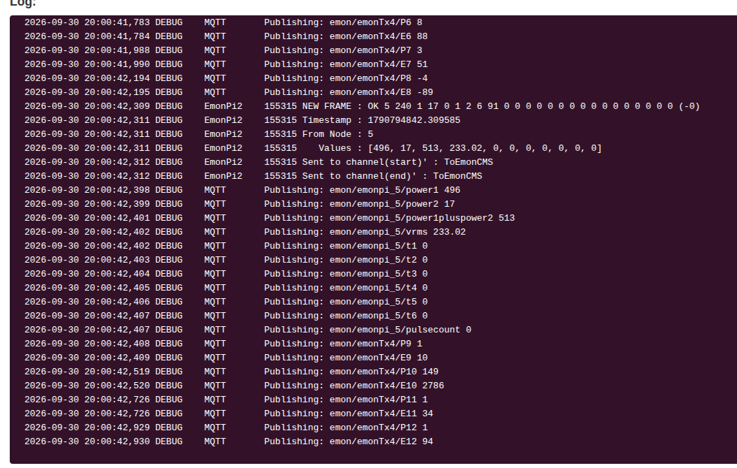

logs for most recent failure,…
I closed the serial config tool,.. s/w reboot from admin,.. and normal service has now resumed..

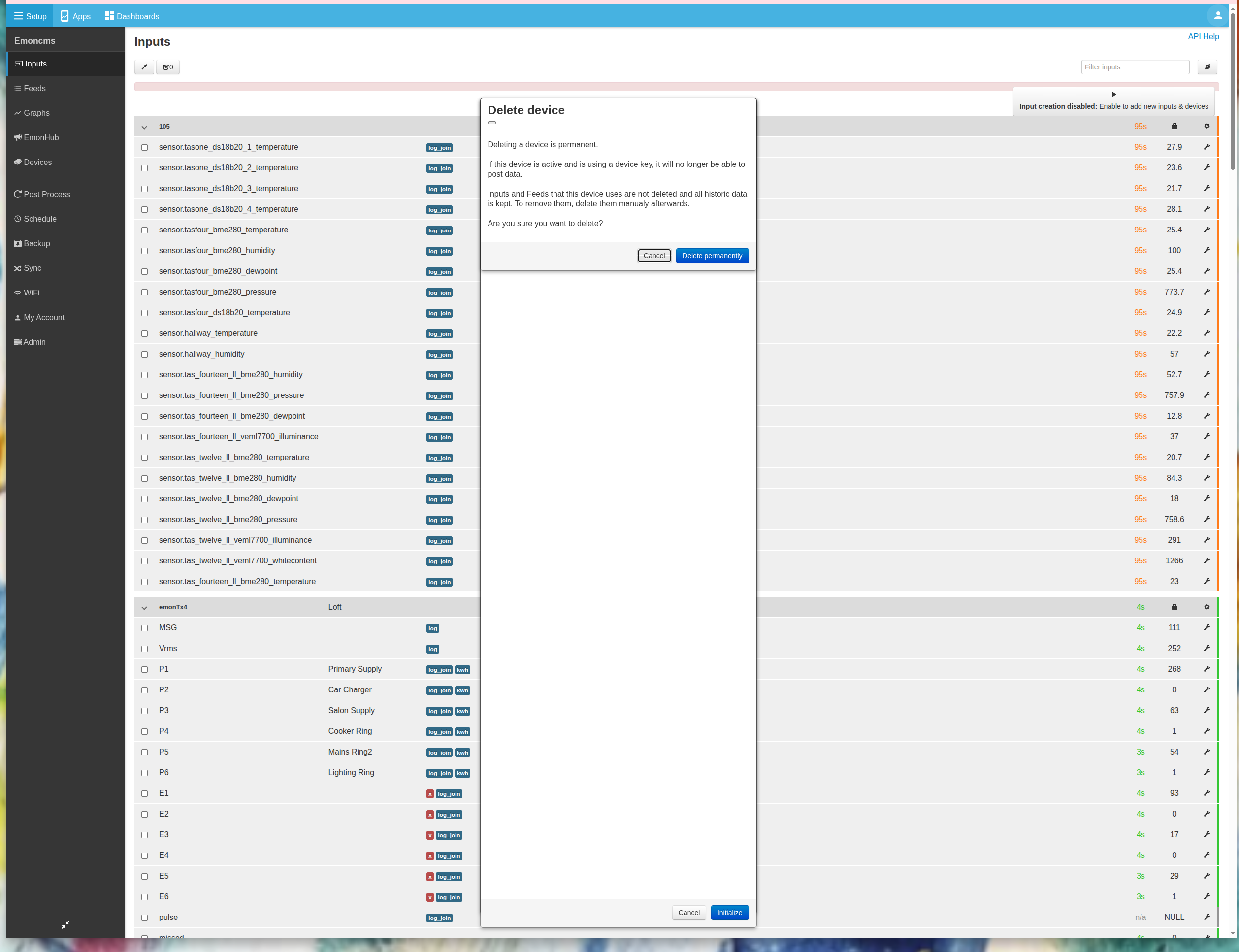

if I go to my 'Inputs screen I am asked to delete a device or not??. as I have not asked to do so I try to select cancel,.. this has no apparent effect,.. did a screen shot,.. but re-sized window and got these additional option including initialise…
I have tried a reboot to no avail… as this menu option pops up after reboot and entering ‘Inputs’ tab/screen…

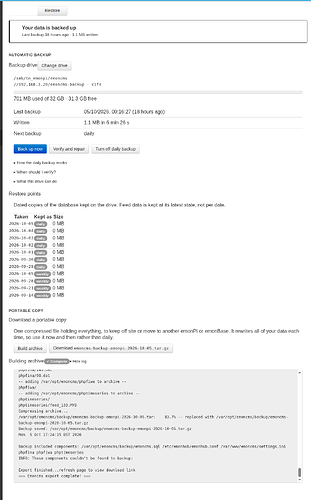

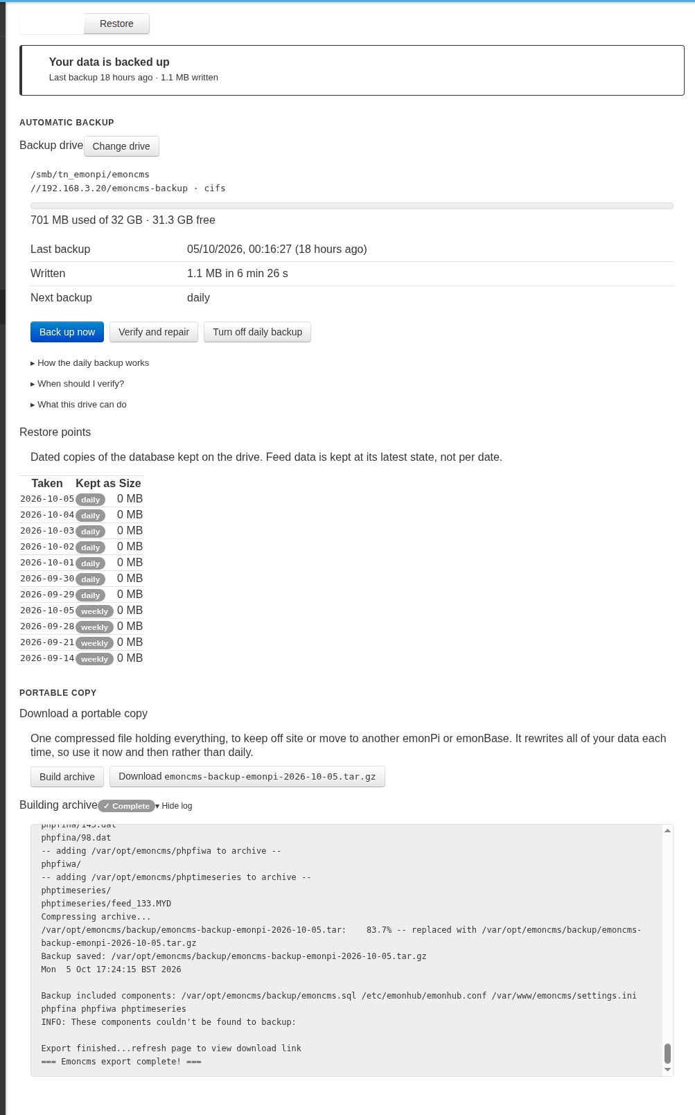

also checked ‘Backup’ menu Tab,… and that appears broken,.. certainly not what is was a few days ago.

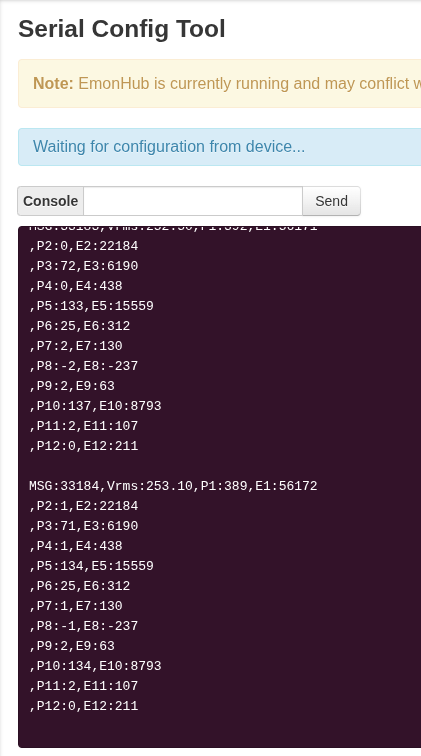

Hello @diyhouse on the visual gremlins, it looks like you may have a partial update there with some modules updated in last few days while core is older.. can you run a full update to bring the latest core in as well, see Emoncms v12 release, no rush to upgrade, testing feedback welcome! check what your components page looks like, check if there are any local changes blocking an update of core or any other module.

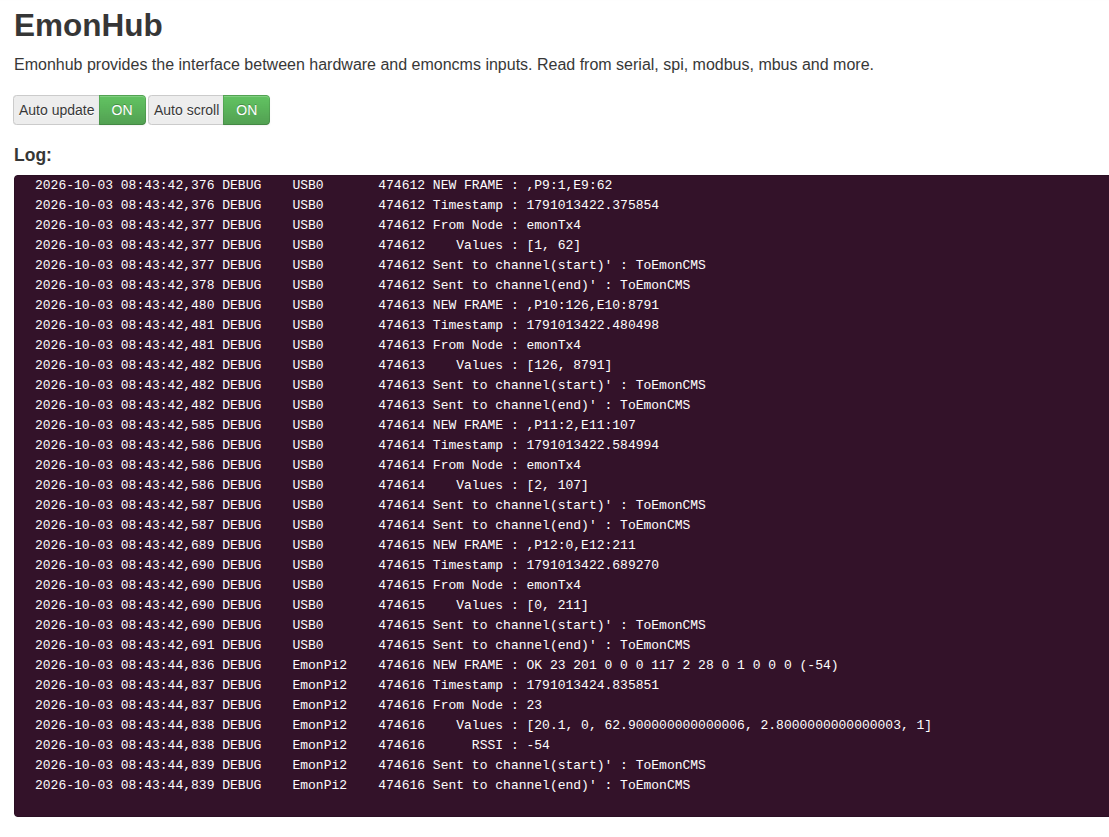

The output here is unusual, the serial data is getting split randomly at different points. Is that stock emonTx4 firmware? Might be worth updating the Tx4 firmware just in case..
We need to right emonhub.conf.

Tx Guys,… just processing your feedback guys,… 1st the easy ones… (note running a 12 CT variant,… The only change I made was to switch the LED on and off whilst data is being transmitted,… a useful health/visual indicator I find), its been running for 2yrs or so I think…

The refreshed Admin pages which had changed, ( considerably,.. like it!! ),… followed by update all,.. and all components have been pulled to latest…
Feed page is now correct,.. no silly artifacts,.. and backup page,.. normal view has returned. ( albeit backup size shows as zero ‘0 MB’ for both daily and weekly backups )

…data stops being processed after 3.5 days again… there is no MQTT data… in the log.
does this mean,.. data is being received,.. but is not being processed by ‘something’ into MQTT data,…
should I force an update of one of the modules..??
Any thoughts… next steps…

and emonHub log..
2026-10-10 08:11:36,305 DEBUG    USB0       488439    Values : [1, 153]
2026-10-10 08:11:36,312 DEBUG    USB0       488439 Sent to channel(start)' : ToEmonCMS
2026-10-10 08:11:36,312 DEBUG    USB0       488439 Sent to channel(end)' : ToEmonCMS
2026-10-10 08:11:37,883 DEBUG    EmonPi2    488440 NEW FRAME : OK 5 194 2 12 0 206 2 145 90 0 0 0 0 0 0 0 0 0 0 0 0 0 0 0 0 (-0)
2026-10-10 08:11:37,885 DEBUG    EmonPi2    488440 Timestamp : 1791616297.883780
2026-10-10 08:11:37,885 DEBUG    EmonPi2    488440 From Node : 5
2026-10-10 08:11:37,886 DEBUG    EmonPi2    488440    Values : [706, 12, 718, 231.85, 0, 0, 0, 0, 0, 0, 0]
2026-10-10 08:11:37,886 DEBUG    EmonPi2    488440 Sent to channel(start)' : ToEmonCMS
2026-10-10 08:11:37,887 DEBUG    EmonPi2    488440 Sent to channel(end)' : ToEmonCMS
2026-10-10 08:11:42,906 DEBUG    EmonPi2    488441 NEW FRAME : OK 5 184 2 12 0 196 2 161 90 0 0 0 0 0 0 0 0 0 0 0 0 0 0 0 0 (-0)
2026-10-10 08:11:42,908 DEBUG    EmonPi2    488441 Timestamp : 1791616302.906543
2026-10-10 08:11:42,908 DEBUG    EmonPi2    488441 From Node : 5
2026-10-10 08:11:42,909 DEBUG    EmonPi2    488441    Values : [696, 12, 708, 232.01, 0, 0, 0, 0, 0, 0, 0]
2026-10-10 08:11:42,909 DEBUG    EmonPi2    488441 Sent to channel(start)' : ToEmonCMS
2026-10-10 08:11:42,909 DEBUG    EmonPi2    488441 Sent to channel(end)' : ToEmonCMS
2026-10-10 08:11:44,941 DEBUG    USB0       488442 NEW FRAME : MSG:34145,Vrms:256.15,P1:520,E1:51611
2026-10-10 08:11:44,942 DEBUG    USB0       488442 Timestamp : 1791616304.941079
2026-10-10 08:11:44,942 DEBUG    USB0       488442 From Node : emonTx4
2026-10-10 08:11:44,942 DEBUG    USB0       488442    Values : [34145, 256.15, 520, 51611, 0, 0.0]
2026-10-10 08:11:44,943 DEBUG    USB0       488442 Sent to channel(start)' : ToEmonCMS
2026-10-10 08:11:44,943 DEBUG    USB0       488442 Sent to channel(end)' : ToEmonCMS
2026-10-10 08:11:45,045 DEBUG    USB0       488443 NEW FRAME : ,P2:0,E2:18899
2026-10-10 08:11:45,046 DEBUG    USB0       488443 Timestamp : 1791616305.045605
2026-10-10 08:11:45,046 DEBUG    USB0       488443 From Node : emonTx4
2026-10-10 08:11:45,047 DEBUG    USB0       488443    Values : [0, 18899]
2026-10-10 08:11:45,047 DEBUG    USB0       488443 Sent to channel(start)' : ToEmonCMS
2026-10-10 08:11:45,047 DEBUG    USB0       488443 Sent to channel(end)' : ToEmonCMS
2026-10-10 08:11:45,149 DEBUG    USB0       488444 NEW FRAME : ,P3:57,E3:6175
2026-10-10 08:11:45,150 DEBUG    USB0       488444 Timestamp : 1791616305.149688
2026-10-10 08:11:45,150 DEBUG    USB0       488444 From Node : emonTx4
2026-10-10 08:11:45,151 DEBUG    USB0       488444    Values : [57, 6175]
2026-10-10 08:11:45,151 DEBUG    USB0       488444 Sent to channel(start)' : ToEmonCMS
2026-10-10 08:11:45,152 DEBUG    USB0       488444 Sent to channel(end)' : ToEmonCMS
2026-10-10 08:11:45,254 DEBUG    USB0       488445 NEW FRAME : ,P4:1,E4:1272
2026-10-10 08:11:45,254 DEBUG    USB0       488445 Timestamp : 1791616305.254005
2026-10-10 08:11:45,255 DEBUG    USB0       488445 From Node : emonTx4
2026-10-10 08:11:45,255 DEBUG    USB0       488445    Values : [1, 1272]
2026-10-10 08:11:45,256 DEBUG    USB0       488445 Sent to channel(start)' : ToEmonCMS
2026-10-10 08:11:45,256 DEBUG    USB0       488445 Sent to channel(end)' : ToEmonCMS
2026-10-10 08:11:45,358 DEBUG    USB0       488446 NEW FRAME : ,P5:271,E5:13399
2026-10-10 08:11:45,359 DEBUG    USB0       488446 Timestamp : 1791616305.358628
2026-10-10 08:11:45,359 DEBUG    USB0       488446 From Node : emonTx4
2026-10-10 08:11:45,360 DEBUG    USB0       488446    Values : [271, 13399]
2026-10-10 08:11:45,360 DEBUG    USB0       488446 Sent to channel(start)' : ToEmonCMS
2026-10-10 08:11:45,361 DEBUG    USB0       488446 Sent to channel(end)' : ToEmonCMS
2026-10-10 08:11:45,463 DEBUG    USB0       488447 NEW FRAME : ,P6:17,E6:76
2026-10-10 08:11:45,463 DEBUG    USB0       488447 Timestamp : 1791616305.462941
2026-10-10 08:11:45,464 DEBUG    USB0       488447 From Node : emonTx4
2026-10-10 08:11:45,464 DEBUG    USB0       488447    Values : [17, 76]
2026-10-10 08:11:45,465 DEBUG    USB0       488447 Sent to channel(start)' : ToEmonCMS
2026-10-10 08:11:45,465 DEBUG    USB0       488447 Sent to channel(end)' : ToEmonCMS
2026-10-10 08:11:45,567 DEBUG    USB0       488448 NEW FRAME : ,P7:1,E7:114
2026-10-10 08:11:45,568 DEBUG    USB0       488448 Timestamp : 1791616305.567282
2026-10-10 08:11:45,568 DEBUG    USB0       488448 From Node : emonTx4
2026-10-10 08:11:45,568 DEBUG    USB0       488448    Values : [1, 114]
2026-10-10 08:11:45,569 DEBUG    USB0       488448 Sent to channel(start)' : ToEmonCMS
2026-10-10 08:11:45,569 DEBUG    USB0       488448 Sent to channel(end)' : ToEmonCMS
2026-10-10 08:11:45,671 DEBUG    USB0       488449 NEW FRAME : ,P8:0,E8:-180
2026-10-10 08:11:45,672 DEBUG    USB0       488449 Timestamp : 1791616305.671492
2026-10-10 08:11:45,672 DEBUG    USB0       488449 From Node : emonTx4
2026-10-10 08:11:45,672 DEBUG    USB0       488449    Values : [0, -180]
2026-10-10 08:11:45,673 DEBUG    USB0       488449 Sent to channel(start)' : ToEmonCMS
2026-10-10 08:11:45,673 DEBUG    USB0       488449 Sent to channel(end)' : ToEmonCMS
2026-10-10 08:11:45,775 DEBUG    USB0       488450 NEW FRAME : ,P9:0,E9:82
2026-10-10 08:11:45,776 DEBUG    USB0       488450 Timestamp : 1791616305.775357
2026-10-10 08:11:45,776 DEBUG    USB0       488450 From Node : emonTx4
2026-10-10 08:11:45,776 DEBUG    USB0       488450    Values : [0, 82]
2026-10-10 08:11:45,777 DEBUG    USB0       488450 Sent to channel(start)' : ToEmonCMS
2026-10-10 08:11:45,777 DEBUG    USB0       488450 Sent to channel(end)' : ToEmonCMS
2026-10-10 08:11:45,880 DEBUG    USB0       488451 NEW FRAME : ,P10:130,E10:8883
2026-10-10 08:11:45,880 DEBUG    USB0       488451 Timestamp : 1791616305.880014
2026-10-10 08:11:45,881 DEBUG    USB0       488451 From Node : emonTx4
2026-10-10 08:11:45,881 DEBUG    USB0       488451    Values : [130, 8883]
2026-10-10 08:11:45,881 DEBUG    USB0       488451 Sent to channel(start)' : ToEmonCMS
2026-10-10 08:11:45,882 DEBUG    USB0       488451 Sent to channel(end)' : ToEmonCMS
2026-10-10 08:11:45,984 DEBUG    USB0       488452 NEW FRAME : ,P11:1,E11:121
2026-10-10 08:11:45,985 DEBUG    USB0       488452 Timestamp : 1791616305.984367
2026-10-10 08:11:45,985 DEBUG    USB0       488452 From Node : emonTx4
2026-10-10 08:11:45,985 DEBUG    USB0       488452    Values : [1, 121]
2026-10-10 08:11:45,986 DEBUG    USB0       488452 Sent to channel(start)' : ToEmonCMS
2026-10-10 08:11:45,986 DEBUG    USB0       488452 Sent to channel(end)' : ToEmonCMS
2026-10-10 08:11:46,089 DEBUG    USB0       488453 NEW FRAME : ,P12:1,E12:153
2026-10-10 08:11:46,089 DEBUG    USB0       488453 Timestamp : 1791616306.088805
2026-10-10 08:11:46,090 DEBUG    USB0       488453 From Node : emonTx4
2026-10-10 08:11:46,090 DEBUG    USB0       488453    Values : [1, 153]
2026-10-10 08:11:46,090 DEBUG    USB0       488453 Sent to channel(start)' : ToEmonCMS
2026-10-10 08:11:46,091 DEBUG    USB0       488453 Sent to channel(end)' : ToEmonCMS
2026-10-10 08:11:47,929 DEBUG    EmonPi2    488454 NEW FRAME : OK 5 179 2 12 0 191 2 171 90 0 0 0 0 0 0 0 0 0 0 0 0 0 0 0 0 (-0)
2026-10-10 08:11:47,931 DEBUG    EmonPi2    488454 Timestamp : 1791616307.929615
2026-10-10 08:11:47,931 DEBUG    EmonPi2    488454 From Node : 5
2026-10-10 08:11:47,932 DEBUG    EmonPi2    488454    Values : [691, 12, 703, 232.11, 0, 0, 0, 0, 0, 0, 0]
2026-10-10 08:11:47,932 DEBUG    EmonPi2    488454 Sent to channel(start)' : ToEmonCMS
2026-10-10 08:11:47,933 DEBUG    EmonPi2    488454 Sent to channel(end)' : ToEmonCMS
2026-10-10 08:11:52,944 DEBUG    EmonPi2    488455 NEW FRAME : OK 5 118 2 11 0 129 2 135 90 0 0 0 0 0 0 0 0 0 0 0 0 0 0 0 0 (-0)
2026-10-10 08:11:52,945 DEBUG    EmonPi2    488455 Timestamp : 1791616312.944657
2026-10-10 08:11:52,945 DEBUG    EmonPi2    488455 From Node : 5
2026-10-10 08:11:52,945 DEBUG    EmonPi2    488455    Values : [630, 11, 641, 231.75, 0, 0, 0, 0, 0, 0, 0]
2026-10-10 08:11:52,945 DEBUG    EmonPi2    488455 Sent to channel(start)' : ToEmonCMS
2026-10-10 08:11:52,945 DEBUG    EmonPi2    488455 Sent to channel(end)' : ToEmonCMS
2026-10-10 08:11:54,716 DEBUG    USB0       488456 NEW FRAME : MSG:34146,Vrms:254.00,P1:471,E1:51612
2026-10-10 08:11:54,716 DEBUG    USB0       488456 Timestamp : 1791616314.715772
2026-10-10 08:11:54,717 DEBUG    USB0       488456 From Node : emonTx4
2026-10-10 08:11:54,717 DEBUG    USB0       488456    Values : [34146, 254, 471, 51612, 0, 0.0]
2026-10-10 08:11:54,718 DEBUG    USB0       488456 Sent to channel(start)' : ToEmonCMS
2026-10-10 08:11:54,718 DEBUG    USB0       488456 Sent to channel(end)' : ToEmonCMS
2026-10-10 08:11:54,820 DEBUG    USB0       488457 NEW FRAME : ,P2:0,E2:18899
2026-10-10 08:11:54,820 DEBUG    USB0       488457 Timestamp : 1791616314.820243
2026-10-10 08:11:54,821 DEBUG    USB0       488457 From Node : emonTx4
2026-10-10 08:11:54,821 DEBUG    USB0       488457    Values : [0, 18899]
2026-10-10 08:11:54,821 DEBUG    USB0       488457 Sent to channel(start)' : ToEmonCMS
2026-10-10 08:11:54,822 DEBUG    USB0       488457 Sent to channel(end)' : ToEmonCMS
2026-10-10 08:11:54,924 DEBUG    USB0       488458 NEW FRAME : ,P3:55,E3:6175
2026-10-10 08:11:54,925 DEBUG    USB0       488458 Timestamp : 1791616314.924490
2026-10-10 08:11:54,925 DEBUG    USB0       488458 From Node : emonTx4
2026-10-10 08:11:54,926 DEBUG    USB0       488458    Values : [55, 6175]
