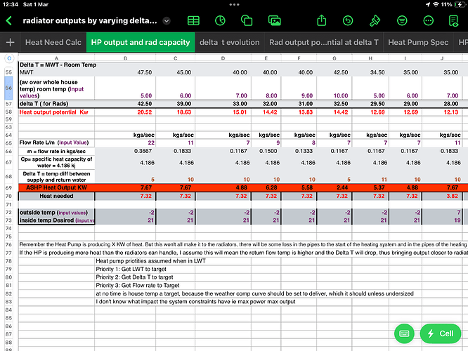

Matt, thanks. As the heat pump is off at the moment apropos the panic, I ‘m going to have a look and see what my settings are, I’m not going to change anything just look. But I’m still not clear about modulation and overshoot. I thought modulation was simply a term to describe the ability of the heat pump to use more or less power, within whatever limitations it has. However people are talking about a setting, which seems to be something other than I thought. Similarly the overshoot. I use offset, have usually got that set at -3, but I believe overshoot is also something else and is one of the settings. Generally I have taken the principal of low and slow and that has largely worked. I think almost by accident I have got the house comfortable with minimum changes. A change to the WDC and then the offset. That I think is the extent of my changes. Since install I’ve got an overall cop of 4.25, not stellar, but it equates to gas costs! Obviously getting the changes done to sort out the conflicts has I think smoothed things, that’s getting rid of the hive, second pump and converting buffer to volumiser. But I’m still looking to tweak things to improve that COP. So maybe narrowing the WDC, along the lines you have done. Though if you’ve done that outside of a WDC I’m still not clear how you’ve done that. I think the delta T standard for rads works pretty well for me and based on other posts you’ve made I’m surprised you are suggesting a dT of 5. I feel anyway that the pump has a little more flexibility with the dT10 and I don’t want to constrain it in that way. In any event it usually is in that territory anyway. But I do admire, envy even , your very consistent numbers, a thing of beauty.
Matt, you set me on this path when previously you told me it was all in the dT, which puzzled me. So I have done the maths, which was where I came up with the anomaly I have since been trying to resolve. Maybe you can help. But first, at 50c dT5, you need a flow rate of 22l/m to get the almost 8kw, 7.67kw to be exact. Similarly, at 40 , but at a DT of 10 you therefore need 11l/m, to get the full 7.67kw. So running in weather dependent mode, with a Target dT of 10 ( which as you said previously is the primary determinant of output, along with the flow rate, LWT doesn’t come into it, but that has a different role to play) you’ll get 4.88kw at 7L/m. And this is where the anomaly appears to arise. Because based on what I have seen on my system, and confirmed by others including yourself, the pumps algorithms prioritise LWT, then they focus on reducing dT to Target, then they are content and bring flow rate down to resting rate, which in my system seems to be 7.1l/m. Now it’s stable and there is nothing to say it needs to do more. EXCEPT if it’s cold you want the full 8kw (7.67kw). However you cannot have it because the flow rate is at 7 and I can’t discover any parameter that is going to shift that. And whilst I may be wrong, if that is so why won’t Daikin answer my question, which I’ve put to them multiple times. Because, I feel, though I don’t know if it’s true, that the only way to get the max out of the Daikin, when it’s cold is to switch over to thermostat control. Because that may trigger the system to up the flow rate. What do you think? Unless of course the formula is wrong!

Matt, maybe my huge radiators are too small. Although the modelling doesn’t show that. Because my system gets to dT 10 very quickly and then drops to 5. And it tends to run between 5 and worst case 3. So if I read your comments correctly you’d say my rads are too small?

Matt, perhaps I am misreading it, I don’t think so , so correct me. I started the heat pump up at 7pm,
At start up the LWT was reading 18c, RWT 18c and flow rate 24.9l/m, 10 minutes in the LWT was at 28c, RWT was at 20c and the flow rate was 15l/m. 20 minutes in The LWT was at 32c, one degree over Target, RWT was 24c and flow rate still 15l/m. 30 minutes in the LWT was at 34c , RWT 26c and flow rate 8.9l/m. At 33 minutes the LWT 34c, RWT 26c and flow rate settled at its usual 7.1l/m.
Now I may be mistaken but I thought delta T, for the heating system, not the radiators, was the difference between the LWT and the RWT. You will notice that during the whole period the dT was within target, never outside. 33 minutes. The dT of 10 is not a target the system is trying to achieve, or at least it never has with my system, it is a target not to be breached. Once under dT, the system doesn’t care. Or again, that’s how it appears with my system. I will say though that we seem to have a different concept of numbers. A large dT or a high one, to me would be 20, a low one 1 , 2,3 or 4, but anything below 10 in my book is low, mathematically low, and below target. So when it started up today, it had to make no effort to keep it within Target. In fact we know that when you have a large dT, say 20, then the flow rate speeds up to bring it down to target. But when it’s already in Target it doesn’t have to do anything. As was the case this evening. Are we on the same page now?
