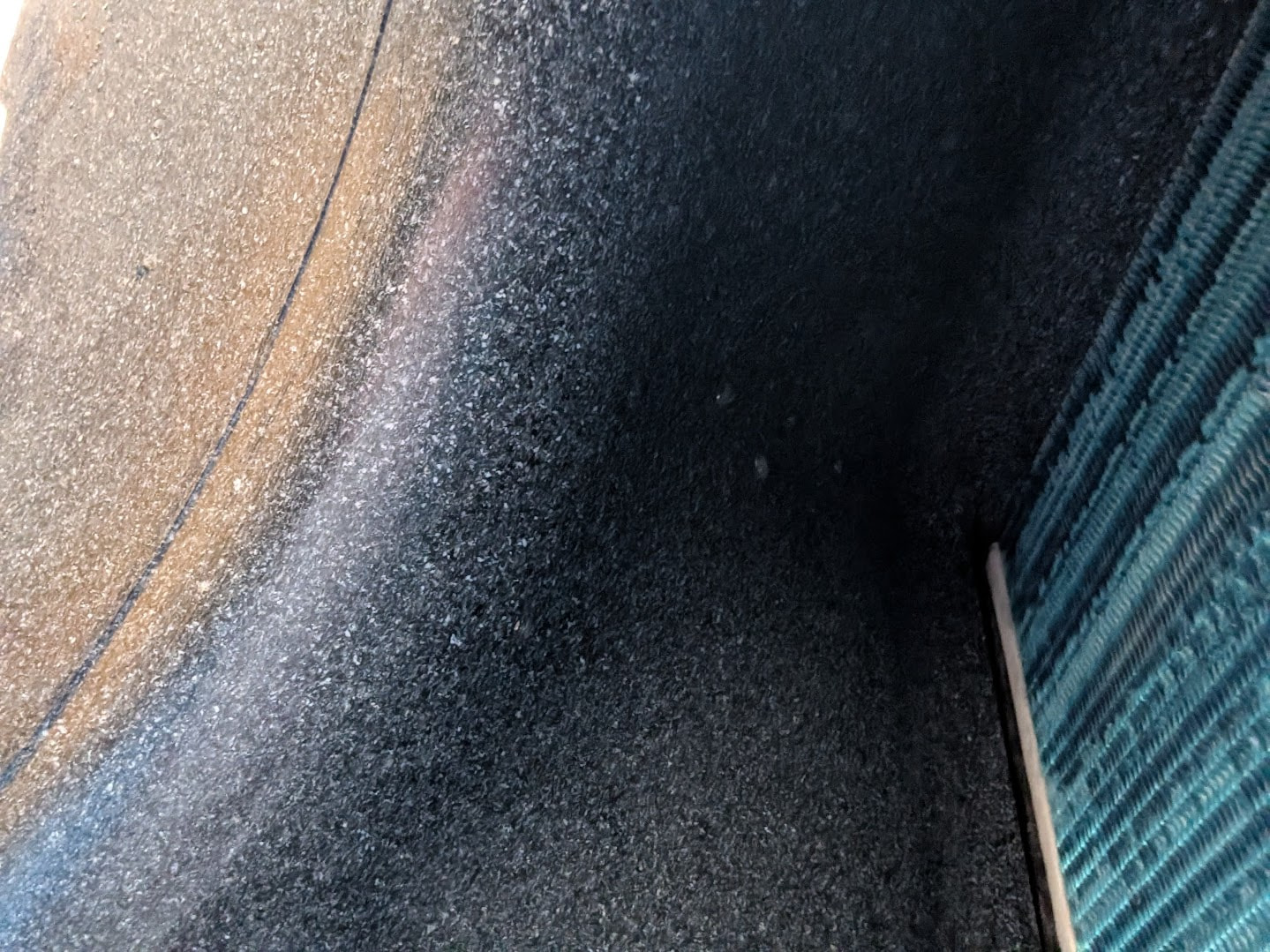

I’m having a real headache with a cosy 12 that was installed on Friday.

I want to get some more evidence that the fan was the cause on my system, so I am waiting to get the fan swapped, which is not super easy to coordinate.
I haven’t bothered to swap it to the sprung legs yet. The noise is still there, but obviously miles better than it was. It will still wake you up on a ramp, but in other modes it’s much better.
Performance and running costs are great, well above SpF 4 and expect that to go up.
I showed the tech on-site the flashing on both case and fan.

Here is the image of flashing.
I’ve still not had the fan swapped, so can’t say definitively what the solve is.
